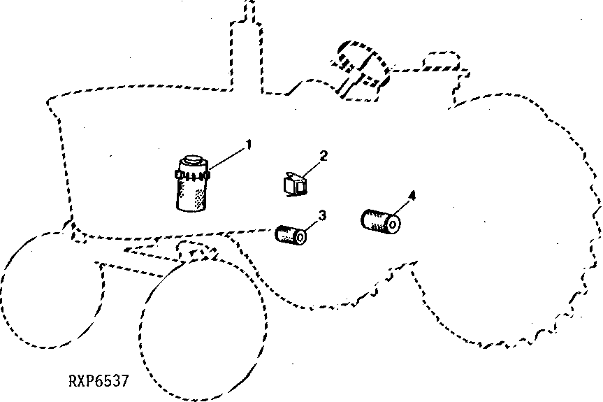

I have recenlty purchased a 3020 gas tractor and i wonder what could be the reason or reasons that the lift arms lever on the dash would bind up and not move at all? And where would the oil, fuel, air, and hyd. filters be on located on the tractor?

Here's the info you requested.
1 AH19848 FILTER ELEMENT 1 GAS & LP AR39798 FILTER ELEMENT 1 DIESEL
2 AR50041 FUEL FILTER 1 DIESEL (ROOSA-MASTER) AR45098 FUEL FILTER 2 DIESEL
3 AR26350 FILTER ELEMENT 1 ENGINE
4 AR75603 FILTER ELEMENT 1 TRANSMISSION
