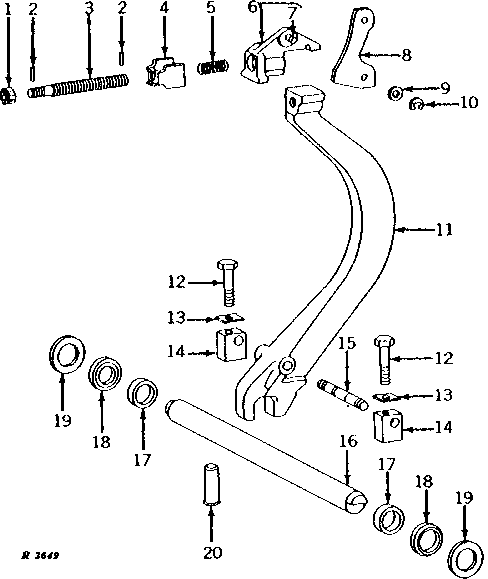

/ John deere 3020 pto problems #14
Are you inquiring as to how to repair the oil leak??
/ John deere 3020 pto problems #16
drain hyd oil,support drawbar frame,put L/D lever in "D",remove caps on both sides of drawbar frame,drive out shaft,lower drawbar frame,remove seals,inspect shaft & bushings for wear,reassemble in reverse putting necessary shims between drawbar frame & trans case.
