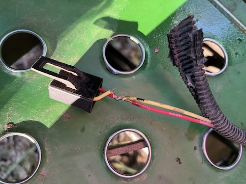

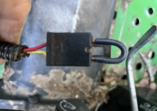

This morning I replaced the jumper wire to the seat switch connector (attached image) and the tractor worked properly - for 10 minutes or so. Then the engine died and it was back to the same problem. So I trimmed the insulation for the wires feeding the seat switch connector and I twisted them together (another attached image). There was no improvement - the tractor starts but cannot engage gear or the PTO.

Since it ran properly for 10 minutes it seems we may be in the right track. I suggest looking at the business end of that connector and seeing if there's a spring and bar in there
