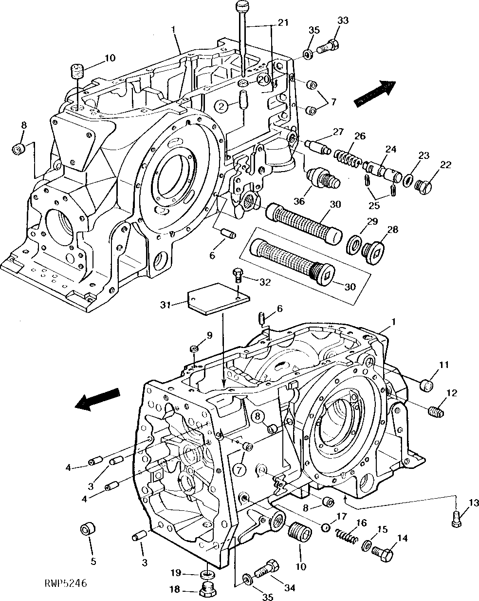

How long since hyd filters were changed and sump screen(parts key 30) checked/cleaned. As the other poster stated JD Hy-Gard oil or it's equivalent. I also recommend checking stand-by pressure which should be 2700 psi according to Tractordata.com
