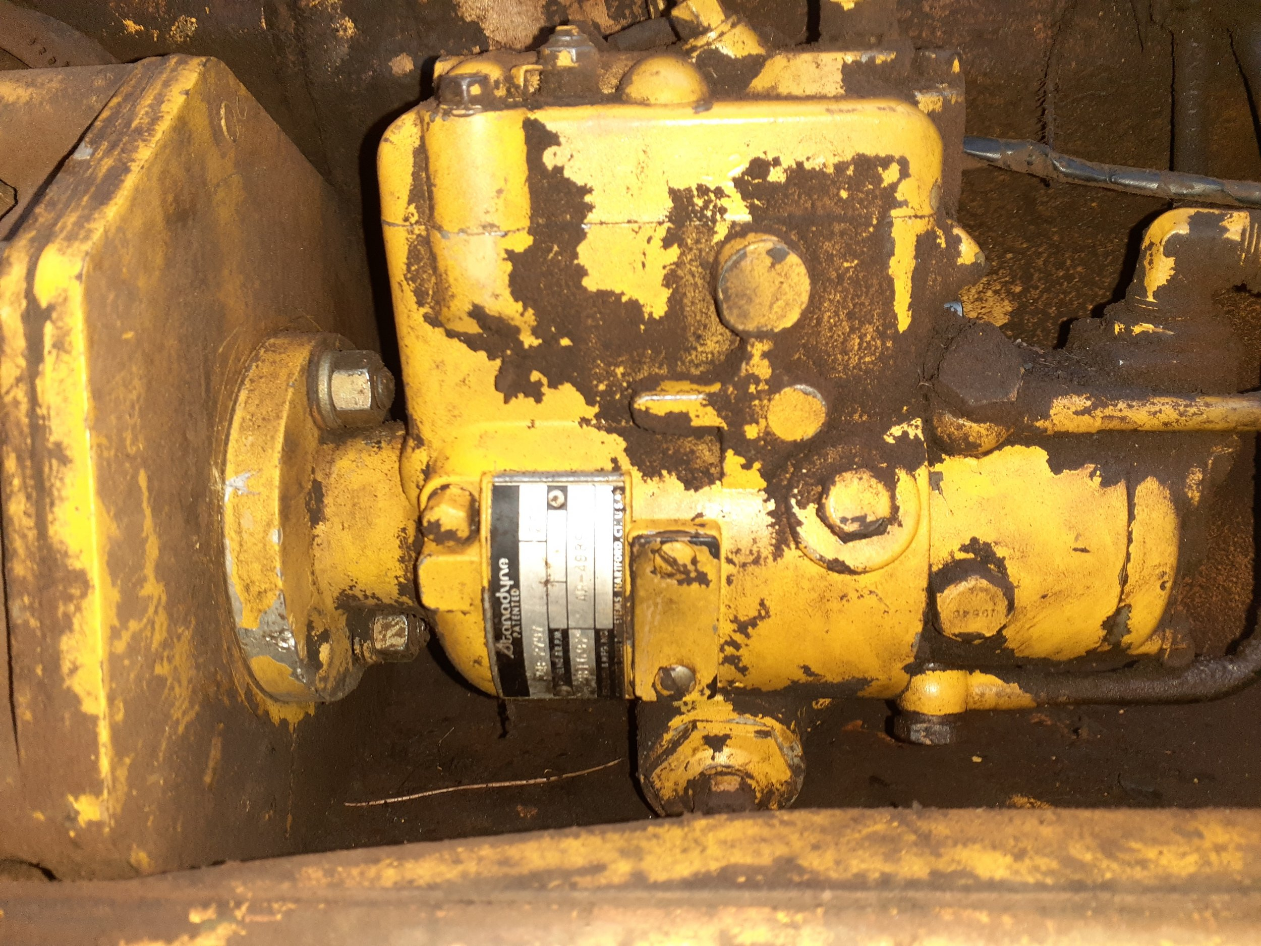

Hi
New to the group Just purchased a 1985 JD 350c hade been setting for a few years and engine was hydrolocked with water, removed the injectors and spun the engine to blow all the water out ,filled cylinders with Marvel Mystery oil ,let set for 3 days and spun the engine to remove the oil, poured seafoam in the cylinders and let set for a couple hours and spun the the engine to blow the seafoam out. Reinstalled the injectors and the engine started right up
Everything checked out ok accept for the engine runs rough between idle and about 2200 rpm then clears up runs great with plenty of power as long as I stay at 2200 rpm
Replaced the injectors and didnt help
Checked the check valve on the return line at the stanadyne injector pump and the ball and spring is missing.
I have pulled the timing cover off the pump to try to identify any parts of the flex plate that may have disintegrated but could not see anything but the governor basket
New filter and fresh fuel also
Any thoughts from you guys? Should I attempt to rebuild the pump myself?

/ John deere 350c running rough #8
The “return connector” hold/creates housing pressure to allow the advance piston to move..
Without the connector u have no advance/timing..
Similar to a distributor in a car..
If u would like to contact me directly, I can give u a quote to rebuild it.. THATS what I do..
Just click on my screen name to send a prvt msg.

/ John deere 350c running rough #10
Bio fuel is A KILLER to ANY diesel fuel system.. if u let your machine sit for even a month u can pretty much write a check for 1000.00 to get your system cleaned..
the return gets clogged from within.. either sludge from bio fuel or the main reason being the “flex ring” is breaking up..
The flex ring is a polymer ring that joins two parts inside the pump.. it gets hard and brittle over time and starts to break up..
The bits look like coffee grounds or mouse turds..
If u run your machine without the connector, the bits are going back to the tank.. but most importantly, once the bits are gone, the two parts start banging into each other and eventually cause the engine to “run-away”..(u can’t control the speed)
It WILL give u signs tho..
The engine will start to surge or the rpm’s will rise on it’s own.. Eventually u won’t be able to lower it..
If u catch it in time.. a pump rebuild is in order..
Most shops won’t tell u but there is a permanent fix for the flex ring problem.. they want u as a permanent customer..cuz the flex ring WILL break up again and again..
