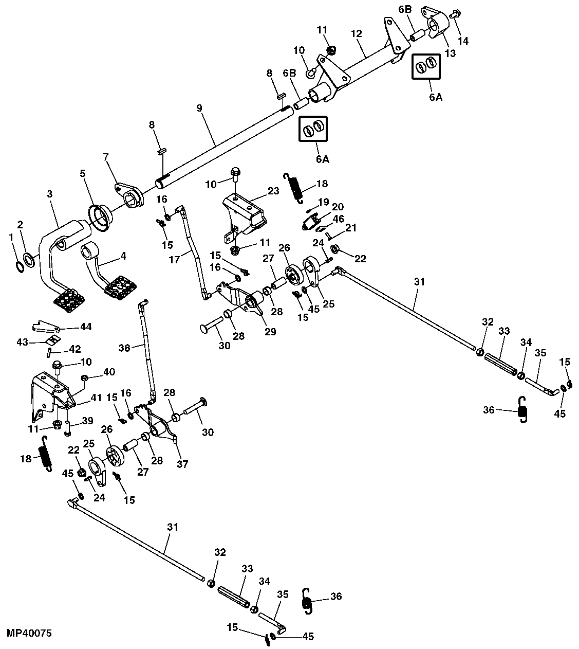

If you have a cab model I'd suggest lubing shaft(parts key #9)
   / John Deere 3720 Brakes hanging up #4
Disconnect rod #35 in the previous posters picture and make sure that it is not the actual internal mechanism that is sticking. Chances are it is the external linkage that is binding. Do both brakes do it independently of each other?
