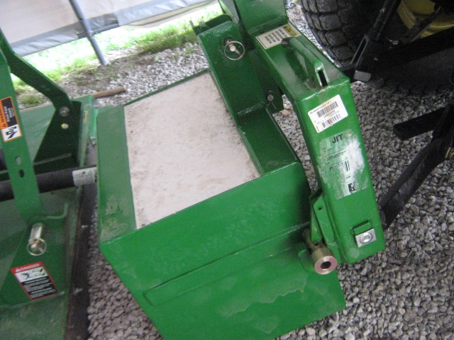

The pins I showed in the pic above were from TSC.
Keep calm, as the iMatch is a tool you won't regret having. Wrestling that ballast box around without the iMatch is just no fun at all. With the iMatch, don't even have to get off the tractor.

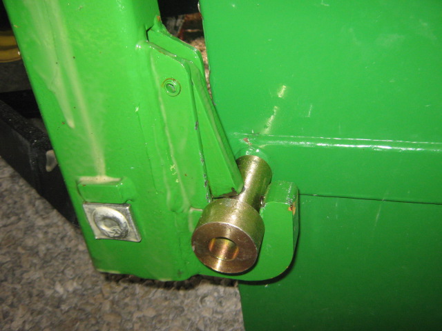

You should get the right stepped-up "bushings", rather than just the filler ones. :)
Here is how they look on the ballast box.

Thanks again to all you guys this forum is priceless for getting help. I went to TSC they had none so I tried princess auto and they had 3 sets the problem was only one set had the roll pins the other two sets were missing the roll pins. I purchased the complete set and brought another set up to the checout. They gave me 30 % off the second set with no pins. I have the ballast box set of correctly now but the problem is I bought a multiset of roll pins but none were big enough for the second set. I will have to check another automotive store maybe and try and find some big enough roll pins for the second set. All in all I am much happier today I just want to be able to switch from the frontier rotary cutter and the ballast box. Once I find the rite roll pins for second set it will be mission accomplished.

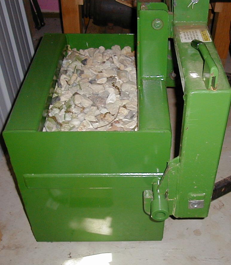

I see a couple of you have an "open" ballast box. What material do you have in them and what does your box by itself weigh "loaded"?

You need the bushings that Beenthere posted a picture of for the ballast box. The bushings you have now are ideal for implements with a clevis hitch. You will need bushings and top pin/bushings for each implement you have. Once you get the implements set up correctly you will be able to hitch up without leaving the seat except for hooking up the pto shaft and raising the parking stands. don't give up yet!:thumbsup: This is a big improvement over the manual hookup.
I put 8 maybe close to 9 bags of quick cement in mine and I am guessing it is about 500 lbs or a little more. I was told that if you fill it with cement over sand it adds an extra 100 lbs to your ballast.
gbo
I just have mine filled with 2" washed gravel. Next time I have a concrete job, I will fill it within 3-4 inches from the top with concrete. I do not know how much it weighs, but know I'd like some more. :)
