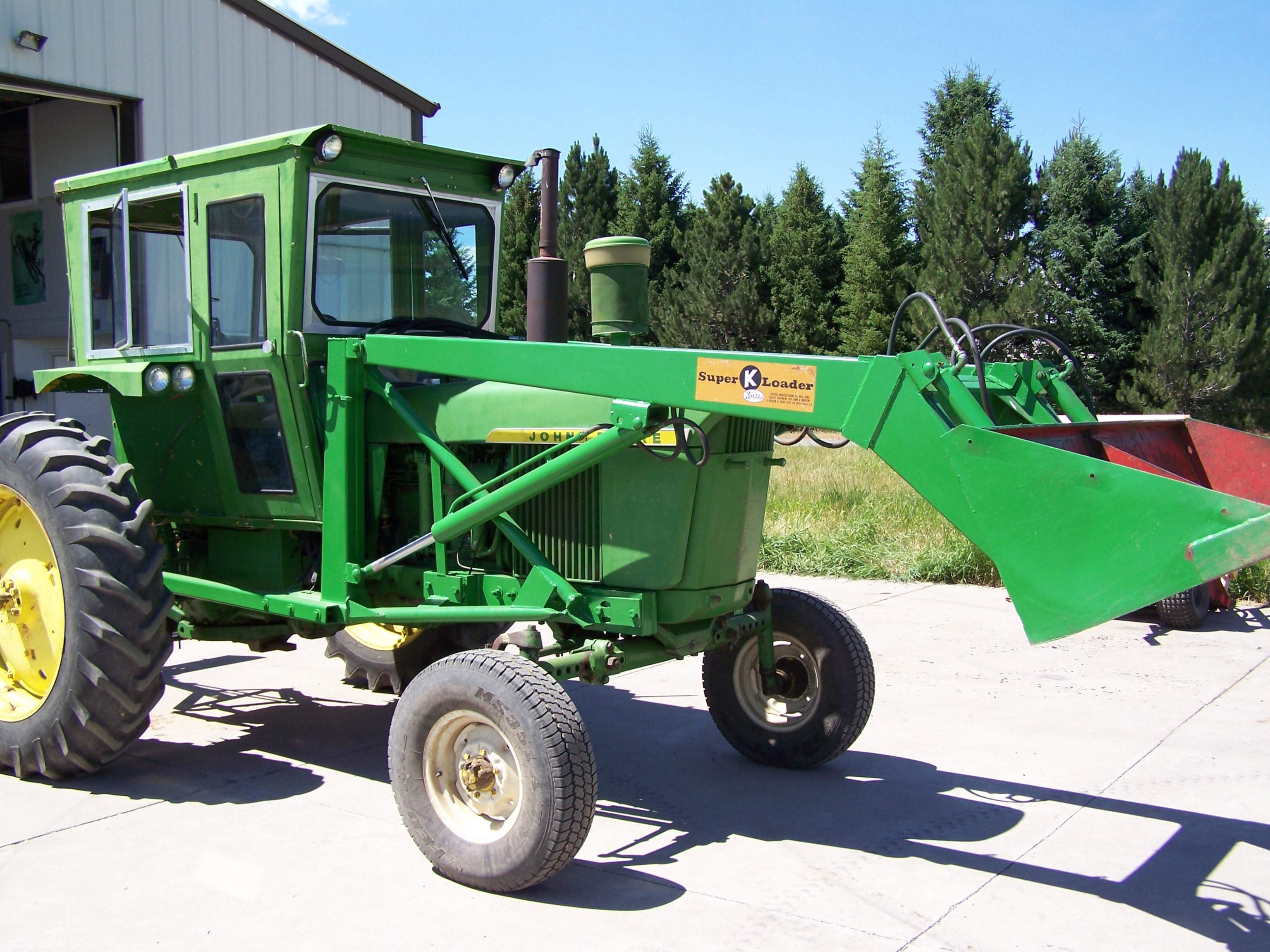

Just because pics are popular....
1967 JD 4010 synchro, I added the Koyker loader with 7' bucket and used it for 2 yrs primarily for snow removal. Awesome tractor, but the synchro with a lot of loader work can tax a clutch REAL FAST so keep that in mind;) The loader not only was mounted to the frame along the engine sides, but also I added 3" square tube all the way back to the rear axle to help relieve some of the stresses on the main frame, mainly when pushing snow, but also put the load in the bucket across the entire length of the tractor. Kinda miss the old girl.... but overkill for my uses now days.
I ran the 30 and 40 series around for yrs growing up on potato farms around here. When my dad stoped farming and, I believe, was a 3020, sold at auction for MORE than my grandad had paid for it over 40 yrs prior, even after all its use. They are a bulletproof proven old tractor for sure!!!!
