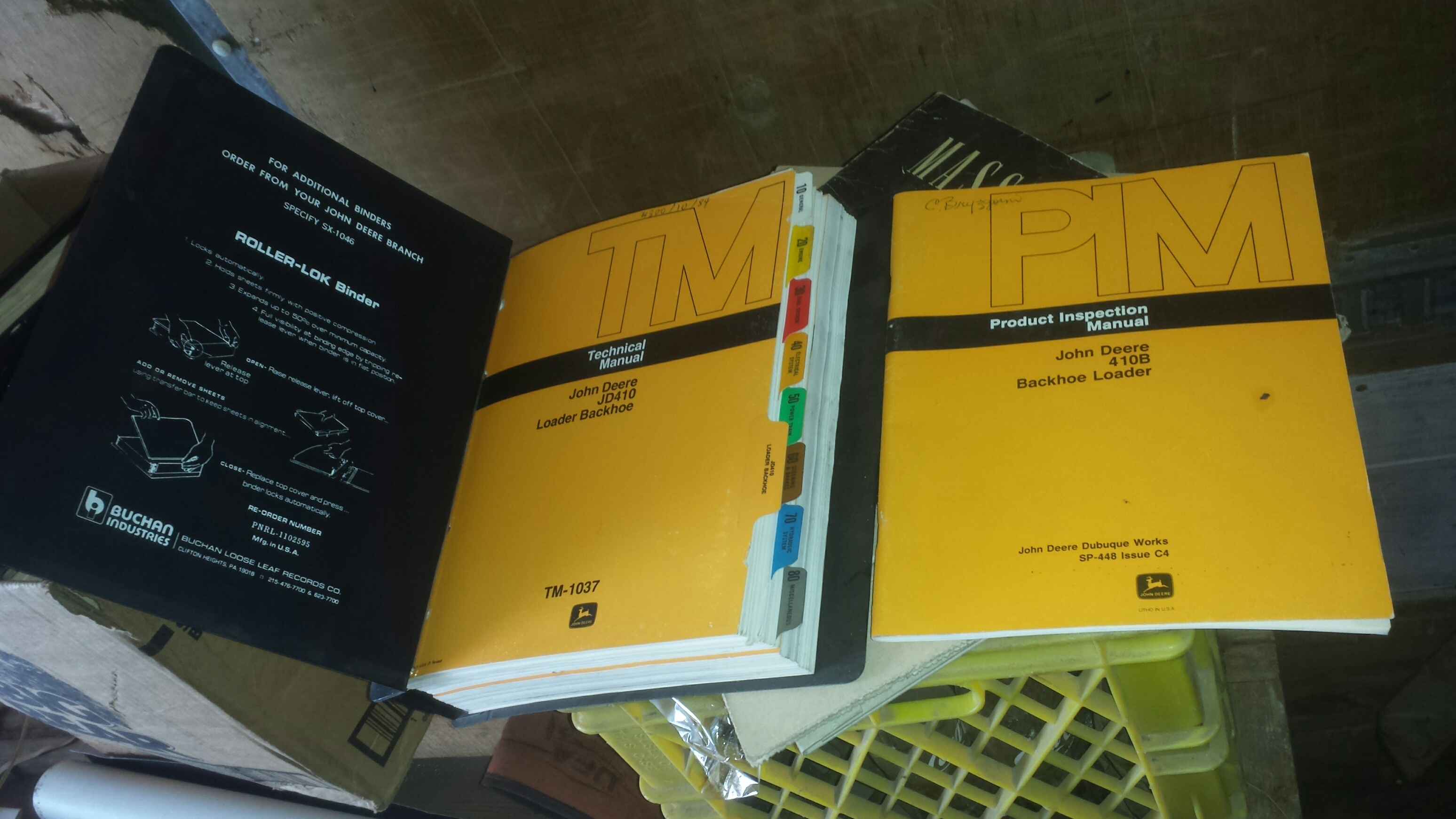

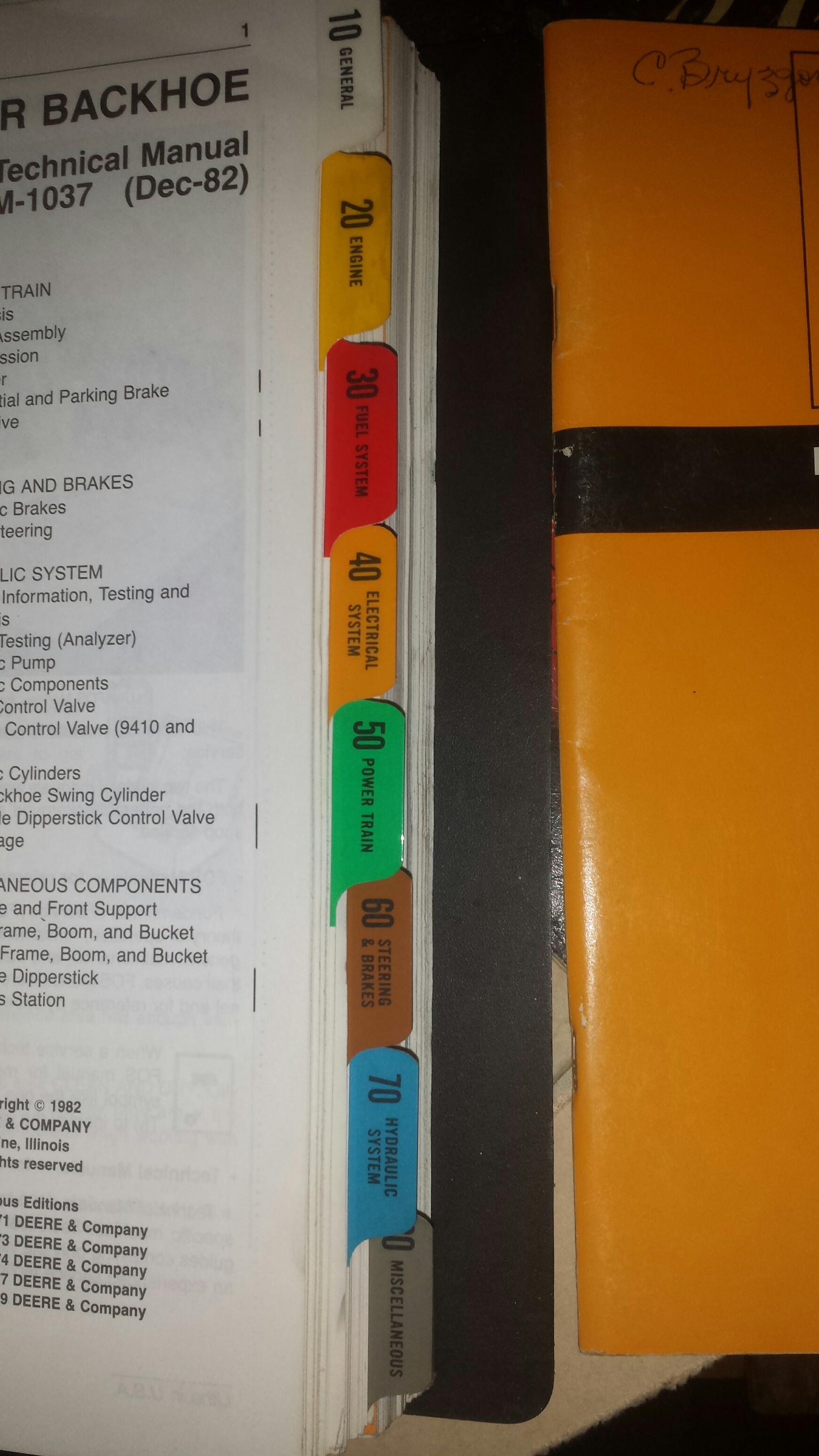

   / John Deere 410 Backhoe Won稚 Move Forward
I have a technical manual coming in the mail and I hope it will show me what I need to know.
