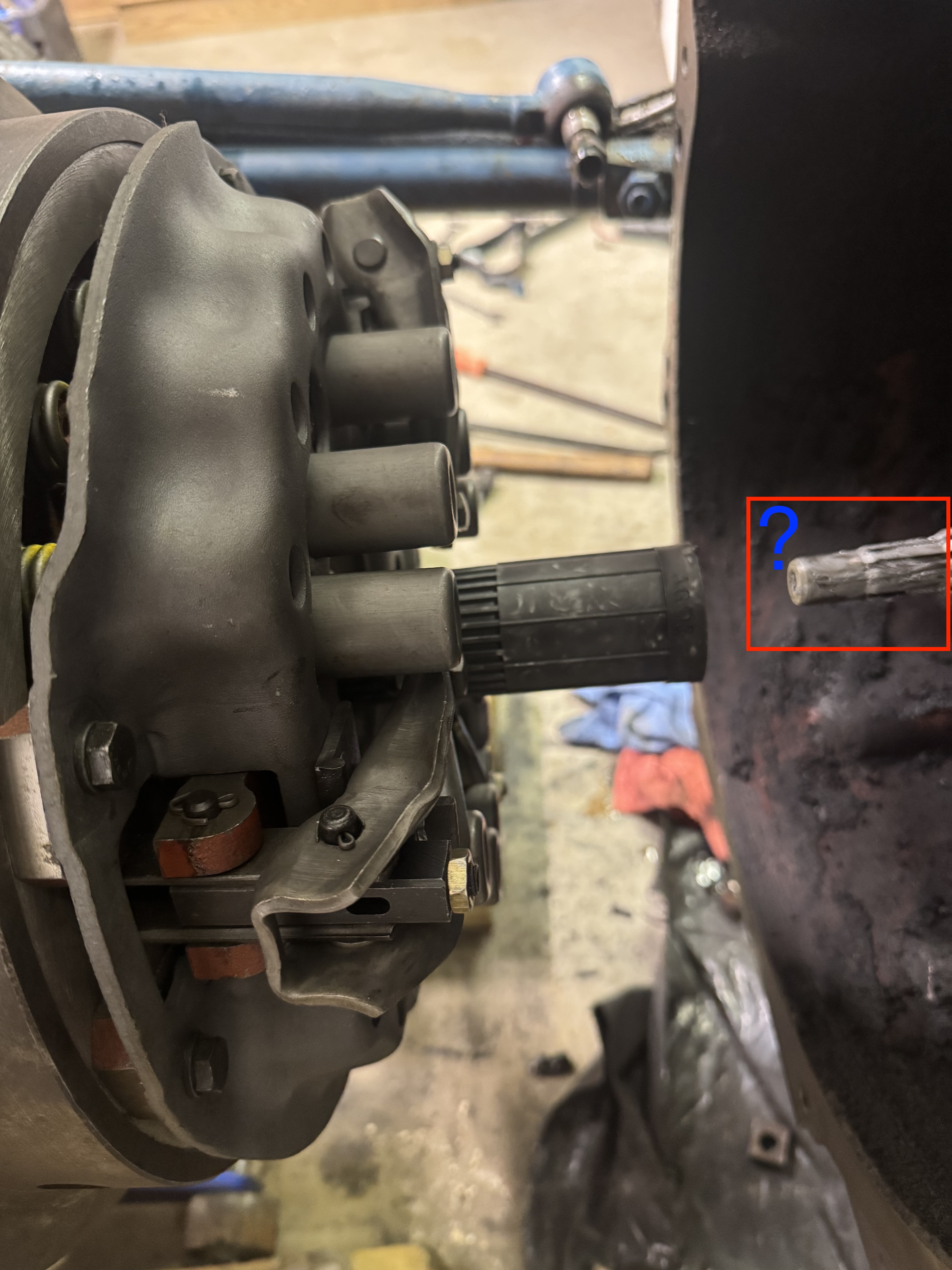

Look at the input shaft splines -like TX Jim posted those look completely stripped off.
Here is a new 3000 8 speed input shaft pic. Shafts and splines do wear had to replace them on my Ford hydraulic pump and the collar as well. Also you can test the input shaft to wheels by turning the input shaft with a chain wrench or slide the old clutch disc on and see that is not positively engaged.
ps. I crushed a pilot bearing once as well by forcing things as a kid on a 1965 GTO. The car still drove but with clutch depressed the input shaft was not being held in true on axis alignment, it also eventually damaged some bearings in the Muncie transmission Take the time to prove the root cause on the power transfer before it goes back together - also turning the crankshaft back and forth a bit and lightly bumping the clutch pedal while getting the pilot shaft to enter the pilot bushing sometimes helps getting the last bit of engine to transmission clearance taken up without forcing things may help.

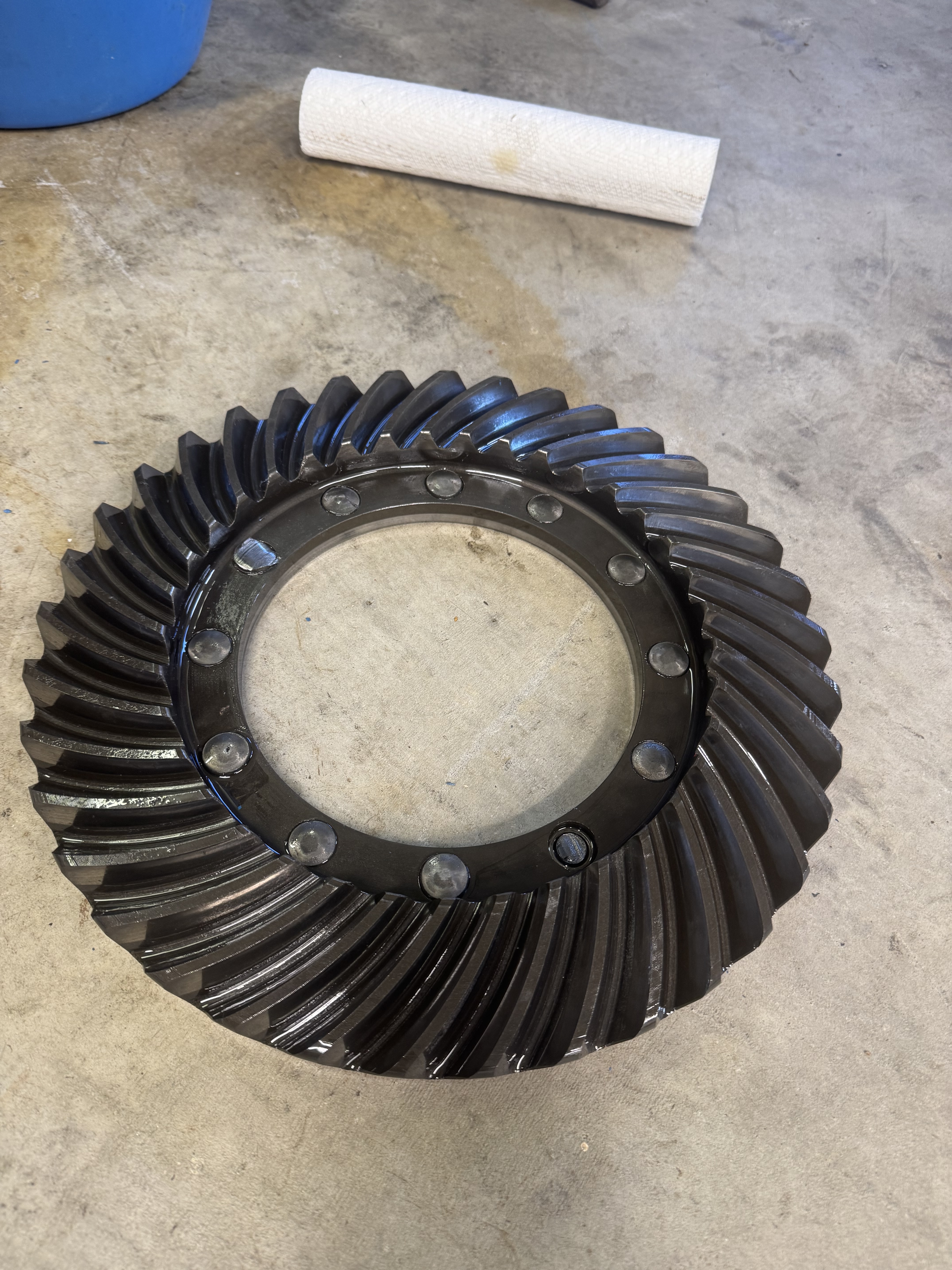

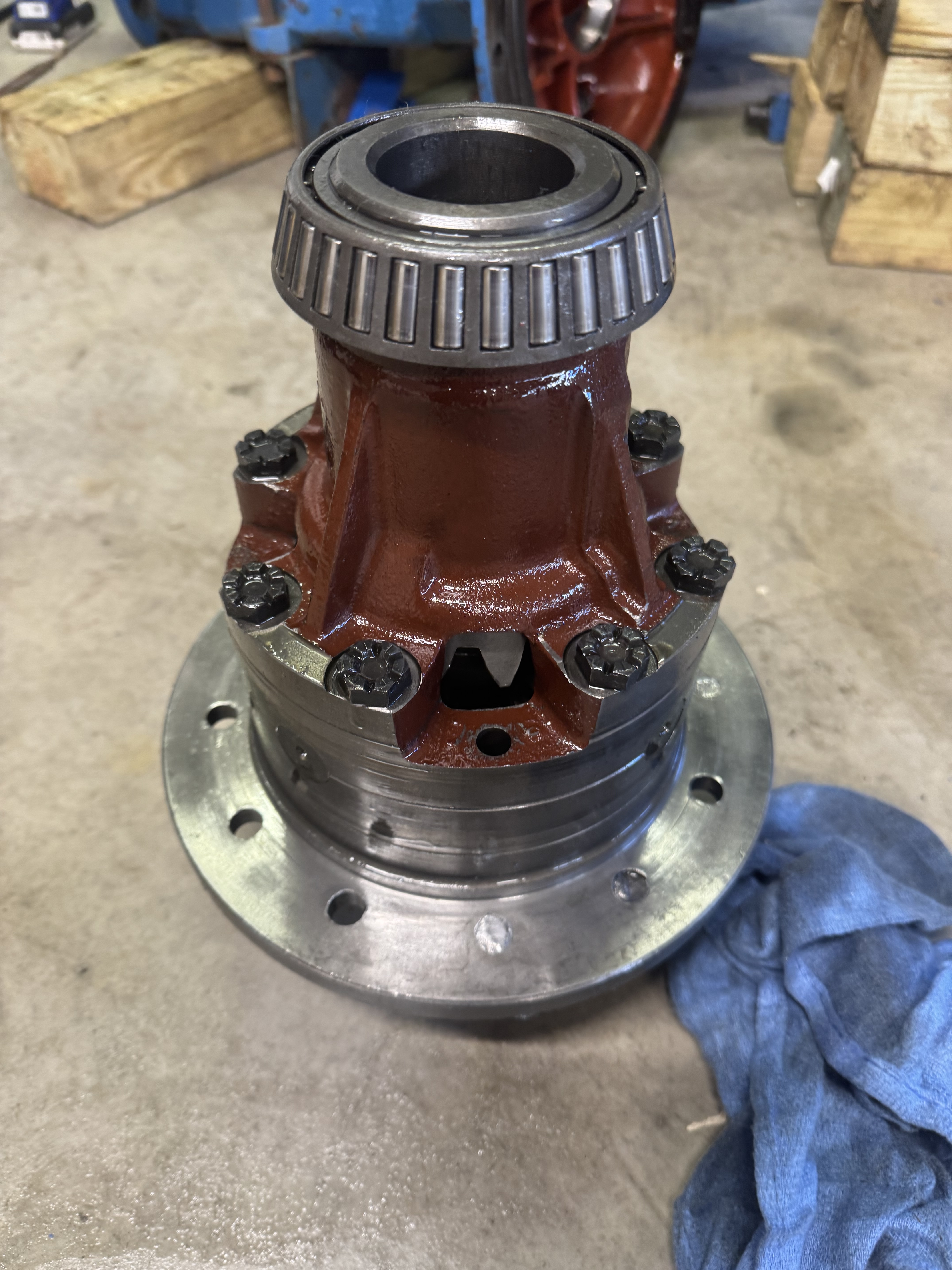

One last question , so turned out it wasn’t the clutch AT ALL , but it’s got a new one now haha it stripped every bolt or stud on the ring gear , have no clue how , but everything else looked great in the rear end , does anyone know what bolt or stud they use to attach the ring gear back onto the differential ? It’s 12 of them

Almost 2 years ago now I was plowing the garden and just one random pass I backed up and then went to go forward again and the tractor hasn’t moved since , no noise no nothing and clutch was pulling good and then just poor nothing , fast forward I split the tractor just got the new clutch in and flywheel resurfaced and the exact same thing ! Still will not move but goes into gear when pressing the clutch in. It feels the exact same as it did so I’m guessing it wasn’t the clutch in the first place , if anybody knows what might be the culprit please help !
Have you checked all the Clutch Linkage? Sounds like a Major Break in the Driveline. Good Luck.
