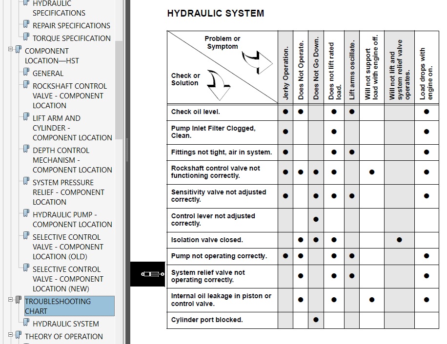

Do you have the service technical manual for the 4100 ? May give you insight on what to check.
Or maybe have to take to a dealer.
Here is the troubleshooting chart for the 4100 from the service tech manual.
