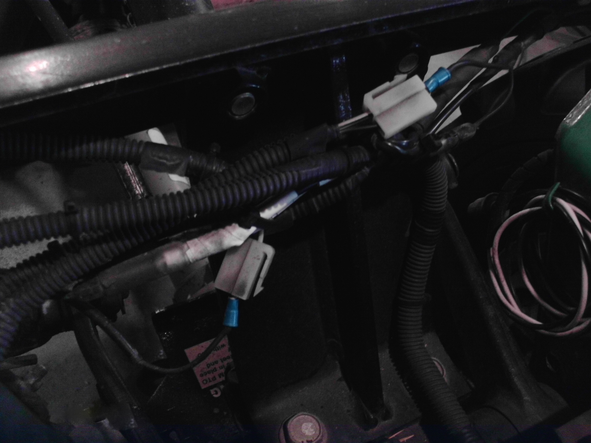

Well my tractor powers up like this...key switch needs to be turned to on position, then light switch is off 2) flashers only 3)work pos. headlight/rearlights 4)road pos. headlights only and flashers. No xtra fuses that I know of. Make sure your add on light wires aren't reversed connected. I've had a few add on lights that the wire colors were not what I THOUGHT they be. In my photo the blue spade connectors are power taps for my worklights and the lights are grounded to the ROPS using the flasher mounting bolts.

DFB: check my original post, I had it wired correctly, I've ran work lights on it for years, but had to replace due to neighborhood brat and a BB Gun.. so when the main lights turned on..so did the work likes on the ropes. the problem arose when the wind blew a good gust..which shook the wires enough that they pulled apart. The secondary line which ran to the ground..caught the hot lead..that's when all the lights dimmed for a nano second..now nothing comes of the hot lead..yet...the 30amp fuse that I am told controls the lights on the fuse rack mounted next to engine on the right firewall is fine. Everything works ( well the glow plug issue still remains from years ago ) but no power to those two hot leads...which makes no sense..if power was lost...and there are no other fuses....then it should have killed the rest of the lights as well
