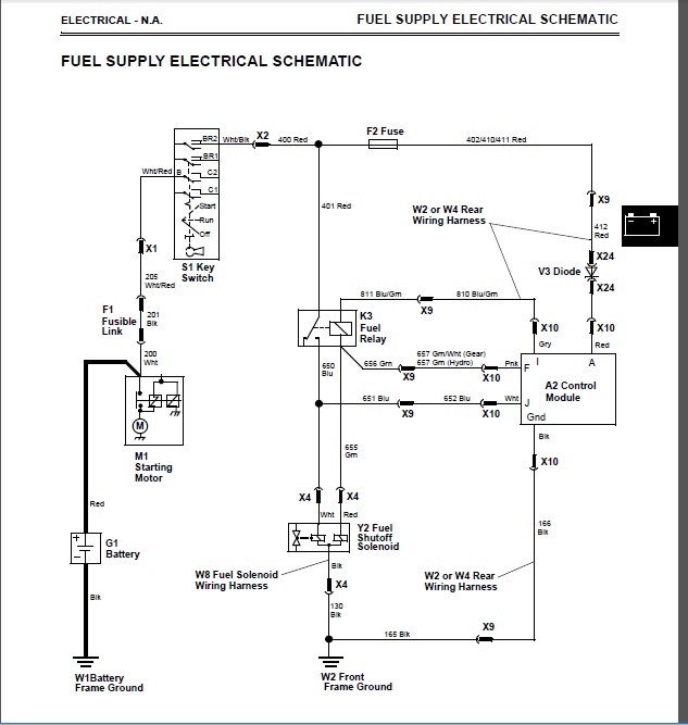

Diode block
is the electronic component that needs to be carefully checked with a multi meter.
This illustration is maybe not for your tractor but will give you an idea on where to look.
This is the test procedure.
Read this description of the 4100 electrical fuel control circuit very carefully.
In the simplified wiring for the fuel control, note that it includes a control module and also a diode.

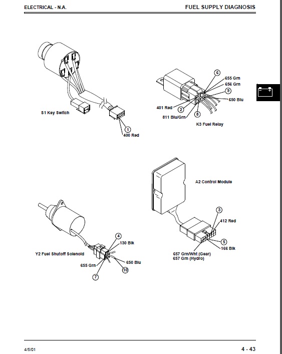

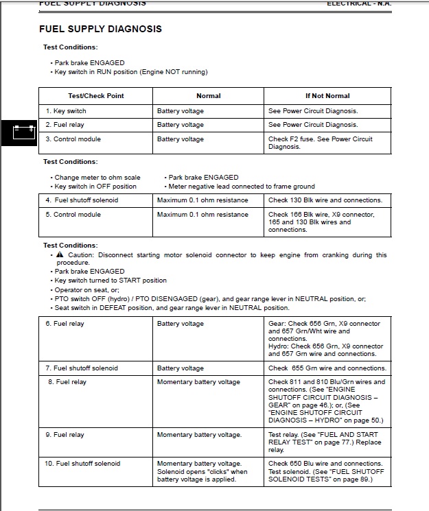

4100 fuel circuit from WSM
