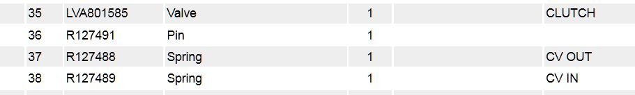

I cant find anything in my 4120 manual about adjusting the clutch.
Some other tractor manufacturers who make hydraulic type clutches also do not specify how to adjust the clutch. Can't imagine why not. But, their service manual does state how to adjust the clutch. The JD shop guys may tell you how to do it.
Most true hyd clutches are controlled by a "hyd valve" so there's no clutch pedal adjustment(free travel) that can be performed. Without the aid of a tech manual I think clutch pedal rod attaches to parts key #52 on a PRT trans which controls clutch valve(parts key #35)

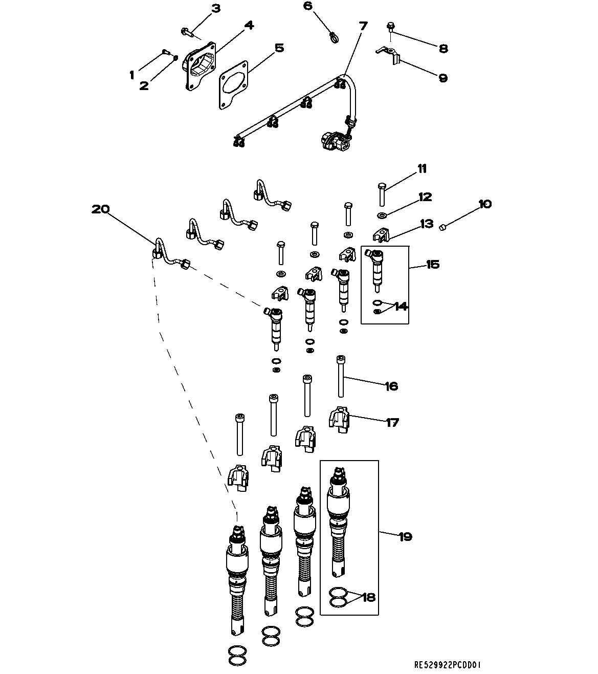

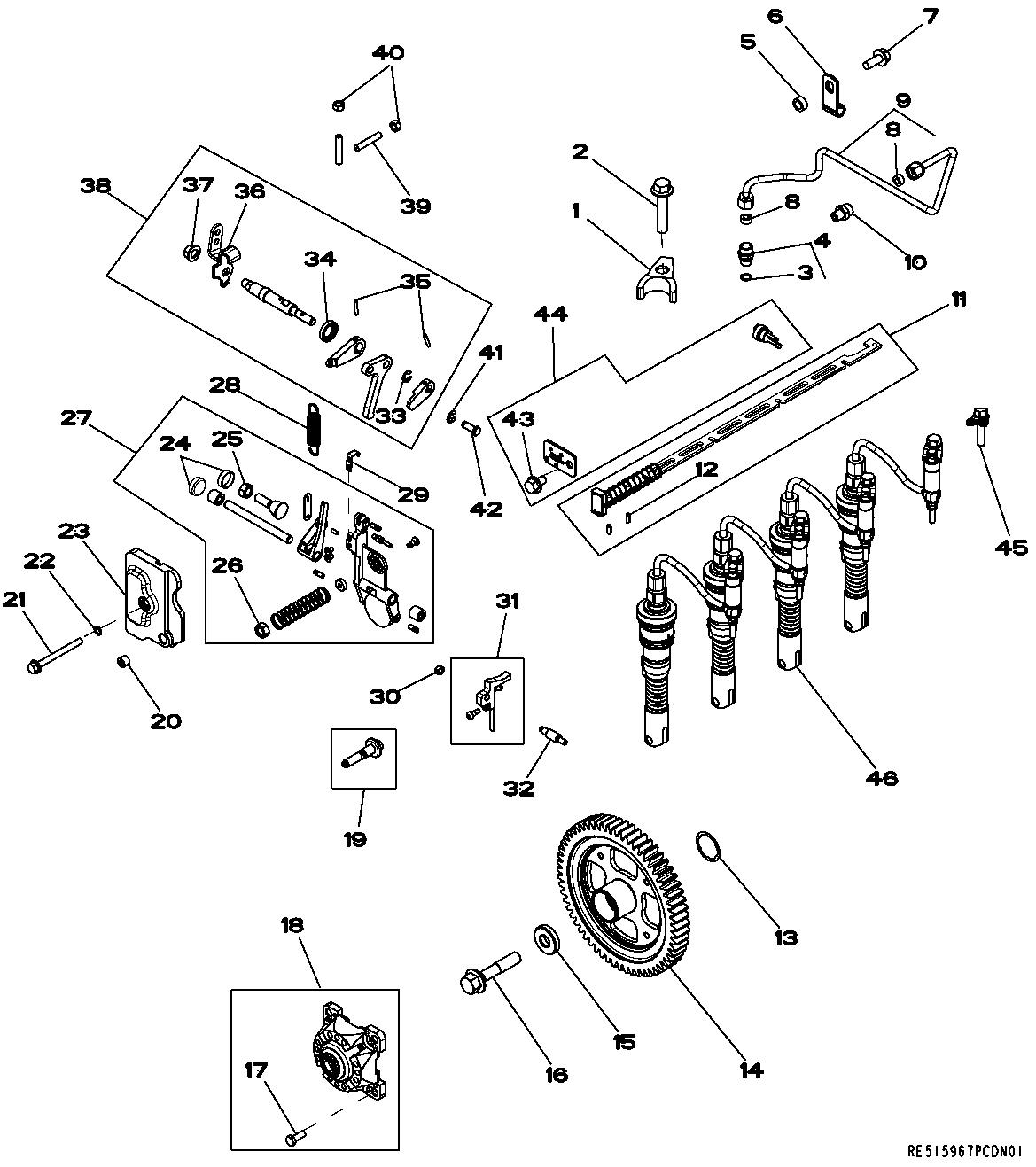

I'm leaning towards the 4120 to get the JD engine. I grew up using a 4020, and really loved to hear that big inline six growl.
All of the specs except HP are the same for this series. Does JD just use more boost, and different injectors?
   / John Deere 4120 Questions #20
Yes, more boost, and the 4520 and 4720 have a totally different injection system than the 4120 and 4320. Both types use unitary injection pumps. So there is a separate pump/injector for each cylinder. The pumps are driven from extra lobes on the camshaft. The 4520 and 4720 have an electronically controlled engine so the injection system is simpler mechanically, and leads to the eThrottle feature which is not available on the 4120 or 4320.
Take a look at the parts breakdown from JD parts, you can see the reduced component count.
The Powetech engine has been a fantastic engine for JD.
