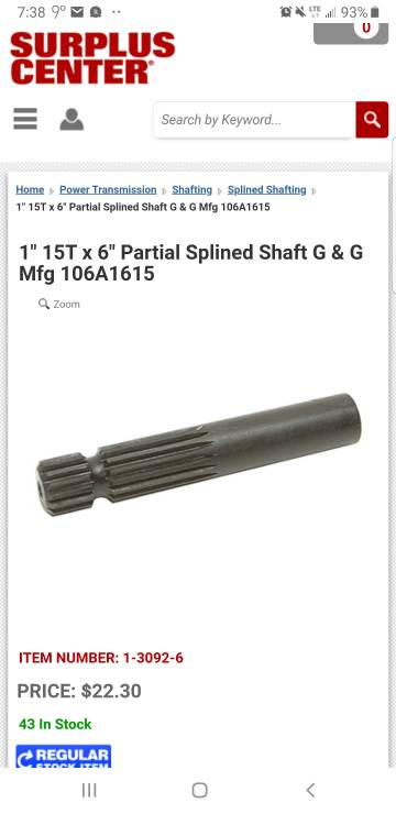

I was wrong it was Surplus Center: 1" 15T x 6" Partial Splined Shaft G & G Mfg 106A1615 | Splined Shafting | Shafting | Power Transmission | www.surpluscenter.com
I do not see a adapter, you might have to make something or make a custom yoke on your shaft to convert if you can not find one.

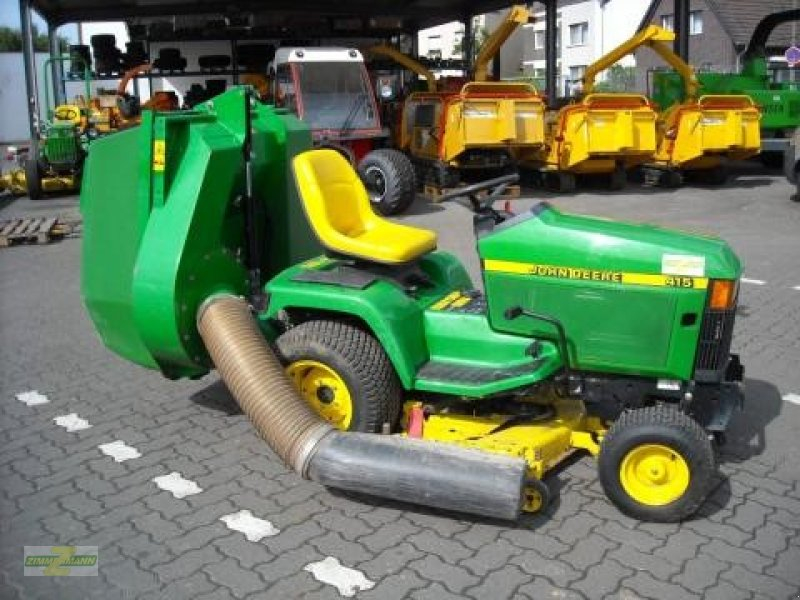

I was an engineer on the 400 series Deere tractors back in the early '90's... completely forgot about the 415! It was an attempt to offer Europe a cost reduced 400 series that also met their demand for collection. It was pretty low volume (400/yr?) so cutting costs from its bigger brother (455) was difficult at best. It had the smaller diesel and a cost reduced K90 variant that did indeed have a 2000 rpm rear PTO output. From memory, the PTO was non-selectable and operated when the mid-pto (mower) operated. Why? Weidenmann rear collection systems were all the rage in Europe at the time and this tractor was designed to be Weidenmann ready. The 2000 rpm pto ran the fan in the collection system.... yes, the machine proved to be way underpowered. Hope this helps!
