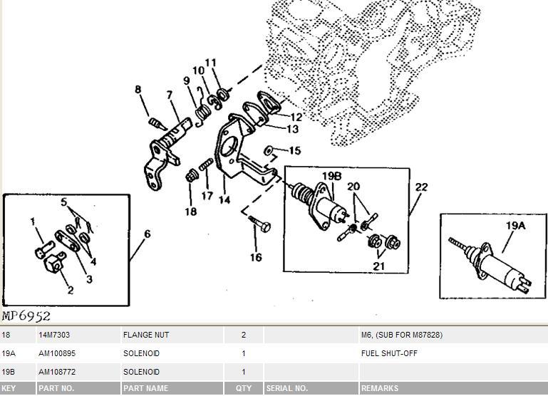

The diesel likely has a fuel shutoff solenoid that caused it to shutdown. Search here for that solenoid and see if you can pick up on what/how you can check it out.

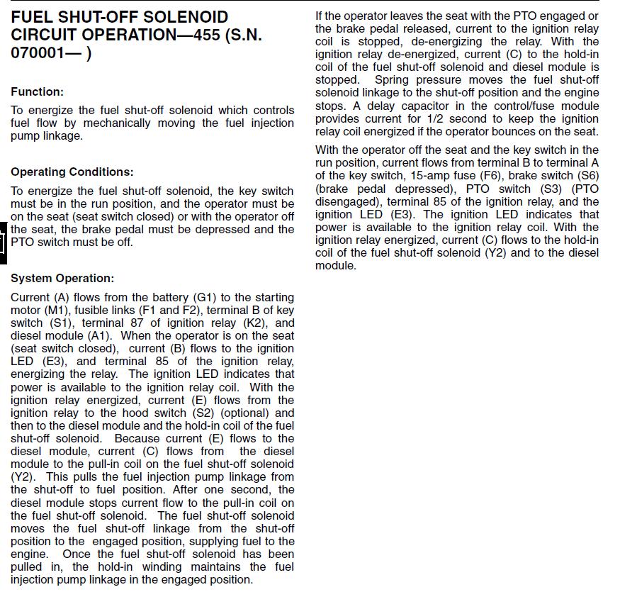

Here are a couple fuel shutoff solenoid copies that may help. One tells about how it works in the system, and the other some checkpoints.

great info guys. I'll poke around tomorrow. Something like a seat safety switch or fuse makes a lot of sense. It would cause it to die while running, and not turn over or make a peep when trying to start. AND...I'm hoping it's that easy!!:D
