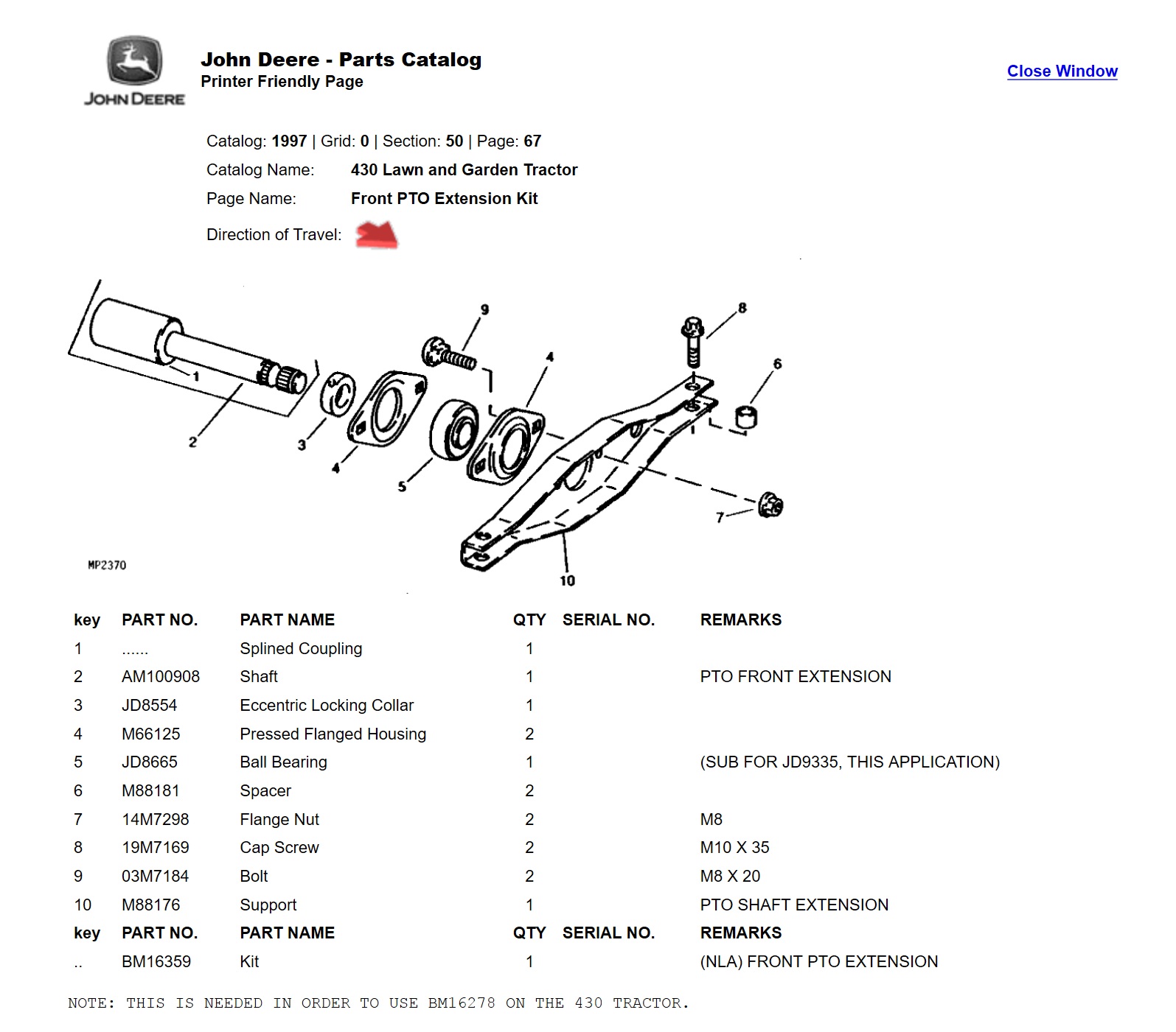

Back to the OP, you can still purchase all the pto extension parts from Deere
For the frame extension you will need to find one used. ebay is usually the best bet.
