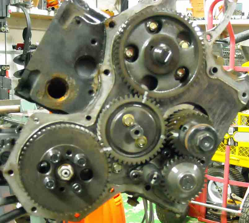

More on taking apart and analyzing my engine:
My first photo is the insides of the front gear case. If you look closely, you
can see white hash marks highlighting the index marks on the gears. These
must be lined up for proper valve and FI timing. The crank has to be rotated
many times before these marks line up since some of the gears have an odd
number of teeth. Correctly assembled, you don't have to adjust the FI timing.

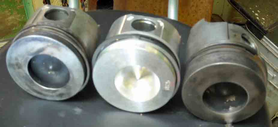

Next are the pistons. This engine is a 1.5-liter direct-injection engine, so
the pistons will look a little different than some other port-injected Diesels.
There are four steel inserts (arrows) in the 4300 pistons, but none in the
earlier 955 piston. The latter engine had a shorter stroke, for a displacement of only about 1.4-liter. The skirts have some funky cutouts in them, too. A
lot of thought must have gone into these piston designs!

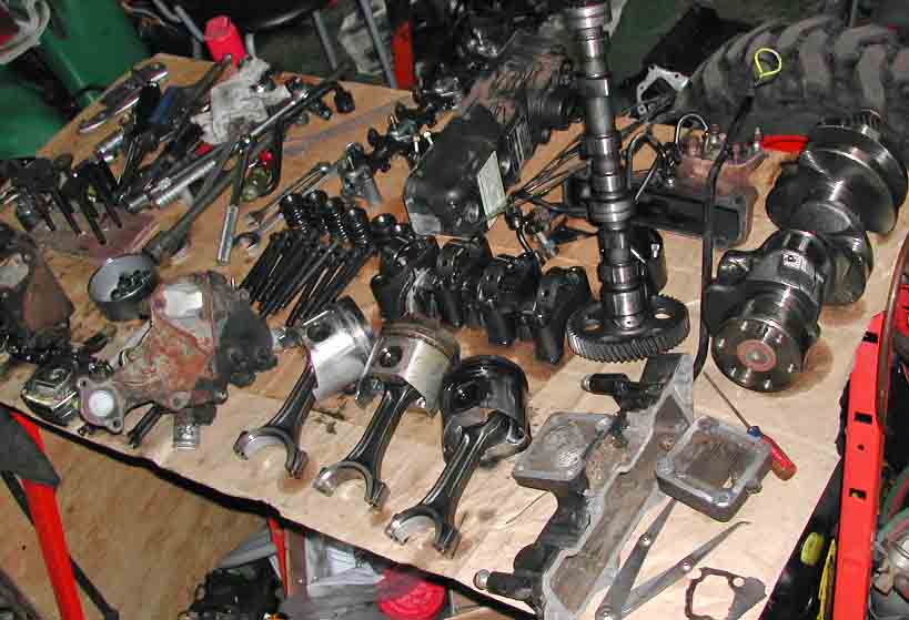

With everything apart (photo 4), it only looks like a mess. Believe-it-or-not,
all the parts are carefully set out to be assembled exactly where they came
from.
