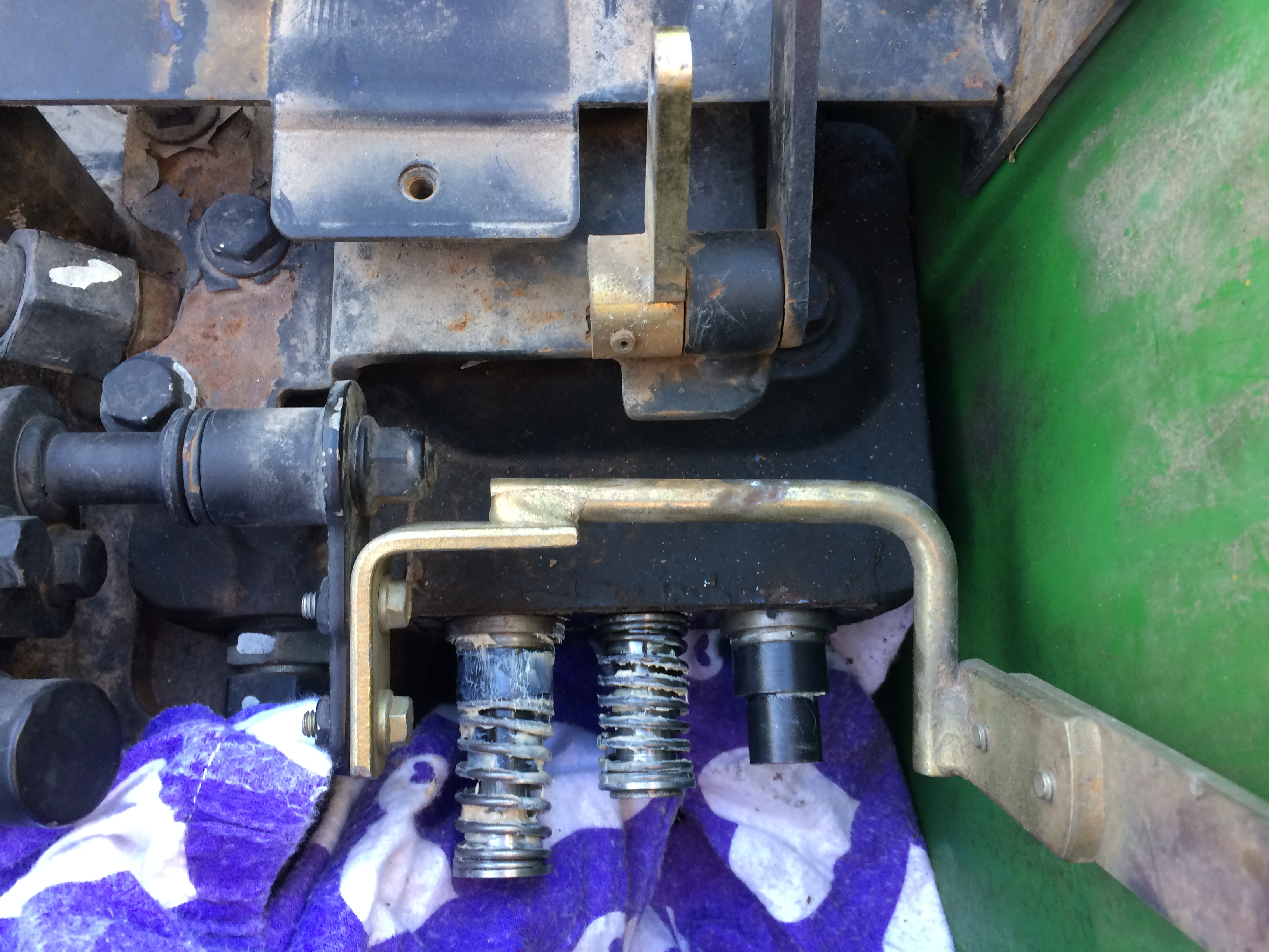

On the end opposite the linkage there should be a cover over the end of the valve spools. Carefully remove this cover. There should be a spring or springs held in place via some method. Could be retaining ring or bolts. Confirm nothing is out of position or binding in this area.
On the lift lower spool there will also be the detent feature for float. I am not sure how this is assembled on your valve so be very careful since there could be some spring loaded pieces under this cover.

Sorry if there was confusion in my posts . Loader was used to clear some ground for a patio and then started acting up . Yes it was a low on fluid and I only put 40 hours on this since purchasing it . Because I never serviced it and had no clue when someone did , I drained fluid , cleaned the suction screen . There wasn't much in the screen . At least I expected it to be more honestly . The backing plate was very brittle but I could not find any of the other pieces in the manifold . So idk where they went . But I kinda ruled out the quick disconnects by replacing male and females . And the pressures just aren't right . No I wanted to triple check myself with the connections bc I know how easily they can be screwed up after swapping . These had the color caps still clearly visible so I have the colors matched from where they were when it probably worked correctly . Weather has been crappy here past few days . I'd like to tear the back cover of the valve assembly off this weekend to see what I can find with it . I can see it barely moves the spool in the loader up and down valve . And feels like it's jamming . So I will post what I find to possibly help someone else if they have this problem . Thankyou again for all the help on here . I very much appreciate it

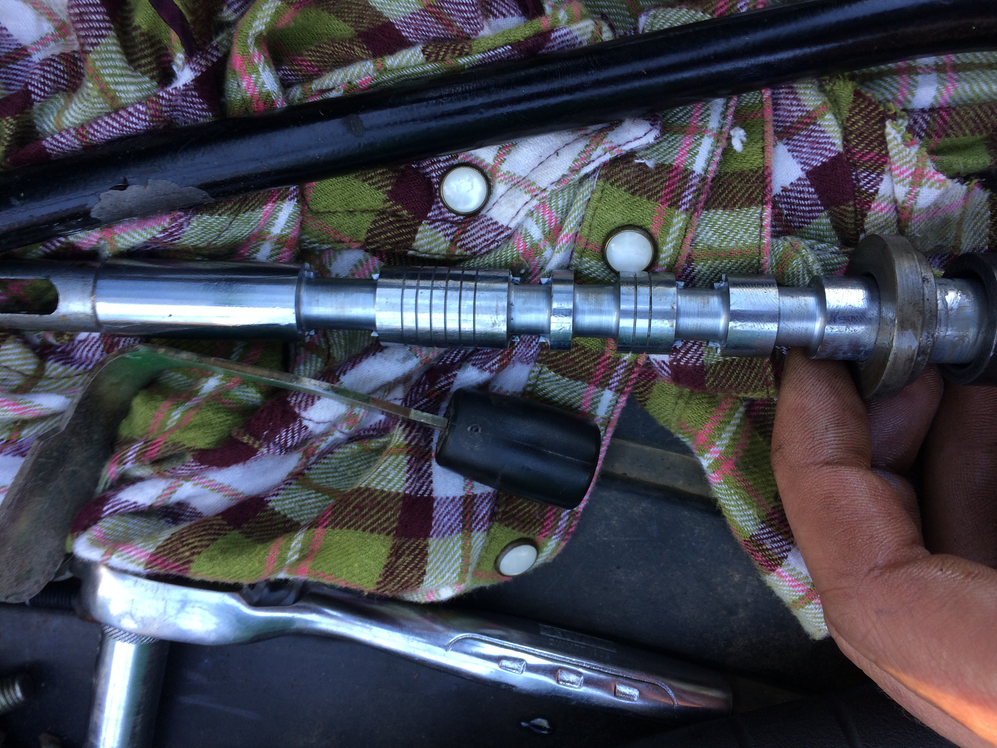

So I know it's been a few weeks but I finally figured it out . I'm attaching images . I removed the PTO linkage that connectors to tractor ( what a pain , ) then got the cover off the rear. I suspected to find a broken spring or something , but nope . All had plenty of lube and looked ok. I removed the spring on the valve giving me issues and I could get the D tent ' cup ' to engage and disengage by hand . And functioning ok . But the valve was so stuck it wouldnt come out more then 1 inch. I broke some rules and got out a punch and hammer . I had to use the hammer to force it out . It was in there to the point I had to hit pretty hard . Finally broke it free . A bunch of Oily crap fell out the back and I couldn't tell exactly what it was bc it fell on the dirty transmission . I seen virtually no scaring on the spool valve once removed . So I checked inner and outer O rings and found no issues . So I just cleaned the valve and everything else the best I could . It went in easier , still a little tight . But I reassembled and thought , screw it . I'll try ... and low and behold it works like new !!! Still a little bit tighter then I would like but it's working flawlessly and goes into d tent just fine now . All loader functions are perfect . Something was blocking it from full movement . I'm just happy the 900$ valve assembly didn't need to get ordered . So now I'm back in business . Thanks for the help and replys on this . I know in the future I might need to replace the whole assembly since I can't get individual parts anymore , but for now it works great

The part that fell out might of came from your load check valve seat. If the load wants to drop when you go up then you well know where to look.
