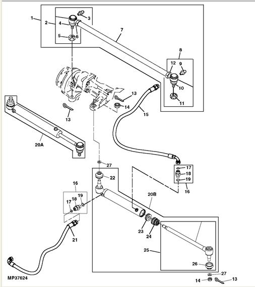

I bent the tye rod and can not get those bolts with the grease fitting on top out that hold the tye rod. If I couls see a drawing of how it goes together maybe I could get it apart.
thanks Jim

You can go to jdparts and with free registration, get access to all the parts and schematics for any Deere
Here is what they show for the 4310 tie rod.

You might find a better illustration on JD Parts website.

You may need a tie rod removal tool to get the tapered tie rod end out/loose after removing the castle nut. At what stage are you now?

I got the nuts off the rods and the big nuts on the tye rod itself are loose.
Whats a rod removal tools look like?
thanks Jim
   / john deere 4310 repair manual #10
A wedgie. Google it and several will come up.
Might thread a nut back on and tap it back out...carefully.
