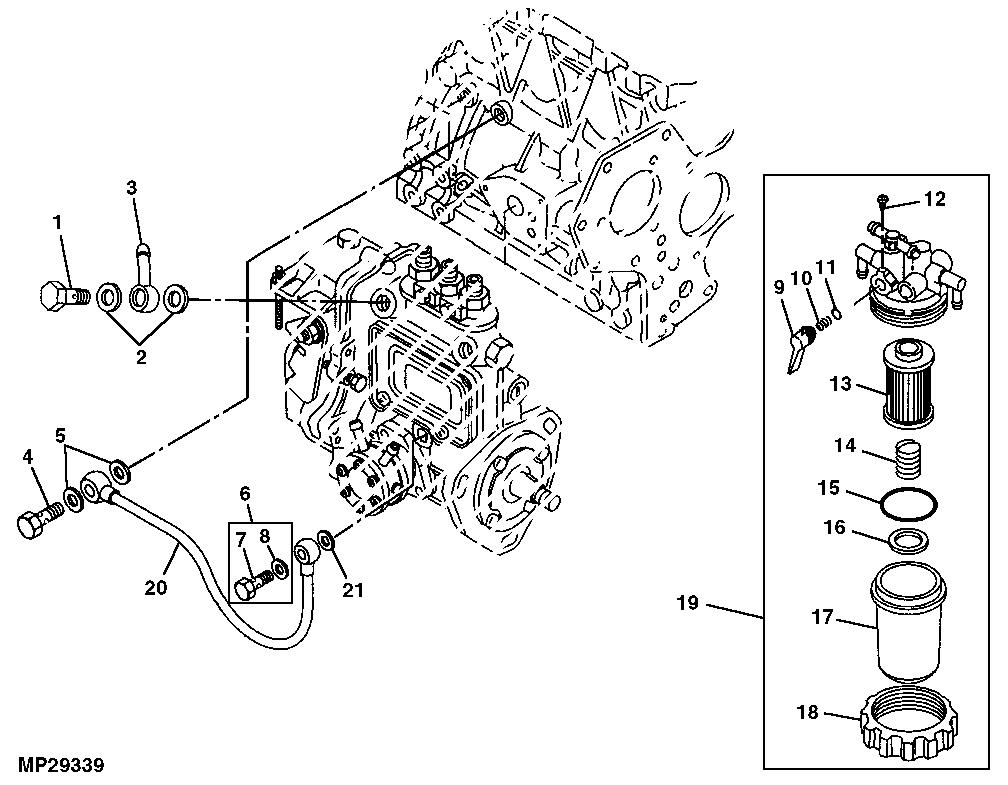

Have you changed the fuel filter? key 13 in the drawing

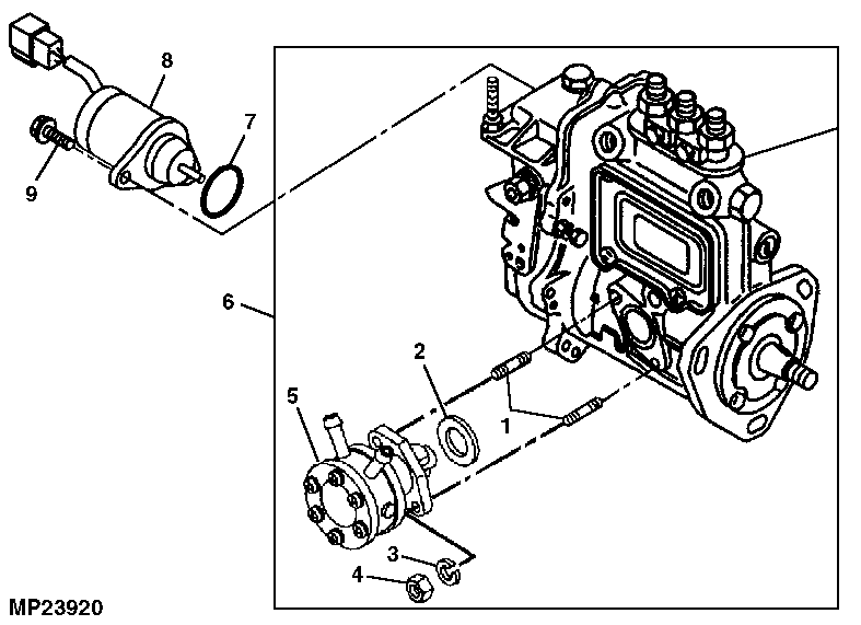

Have you made sure the fuel shut off valve is ON? key 9 in the drawing
Maybe bad fuel pump? Key 5

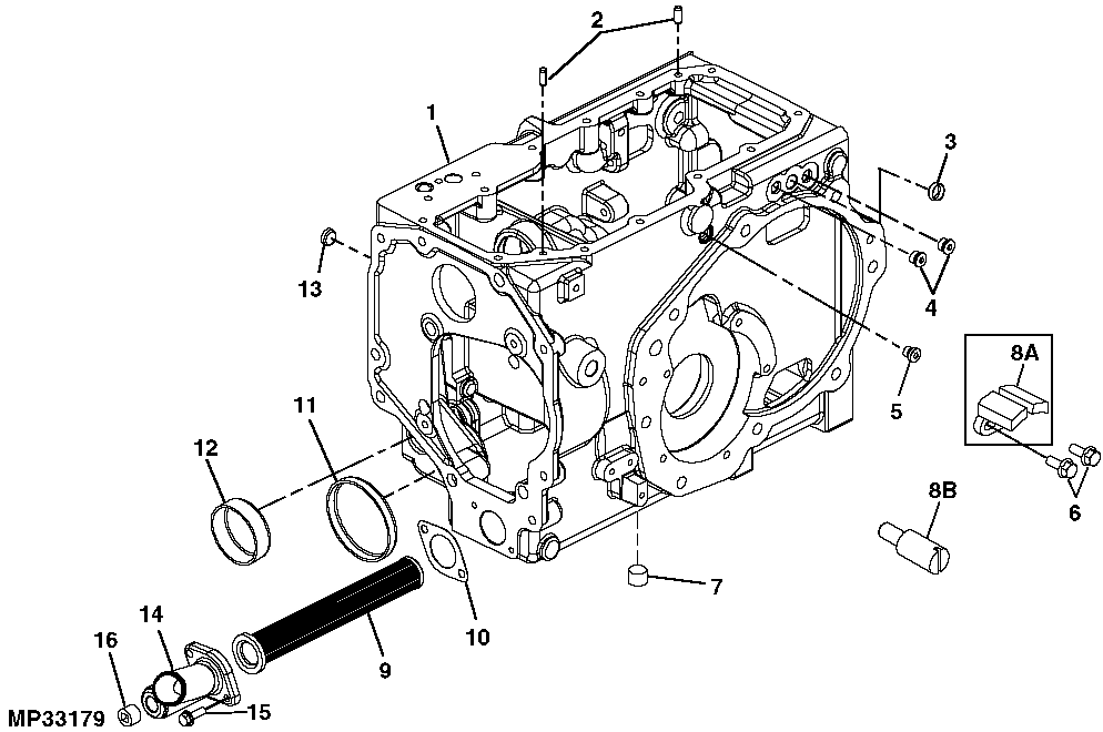

Transmission:
Have you checked oil level?
How many hours? When was hydraulic oil last changed?
When was filter replaced?
When was internal screen cleaned? Key 9

1) Have you changed the fuel filter?
YES
2) Have you made sure the fuel shut off valve is ON?
YES
3) Maybe Bad fuel Pump?
I am not sure if we can test the fuel pump. This is because it shuts off after 10 seconds.

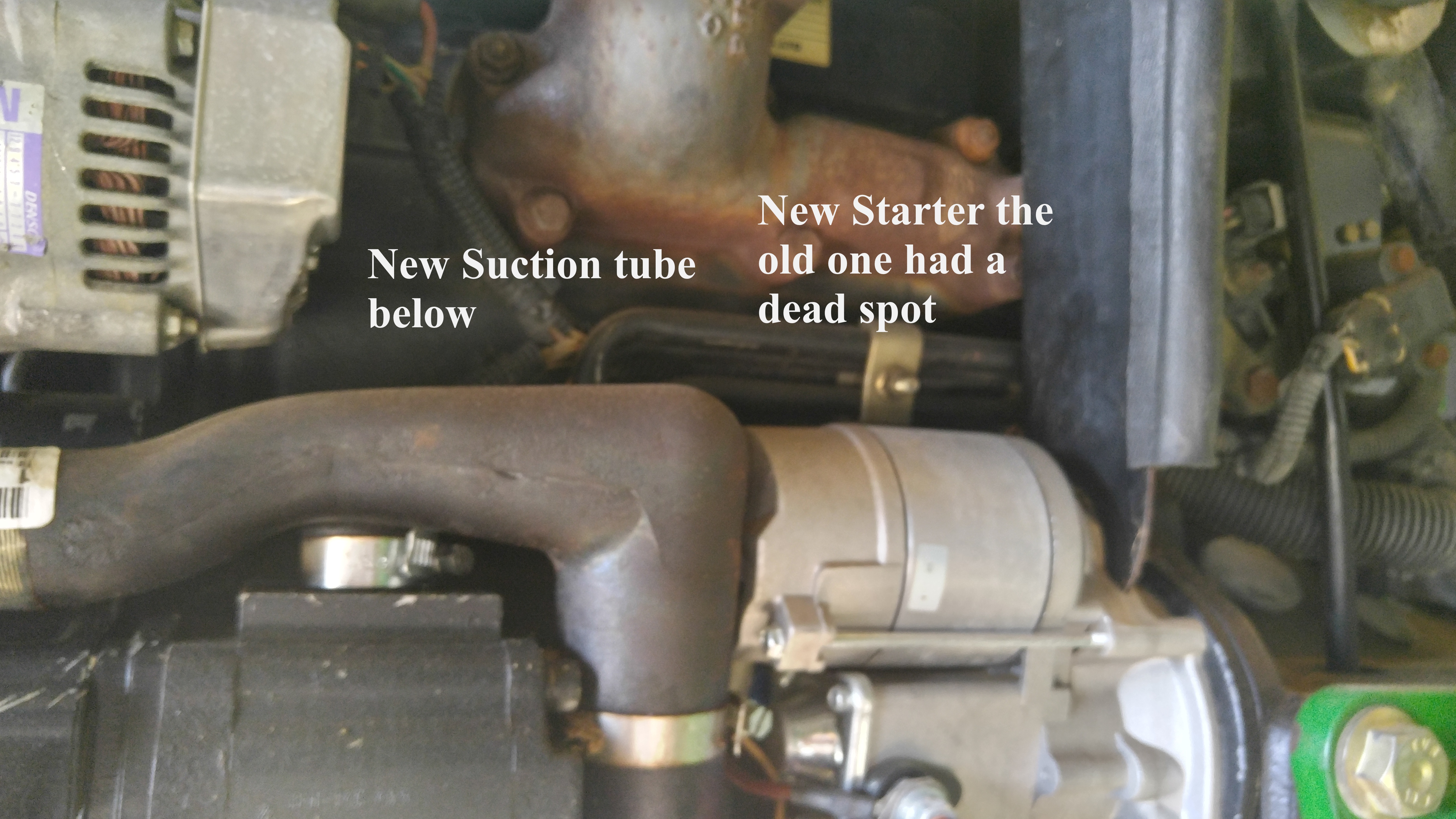

Suction Tube manifold- oil supply. Page 531. the tube was cracked & old. We could not get past to replace the starter. So we thought it was best to replace it.

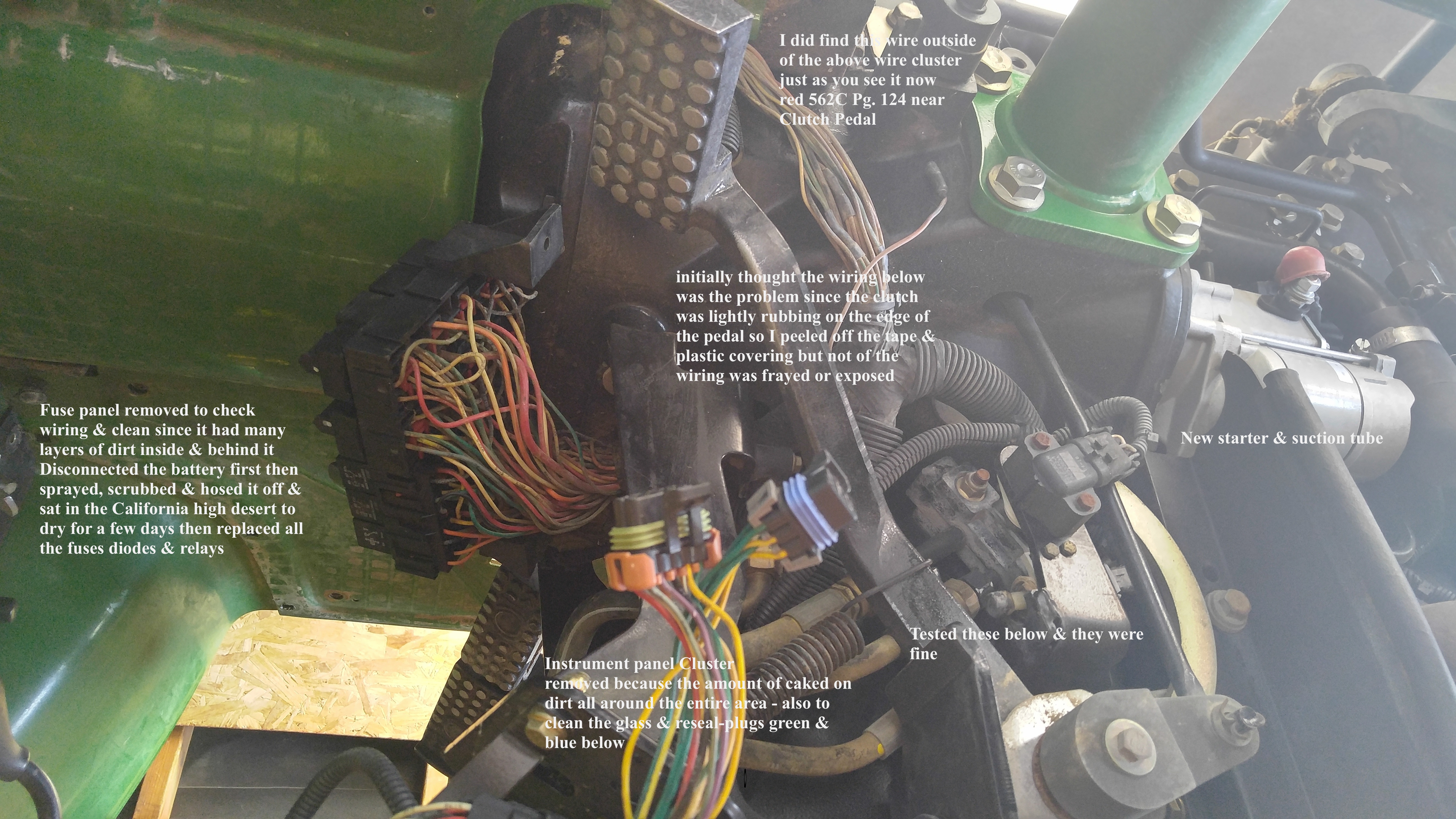

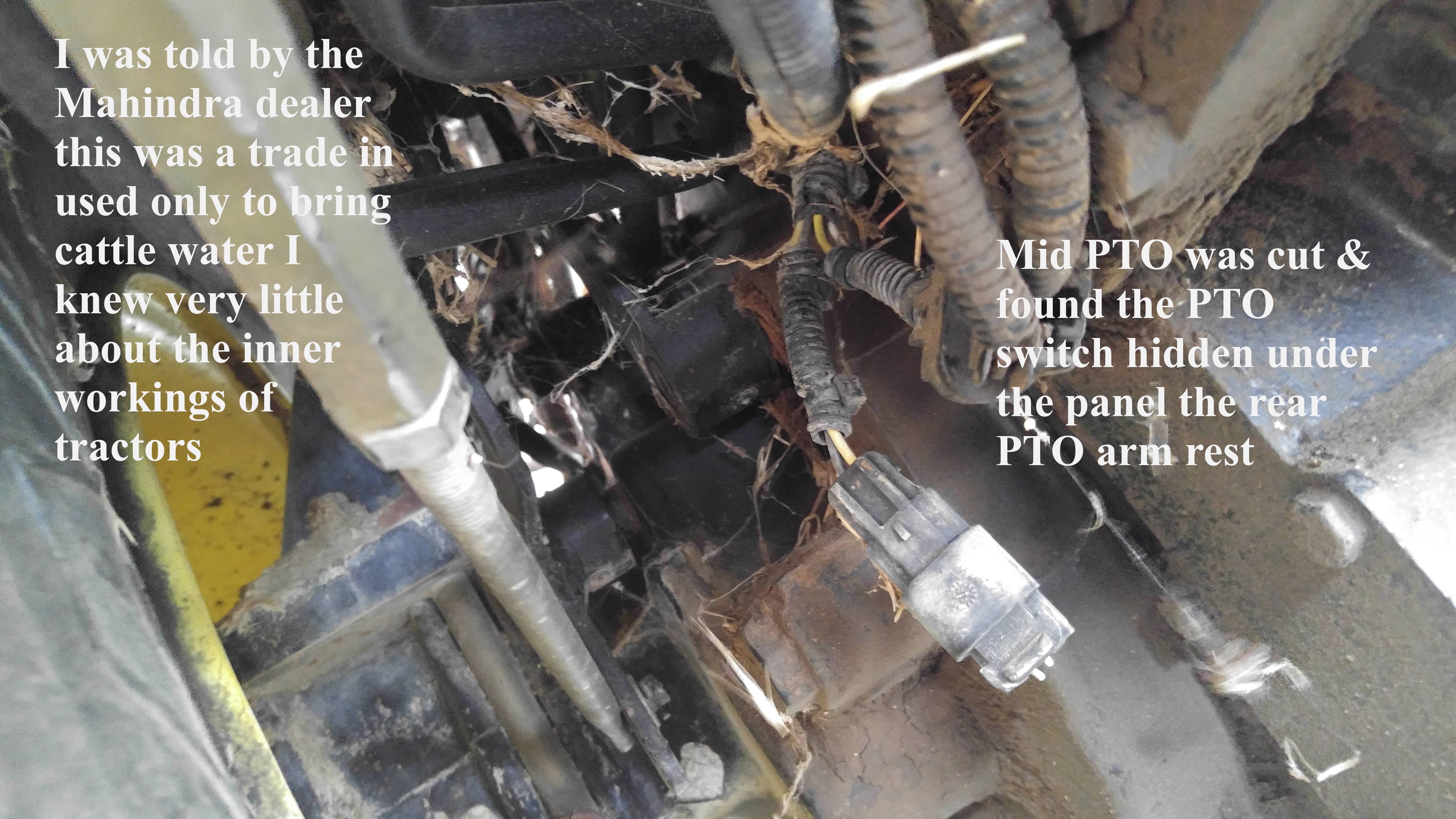

My husband & I bought the tractor from a mahindra tractor dealer. The tractor has been brought in used. It ran for about an Hour, then for some reason it stopped running.
My husband hot wired the battery, but it did not kick over. We figured the starter was worn & had a dead spot. At the same time we replaced the ignition switch; just to be safe.
As my husband took the sides off & pulled back the instrument panel, we noticed underneath every crevice was filled with dirt & debris.
When my husband removed the PTO switch it was bad, so we replaced the PTO switch.
Underneath the cover, was hidden a MID PTO switch, filled with Debris & dirt.

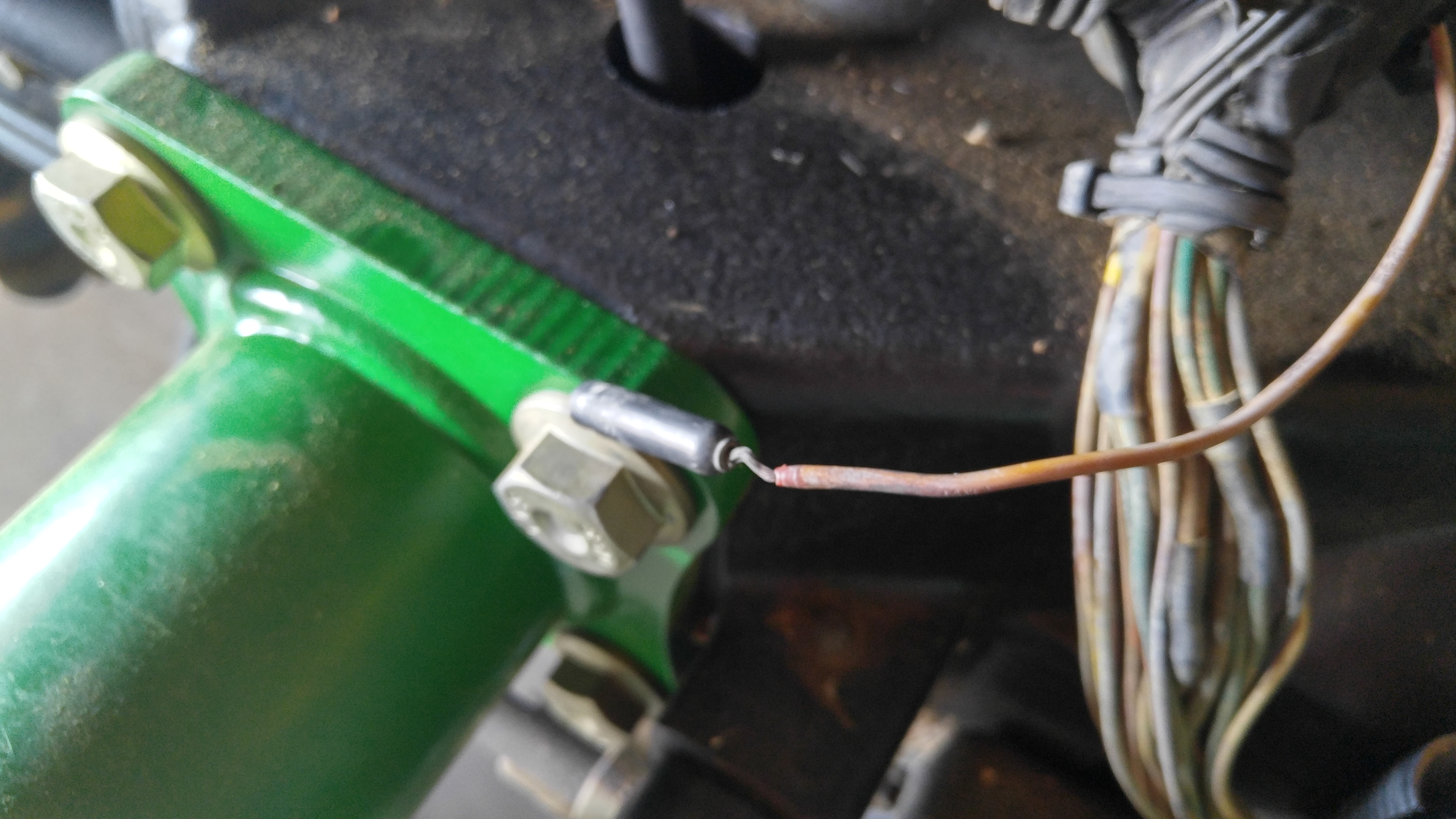

Below I have attached photos. My husband labeled the photos.
Thanks,
Bonnie

  • Suction tube manifild repaced was old & cracked & needed to remove to replace starter.jpg

From some of your answers, I assume you have the TM (Tech Manual). Such as page numbers (too high for an OM Owners manual) and wire numbers.
Nothing for eHydro will apply. Moving a fuse for eHydro is most likely to calibrate the transmission. So I am not sure if the fault light should come on when key is turned on or not. But I would concentrate on getting the engine running, then worry about getting it to move.
Since I do not have the TM for this tractor, it's hard for me to help. But I am guessing the tractor stops running due to lack of fuel. I would start with the fuel shut off solenoid. Put a volt meter on it and see if it loses voltage when the tractor quits.
My guess is the jumper wire in the first picture is for the seat switch. Do the wire numbers you listed help tell what circuit this is? I am not a fan of the connectors used this jumper. They cut the insulation and the wires can corrode and cause problems.
You need to study the circuits for the fuel shut off solenoid. What keeps it energized? Relay? Key switch? seat switch? If the fuel shut off is NOT the cause of shutsown after 10 seconds, I would check the fuel pump. See if the TM gives a procedure to test it.
I would also try and determine what the wire near the clutch pedal is for. Red 562c

the fuel shutoff solenoid on my 4300 has a pull in and a hold in, my guess is your 4310 has the same. It could be that the pull in is working and the hold in is not strong enough to hold the shutoff in the run position after the pull in shuts off. Not sure just how long the pull in stays energized
/ John Deere 4310 Up-Date #6
Typically the pull-in coil is active for only a second or two. It's a very high current coil and will rapidly overheat if left on for very long. If Bonbon has the manual, the pull-in current and time information should be in there.
