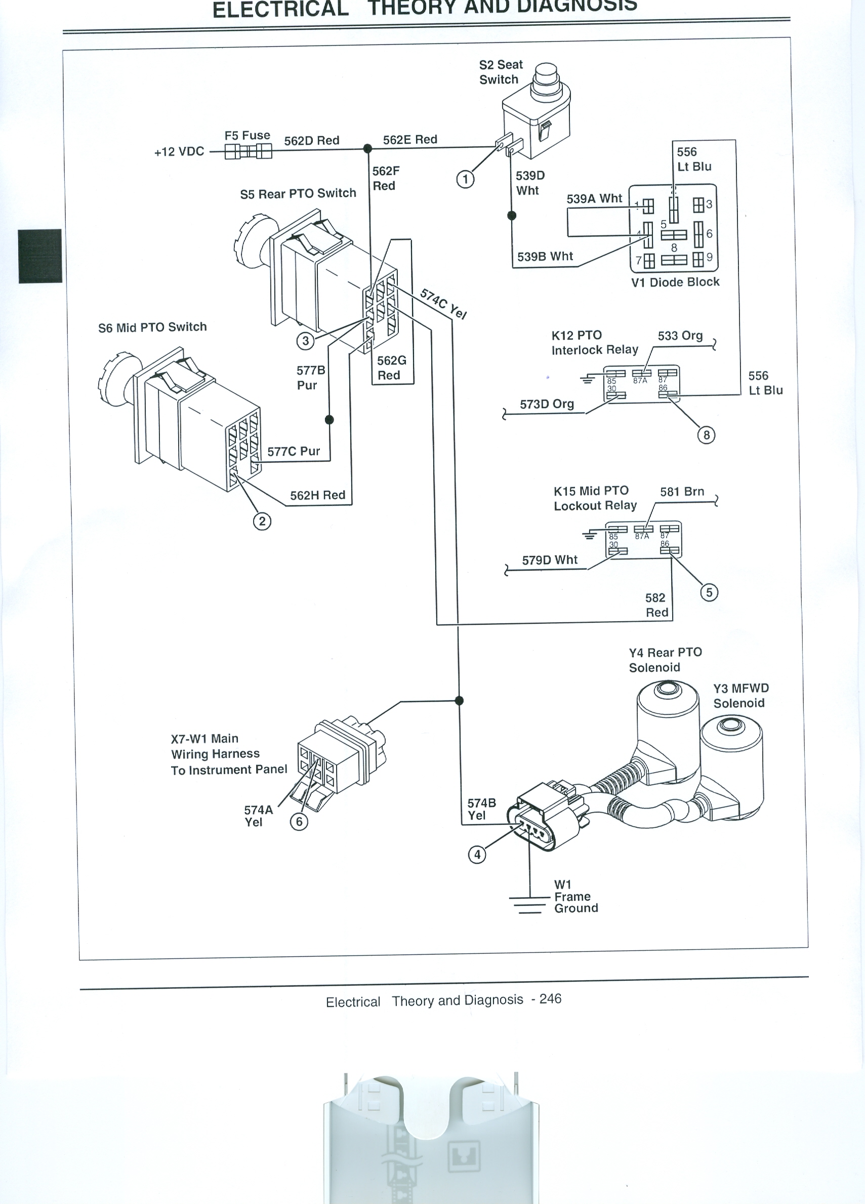

/ john deere 4410 #7
Very rough tranlation from my JD shop manual. I had to print in b/w did not use the expensive color and then scan into a file. Hope this helps. Lot of work. Hope the uploads worked. ----Fuseboxer
  • P234.pdf
  • P243.pdf
  • p246.pdf

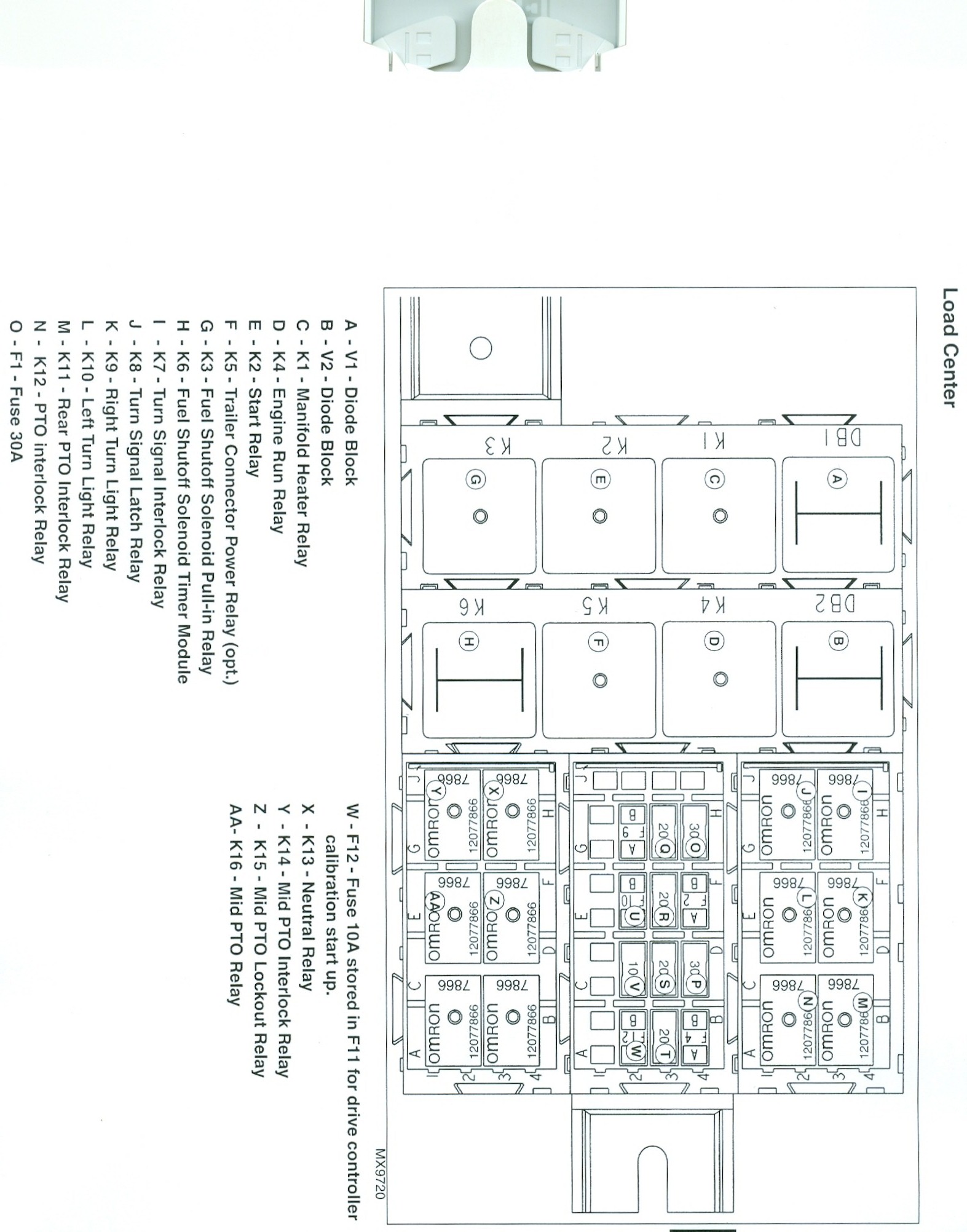

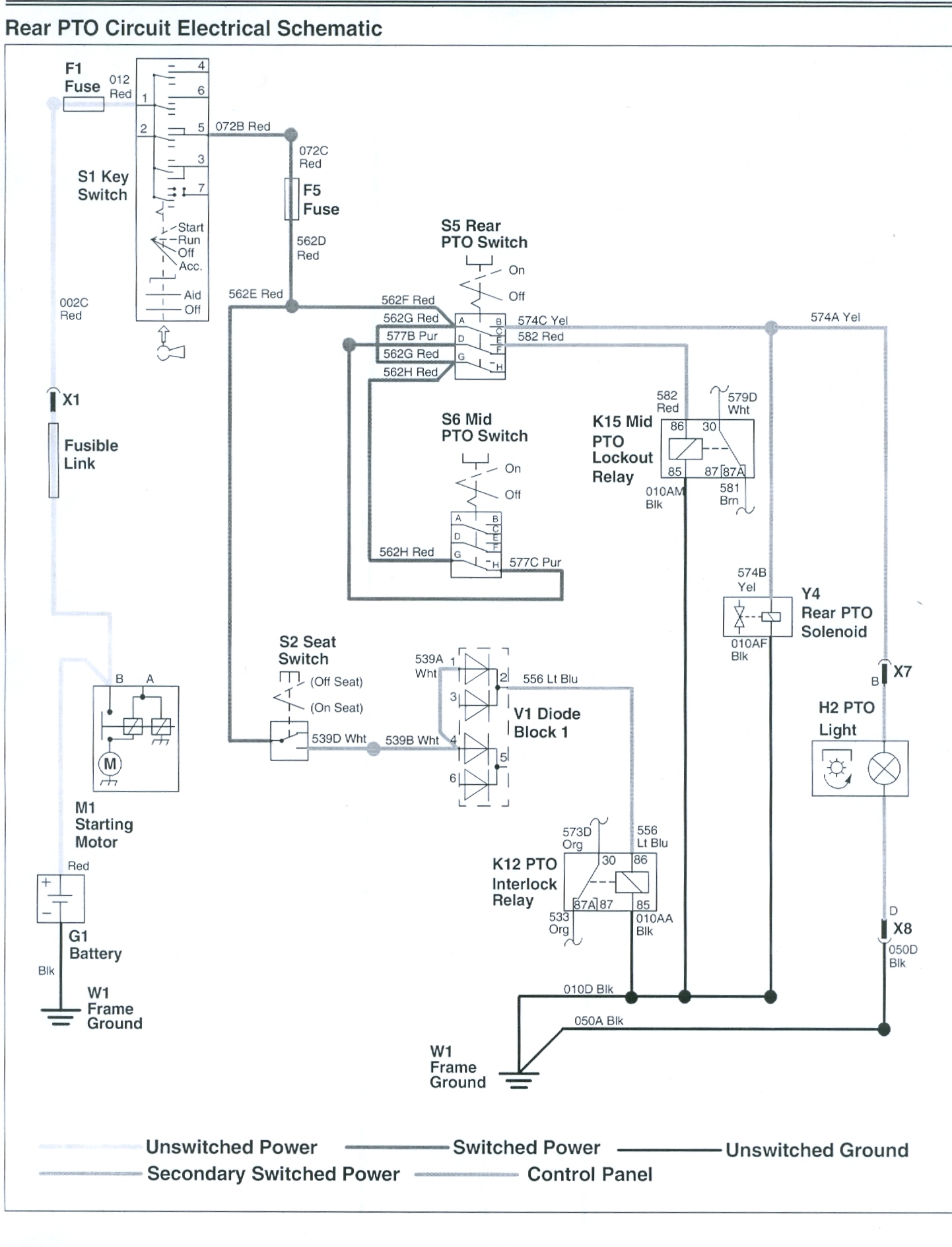

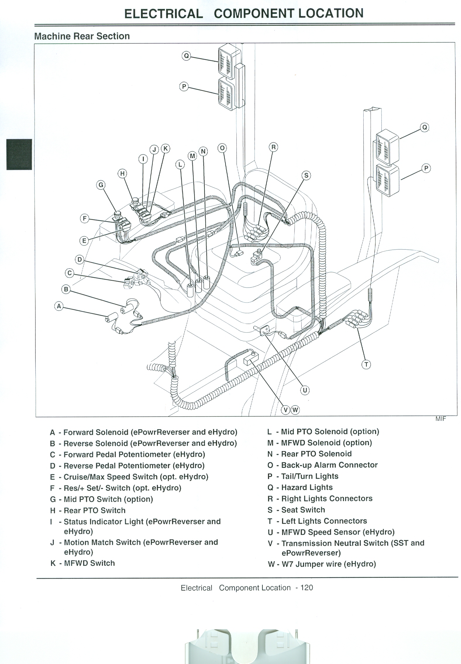

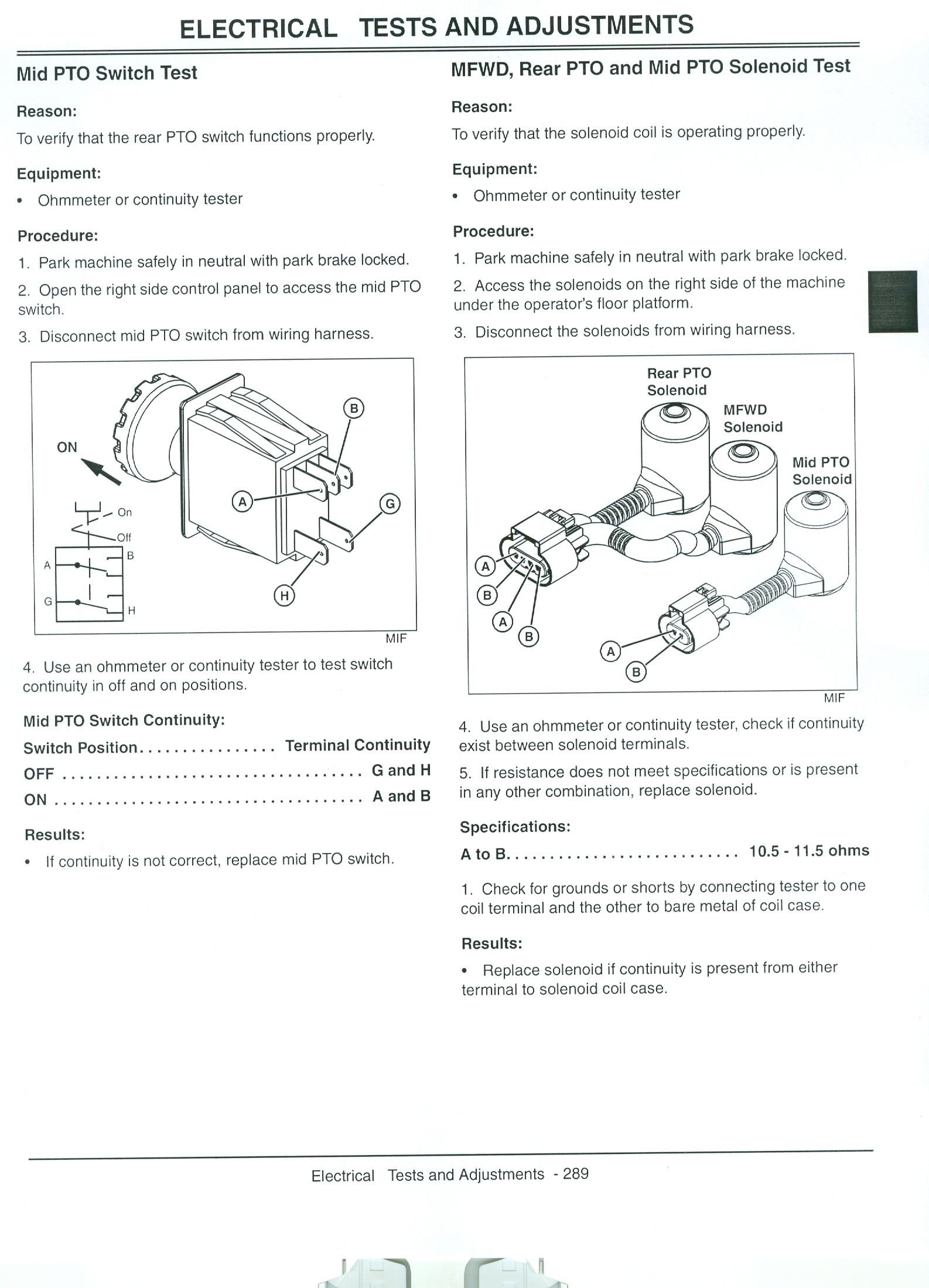

#12
I put the brake on, put it in neutral, pull the yellow knob, the dash light goes on but I dont hear any relay noise. Maybe the relay is gone? I think those are in the fuse panel? Do you know which one controls the rear pto? Is there any way to test the relay to make sure it is functioning? Does your tractors pto turn by hand freely?
/ john deere 4410 #13
I had a similar problem. It turned out to be one of the black relays in the fuse box.
/ john deere 4410 #14
If the light goes on the dash the relay is probably working but the wire to the actuator solenoid is where I would check. First do a quick check the top right corner of the fuse box and the relay one under control power to the PTO. Switch relays with the two to the left, all same part number. Now you have two different but the same relays controling the power to the rear PTO. I still think it is your solenoid actuator under the tractor, check power, wire is w/o a complete circuit. No power to the actuator. You need to go by the service manual.
/ john deere 4410
#15
Thanks again fuse boxer! If I understand you correctly the black relay farthest to the right is the one for the rear pto? Switch it out with one from the left? I assume these unplug and plug back in? Next question how do I distinguish which solenoid controls the rear pto? There are three under the right rear tire, they all have the same colored wires going to them. How do I test to make sure power is getting to it? Lastly when I turn the rear pto by hand it turns a bit then flunks does this sound right? The mid pto spins freely with no clunk is this right? As always thanks for your input.
/ john deere 4410 #16
This is my last time I will make copies out of my service manual. You need to pay a little money and buy your own. :)
