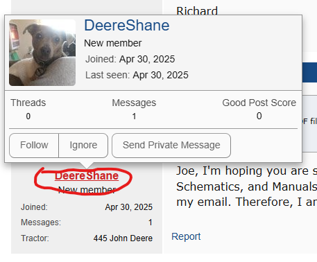

Hover over the area I circle on the members avatar and you can choose to send a private message:
