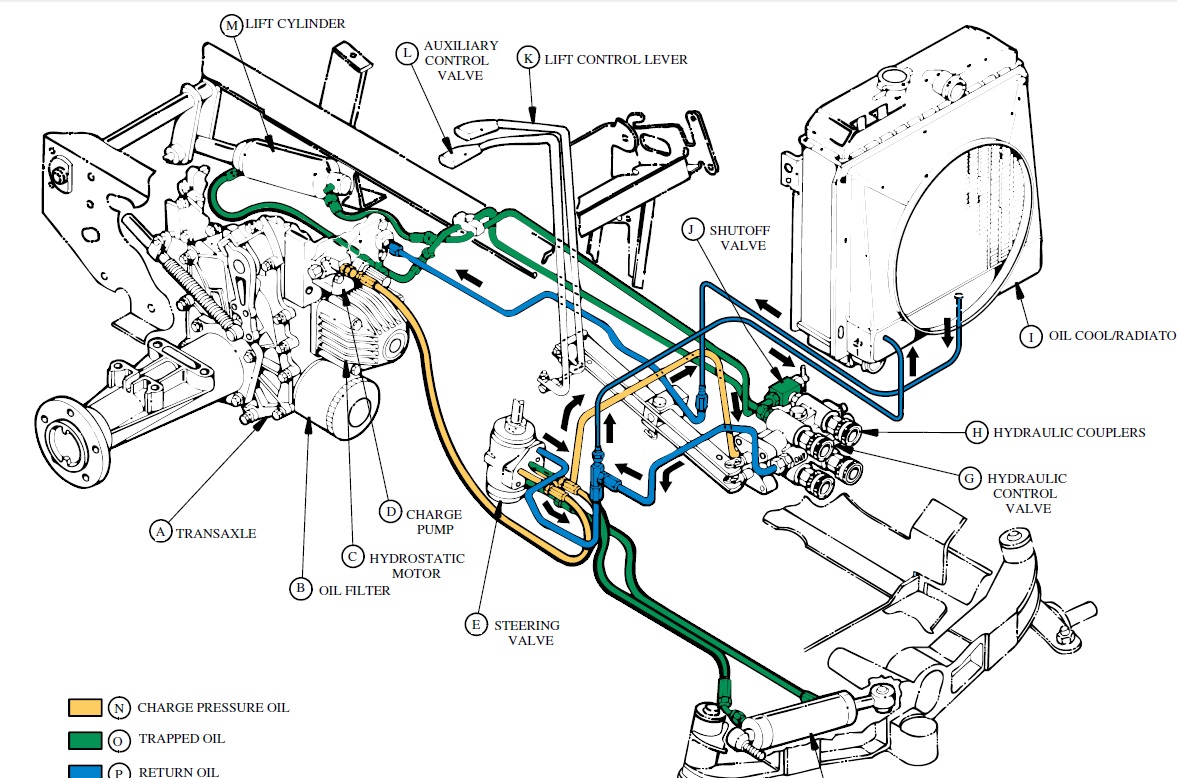

I think these mowers have a separate hydraulic pump to operate the steering and deck lift. Check out your pump. I assume they have shared reservoir with the transmission. I had the predecessor to the 445 which was the 332 and it had separate hydraulics including dual front quick connects.
/ John Deere 445 #5
Here is the "theory of operation" from the service tech manual.
/ John Deere 445 #6
Here is the hyd. flow chart. You may also find it very worthwhile to get a copy of the service technical manual and have a ton of information at your fingertips.

No they don't have a separate pump. The Hydraulics work of the same pump as the transmission charge pump.
Just finished assembling my trans axlel and I would have to say that the problem is a hydraulic problem only.
I am a mechanic and when I get a chance I will look into the problem if you have not solved it by then.
If it moves back and forth it is not an oil problem. Same pump same oil.
It sounds like it could be a circuit relief but that is only a guess. I don't have the manual in front of me.
Just don't panic and start ripping and tearing!
/ John Deere 445 #8
Just thought of what it is I believe it is a priory valve but again till I look at the manual I won't know for sure.
The steering has priory over hydraulics because of safety. I would have to say something is sticking and I bet it is in the hydraulic control valve where the hose couplings are on the left front.

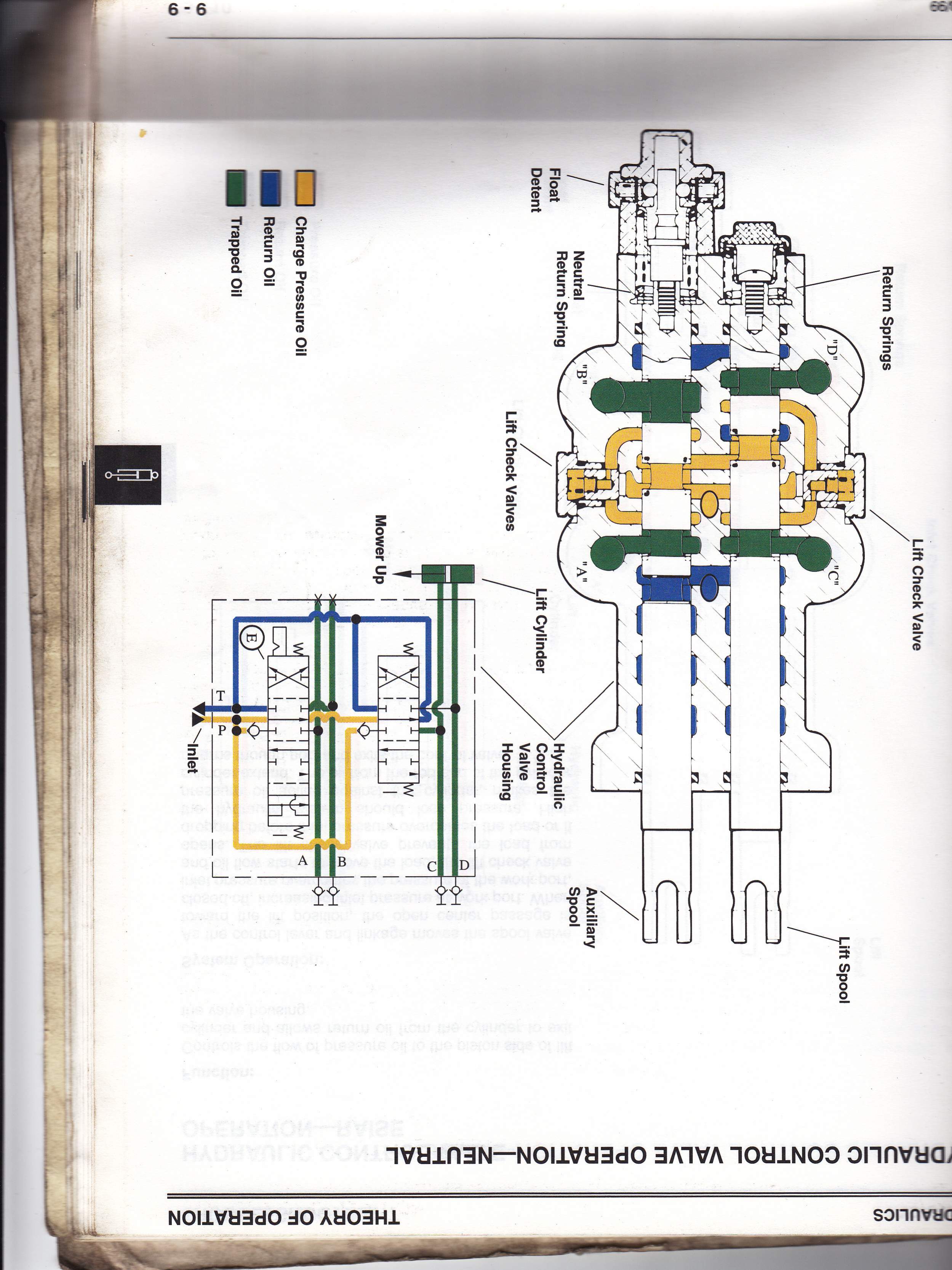

/ John Deere 445 #19
Here is a picture of the hydraulic control valve that has the hose couplers under your left foot. As you can see there are two lift check valves. These are the ones I want you to look at.
The color of the flow is yellow just as in the previous pictures.Which is pump charge pressure. If either of the two check valves are unseated a tiny little bit they will not allow pressure to build in either the steering or the hydraulic lift circuits.
