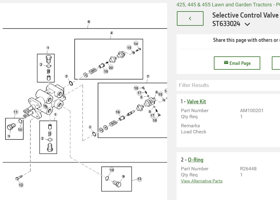

gentlemen, I have tried everything on the page with no resolution. One difference is mine will not steer either. Fluid is new, filter is a JD, I have taken everything apart and everything seems to be as it should. Please give me an idea of what I should try next.
1997 JD 445.....1400 hours

/ John Deere 445 #25
fluid is changed, with a new filter, the valves at the front left foot have been taken apart and cleaned, top and bottom bolts heads and both pieces on the side. Hoses look good. when starting and running with the front end on a jack no steering at all and sometimes very little steering. Very inconstant. Sometimes I hear an abnormal noise coming from the pump. Thats pretty much where im at now. The fender is off so I have great access to everything.
/ John Deere 445 #26
What implement have you had hooked up to these valves.. called dual SCV
Where are you located?

/ John Deere 445 #27
I have never hooked anything up to these valves. Lafayette, GA
/ John Deere 445 #28
On the drawing, 1, 1 ,4 and 7 Have taken apart and all seems to be good. I cleaned up real well and reassembled.
/ John Deere 445 #29
Then I am wondering what problem caused you to take these valves apart as described?
/ John Deere 445 #30
Earlier in this thread, it was recommended to to check them to make sure they weren't froze up
/ John Deere 445 #31
