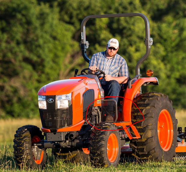

Its common for open station tractors to blow lots of heat on you. Its one of the reasons Kubota puts small shields on the front of the 60 series platforms, keeps heat away from your feet.
