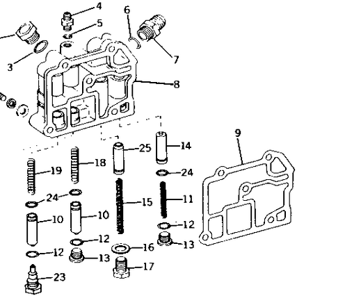

that may be it, were is the hyd filter relief valve located?
   / John Deere 500c hydraulics #12
Correction: I was thinking about smaller tractor when I stated RH side. Hyf filter relief valve is on LH side on a 500 series. I don't remember which valve is filter relief but I think it's either key 14 or 25.

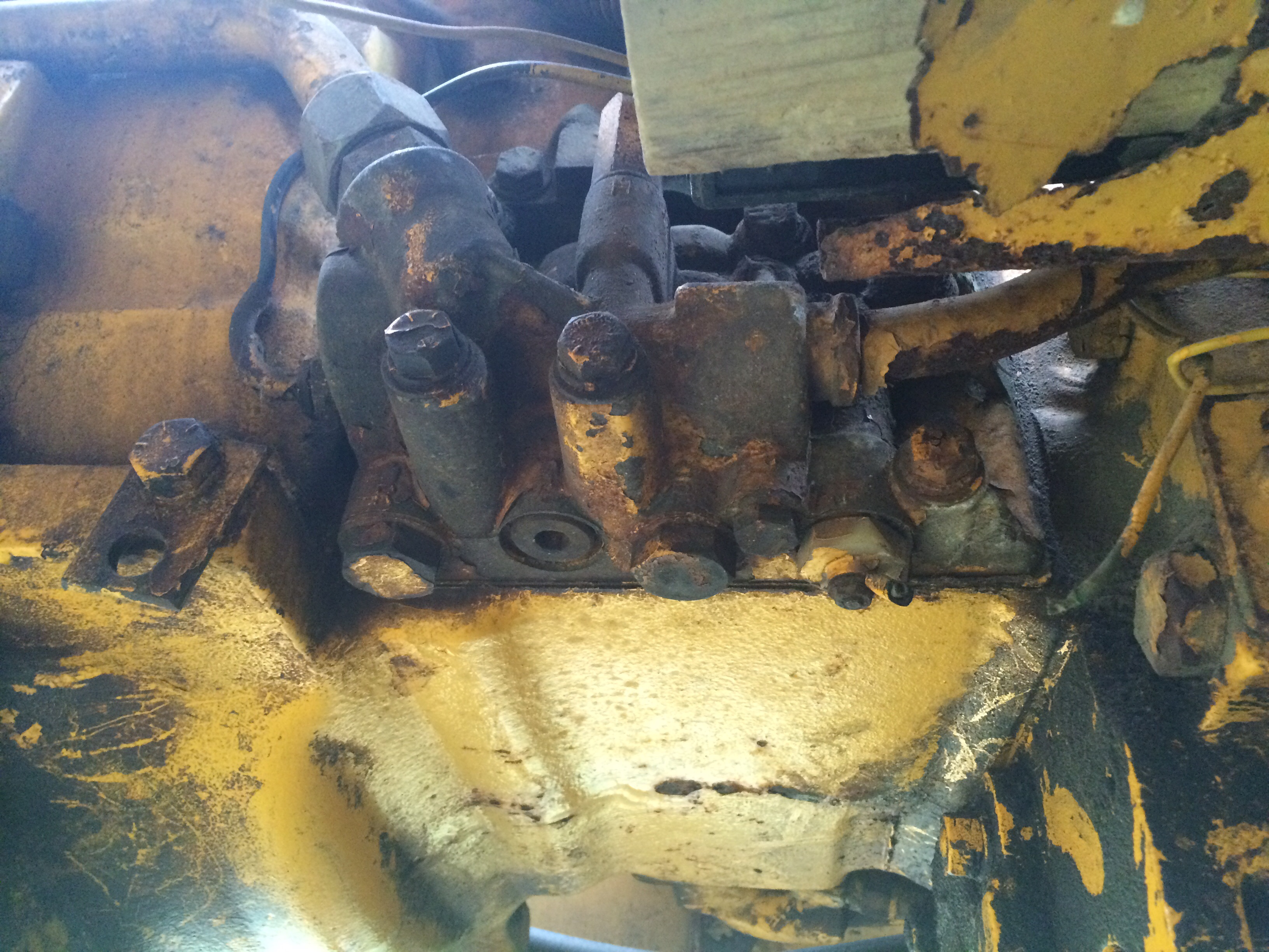

I've attached a pic of the valve housing the plug closest to the rear of the machine is plastic and has an electrical connector on it. I did not see that in the parts diagram, would that be the relief valve?image.jpg
   / John Deere 500c hydraulics #14
As I previously stated I don't which valve is the valve in question. You need to acquire a JD service manual for your tractor.
