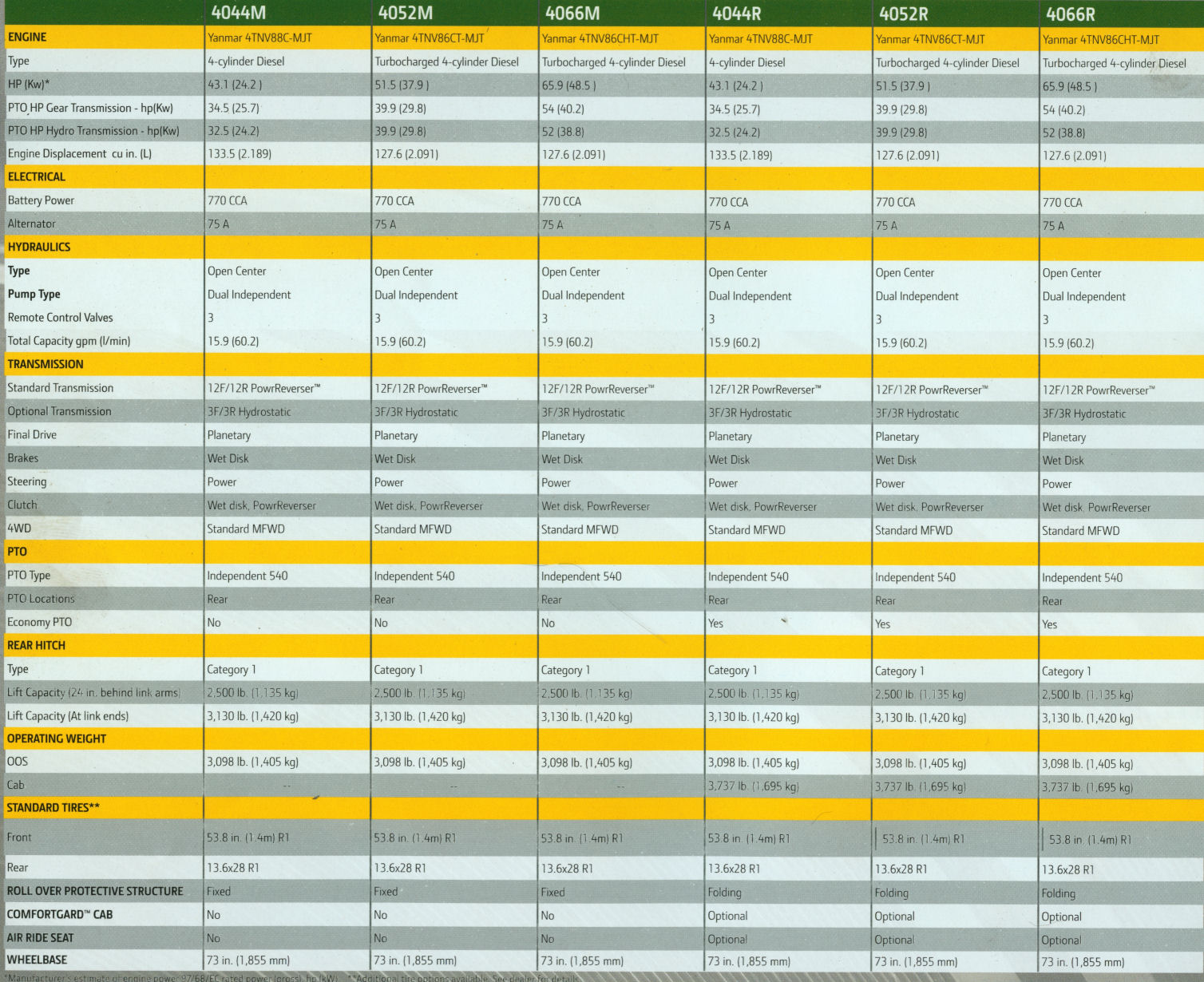

You're thinking of the 5000 series where the E models are basic, and M are deluxe (plus made in the U.S.). For whatever reason, the 4000 series is different and the M is the base model, while the R is deluxe. I think they're light (3,700lbs) for the horsepower, and have a weak loader (2,200lbs to 110").
You're right. You would think they would keep that designation the same over all lines. Oh well, who can ever figure out how big corporations think.
   / John Deere 5052R Compact Utility Tractor #12
Brian,
Which model are you referencing? An open station 4052 weighs 3770 lbs. and a cab is optional that brings these tractors to 4300 lbs. roughly. My 4520 cab with iron weights is about 5500 lbs.
I had taken those figures straight out of the JD brochure other than rounding the figures. These are actual numbers shown. All 4000 series OOS @ 3098lbs & the Cabs @ 3737lbs. I am only going by what is printed on the brochure. ;)
   / John Deere 5052R Compact Utility Tractor #13
Are you sure? That is the weight of the 3000 series.
I've got the old and new brochures as well as being a 4000 series owner and I am pretty familiar with them.
   / John Deere 5052R Compact Utility Tractor #15
Well, here are pictures of the front and the spec pages of the brochure that I have. I picked up new brochures at the local JD dealer before they closed down back in February. Maybe they were not so new? Still says "New 4 Family" though. :confused:

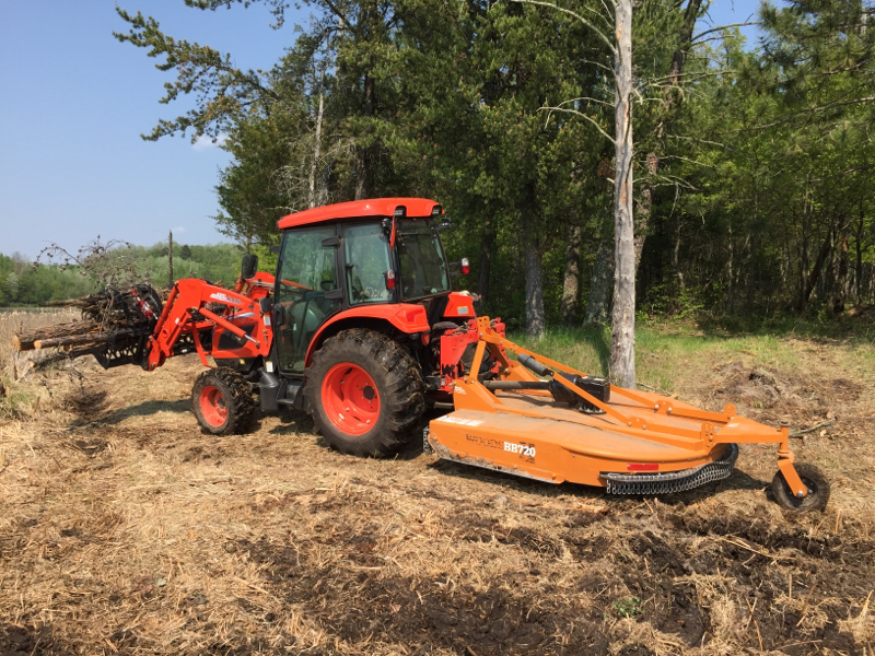

You asked about similar models. Last year when I shopped tractors I was looking in the 60ish hp range. I looked at Deere's 4720 since the 4066R wasn't on any lots at the time. I also looked at Mahindra's 6010, Kubota's L6060, Massey's MF1759 and 1758, as well as Kioti's NX6010. The Kioti had the best control layout of all the cab models. The Mahindra was out due to poor quality interior and hard starting when cold (I'm in Minnesota). Massey is hands down the prettiest, but I did not like the control layout. The Kubota wasn't rugged enough for my intended use. Both the Kioti and Massey are the heaviest in the class, including Mahinda's new 2500 series that claims but isn't the heaviest in the class.
Upon seeing a Deere 4066R after the fact, I was still happy with my Kioti purchase. The Kioti NX6010R HST with loader and cab was 22K less than Deere's 4066R, 12K less than the Kubota L6060, and 6K less than a Massey MF1758.
I remain happy with my purchase and would buy it again. There are now many YouTube videos of all the machines available for you to look at.
