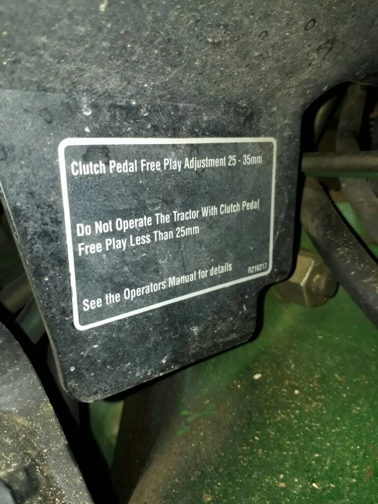

Are your brakes spongy first try? Then second push are good?
   / John Deere 5055e clutch slipping.
#13
Look for a sticker on the side off the dash !
I went right out and looked over the whole console. Just to be thorough I looked over the whole cab also. No such sticker.
#14
I had the brake issue bad. No brakes first try. When I took it to the dealer the first time it had no clutch, no brakes and dry rotted fuel lines.
They fixed the brakes to usable (only half way down to stop) better second pump.

When this issue first started, they sent a tech down to look at it. He said it definitely had a problem and there was no way he could fix it in the field. He said the vibration that was happening was not right at all. Sorry, this is a part of the story I forgot to mention.
   / John Deere 5055e clutch slipping. #17
Unfortunately I bet the tractor needs split and install a new clutch. Not a hard job if they know what they are doing.
   / John Deere 5055e clutch slipping. #18
What kind of vibration do you have? Clutch related? When does it vibrate?
