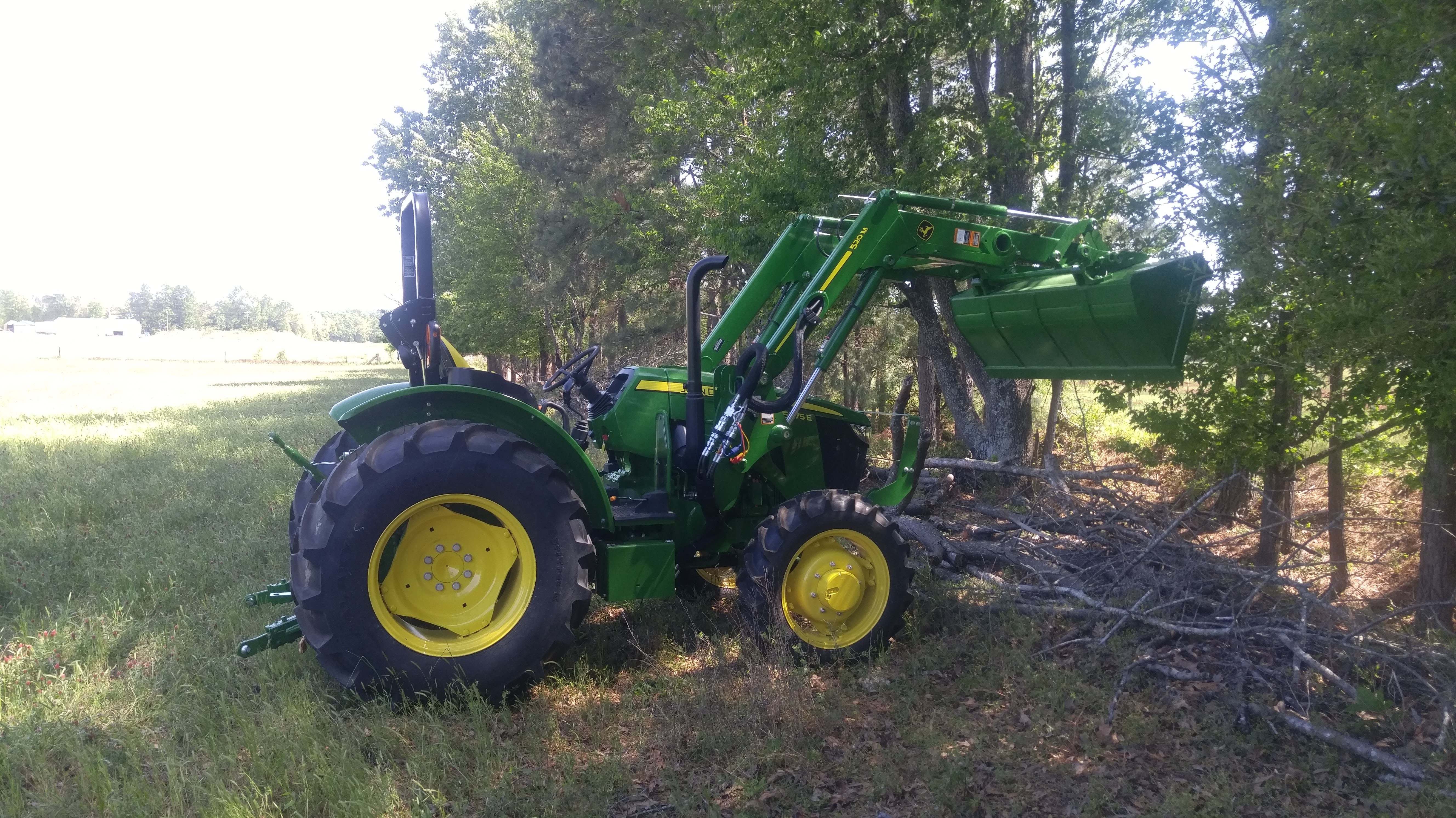

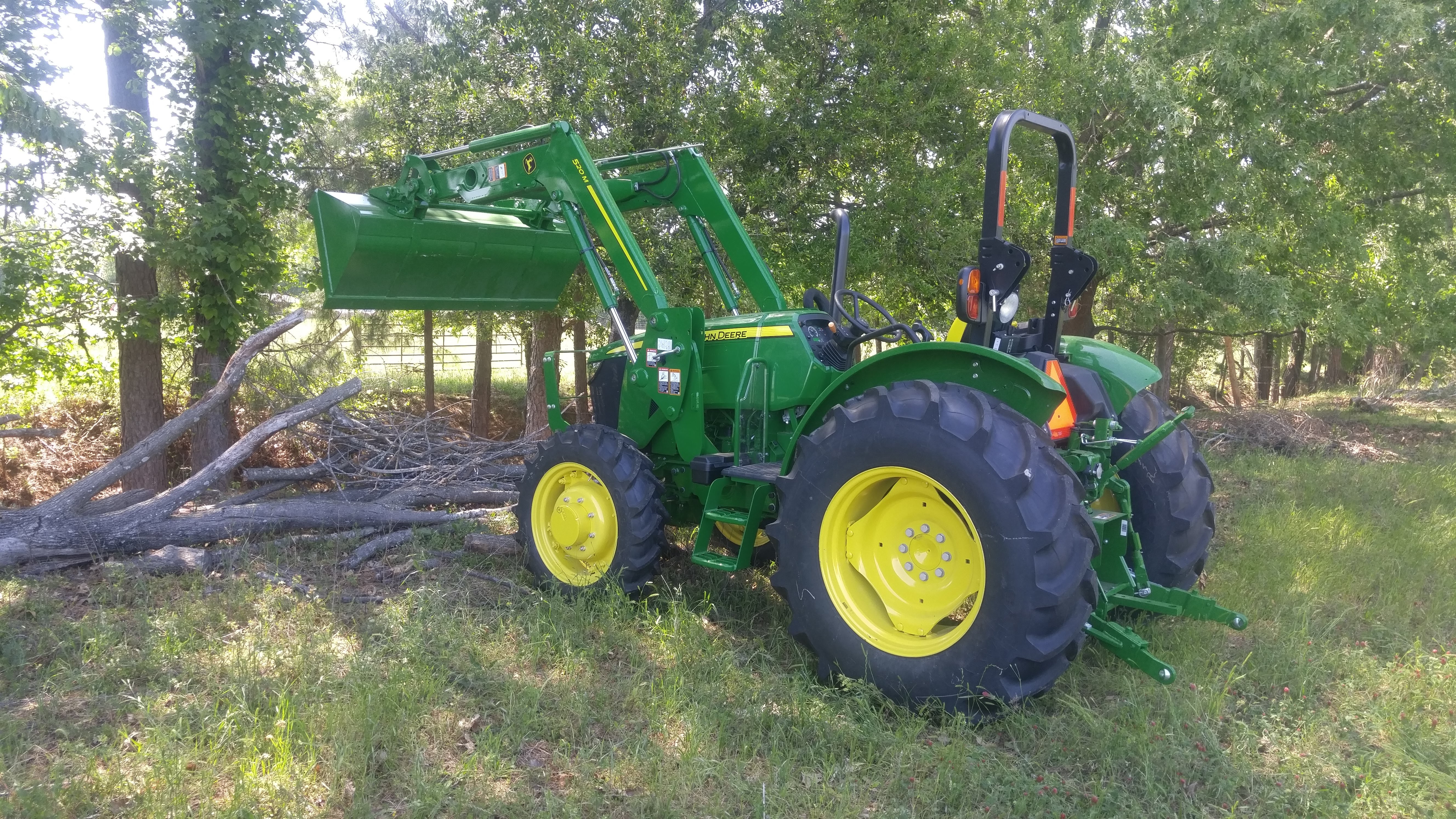

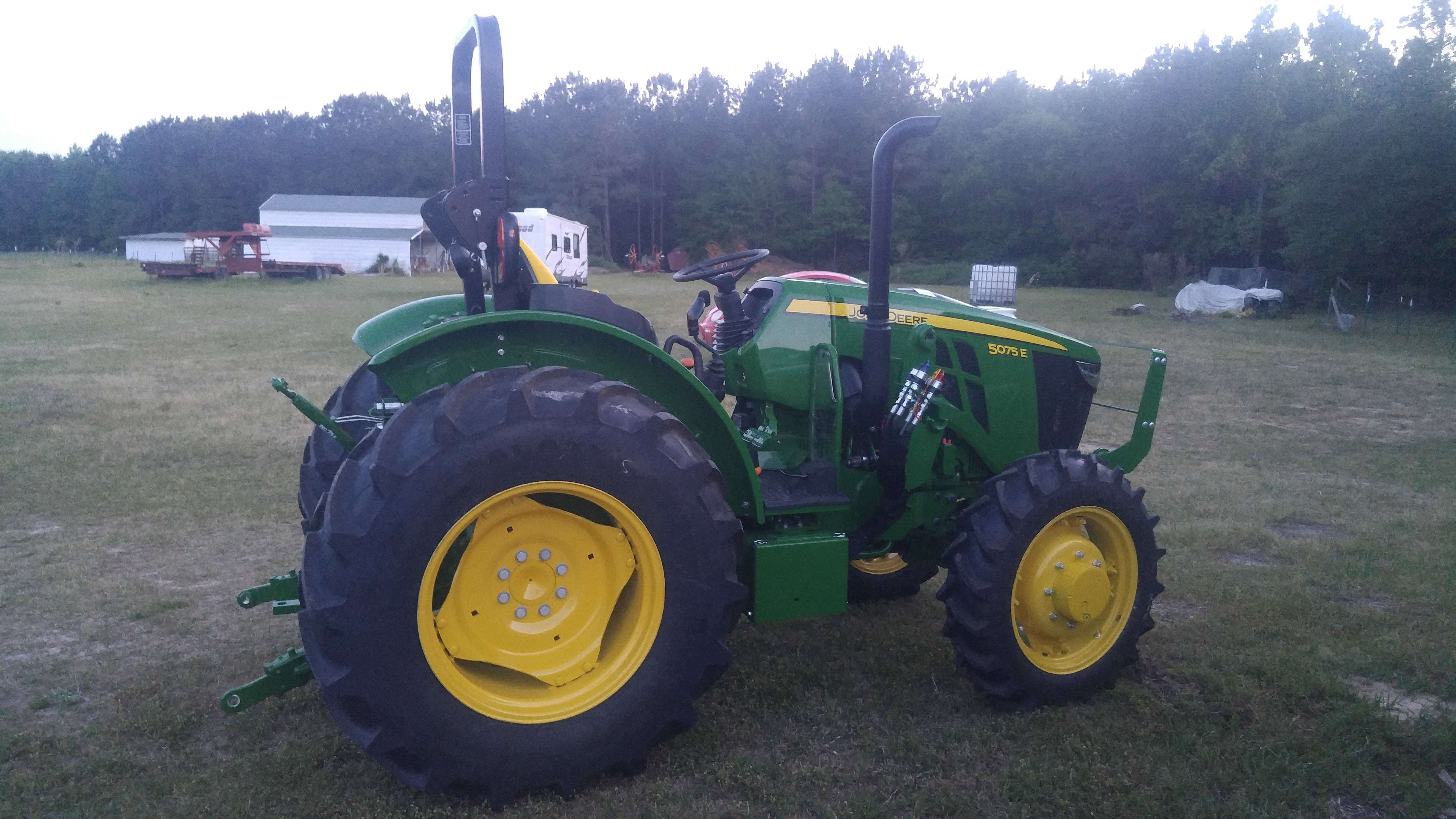

Just thought I'd show y'all what I ended up getting. 2018 5075E 4WD with the 520M loader and I had them add the knob that controls the shift speed on the PowrReverser. After looking at and driving it, the 2600 series Massey, and a M7060 I decided I liked the Deere the most. I can give certain advantages to all of them though. Right now I've just been doing little pittly jobs with it. It should start seeing a heavier workout in the next month and a half or two.
   / John Deere 5075E vs. Massey Ferguson 2607H #10
That is a great looking tractor. I stopped at my local JD dealer today and looked at the new 18 5055-65. Dam I am impressed with the new design. I stopped to take a look at a 4066r and the salesman show me it and then the 50xx series and wow what a difference in tractors. The new 18 50xx is on my short list for sure.
