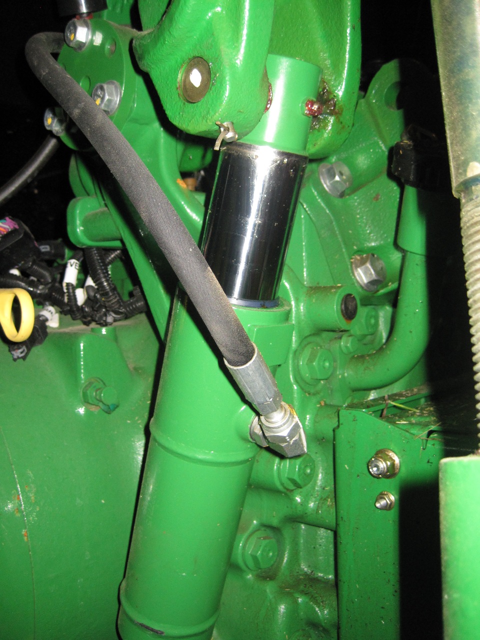

I did get a chance to check my lift cylinder rods, and they are indeed 63mm, meaning I do have the HD lift cylinders.

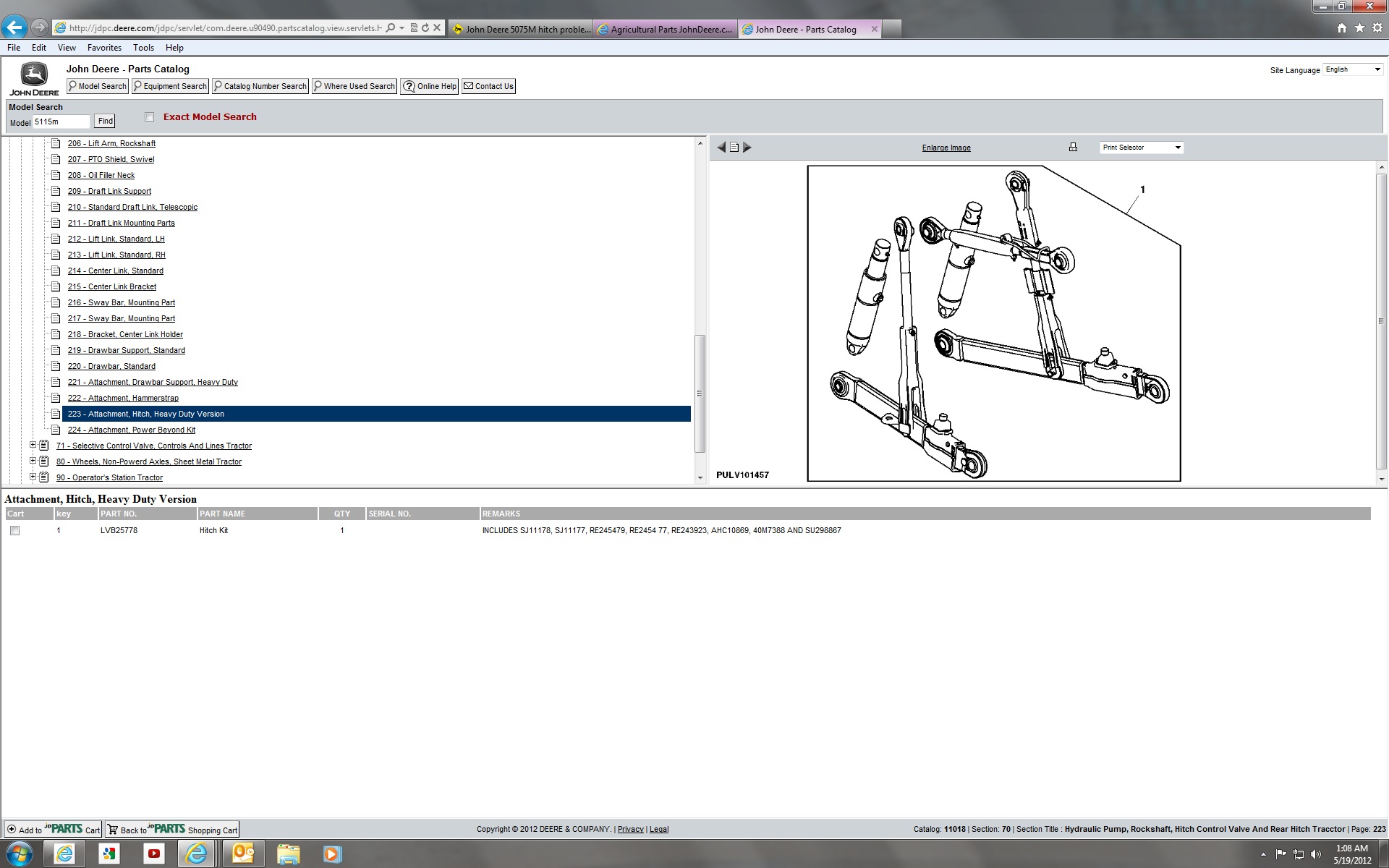

Ok, I went to the online parts catalog and looked at the hitch options for the 5085M. I then googled each one for an online price and put together 3 options.
1 - 50mm lift cylinders SD hitch
2 - 56mm lift cylinders SD hitch
3 - 63mm lift cylinders HD hitch
2 things stand out to me:
1. The SD and HD components are pricing very close
2. The 63mm cylinders actually cost less than both the 50mm and 56mm ones. So for the 63mm cylinder option being $585 seems like a complete rip off if it does not include any other HD hitch components, and even if it does, the prices I found had the being almost equal anyway!

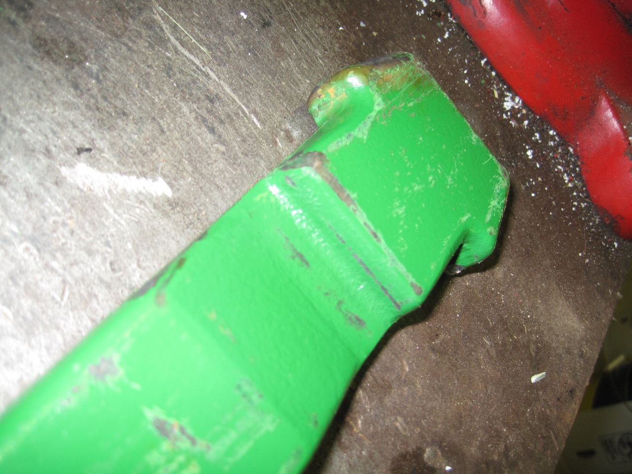

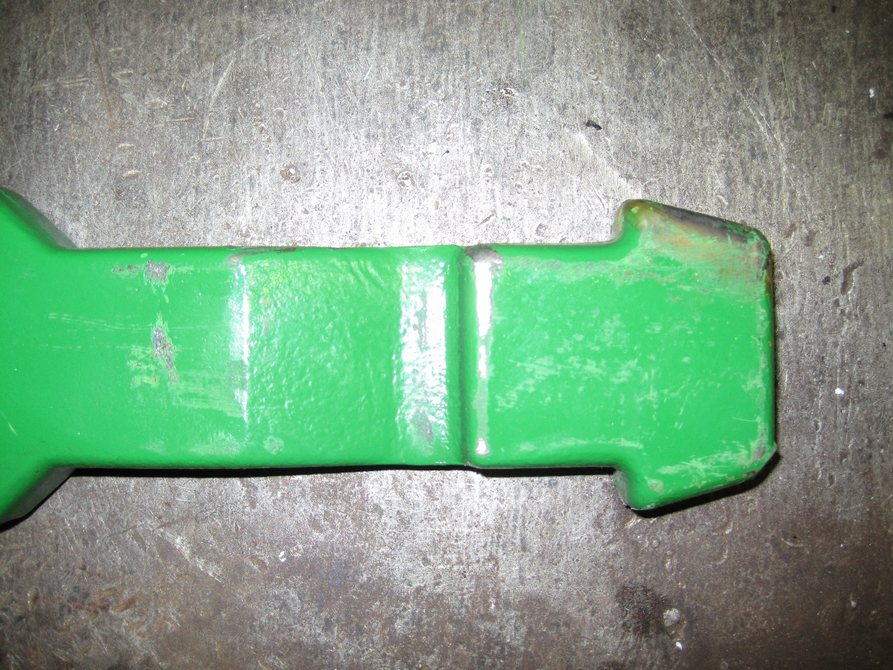

Btw, I did look at the part numbers cast on my hitch and was able to match the left lift arm to the SD one from the online parts catalog. Part number is R260225. My center link body part number is R260378, which is almost identical to the SD one which has a part number of R260377. So I'm pretty sure I got all SD stuff. :mad:
   / John Deere 5075M hitch problem #46
Is it possible that the other components of standard duty hitch will not attach correctly to the heavy duty arms. Perhaps the arms are thicker?

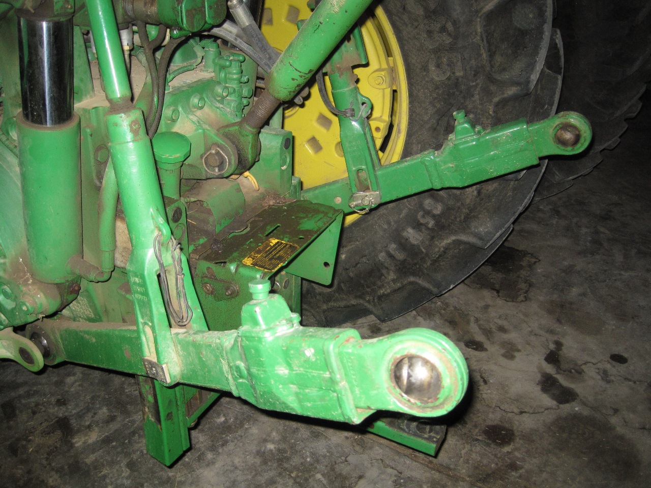

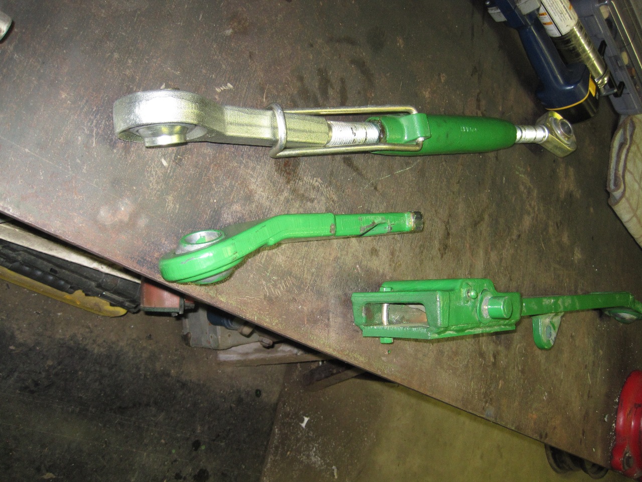

Well guys, I got a call from my dealer. The HD upgrade kit came in. Picked it up around 3. I had some tillage to take care of, started to install the kit around 10:30 tonight, finished up the install around midnight.

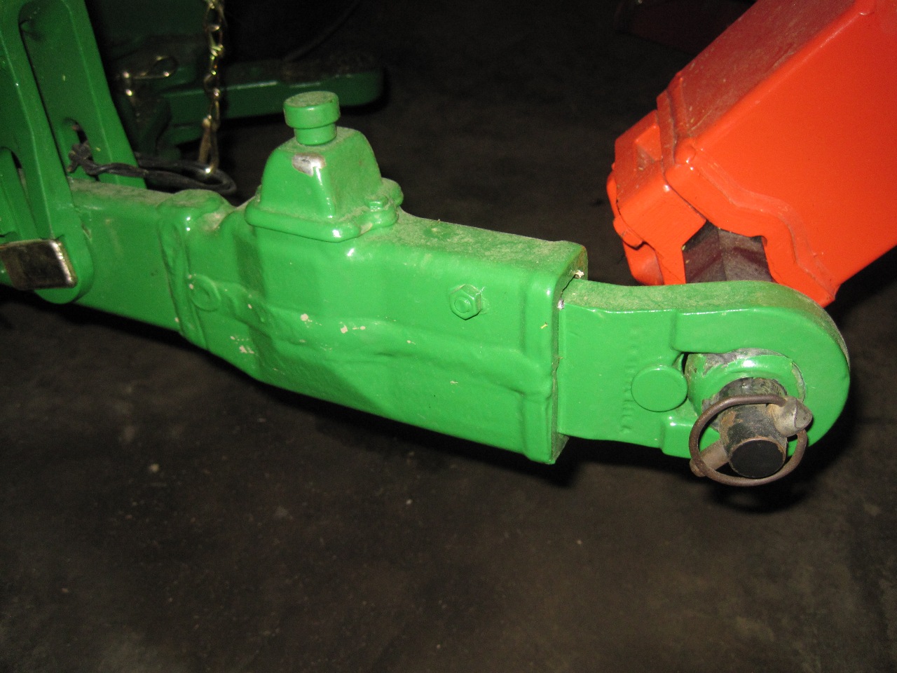

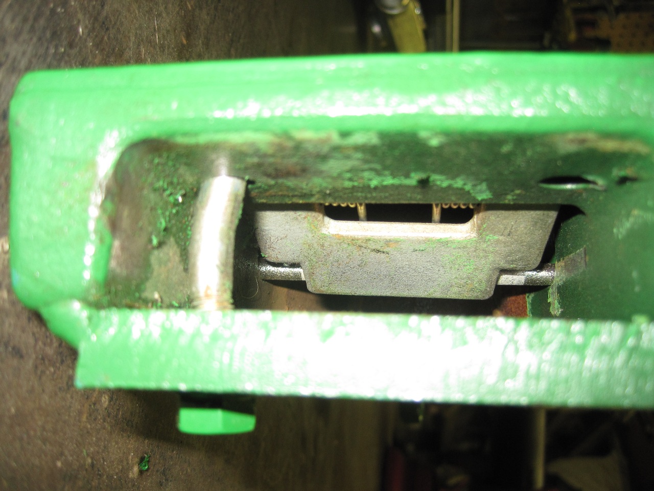

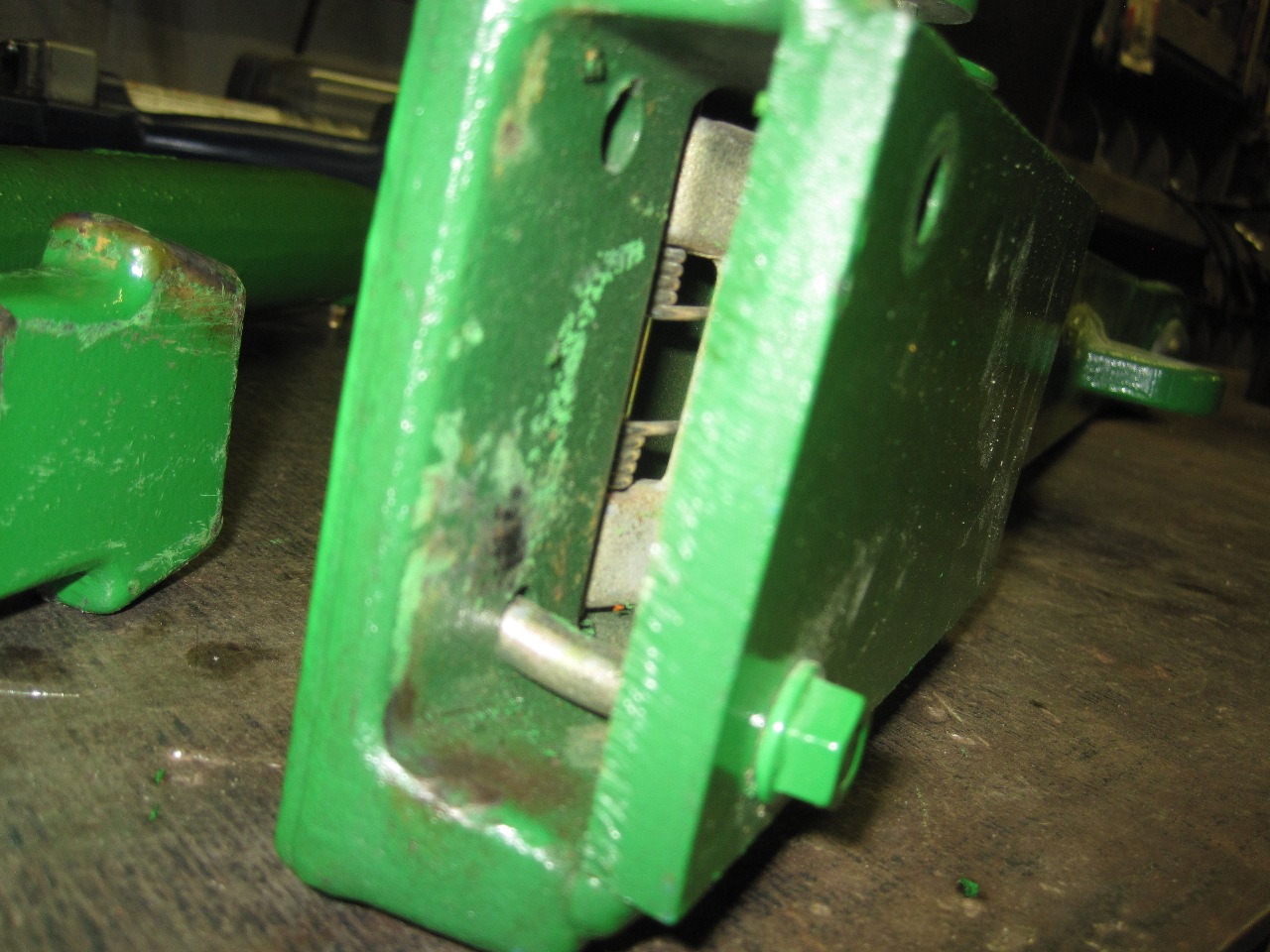

Installation was simple enough. Deere provides good instructions, and the materials are excellent quality. Its a good thing we went with the kit, and not just the lower arms as they would NOT fit. The HD arms are thicker, requiring wider lift link yokes and longer yoke pins. The HD style locking system on the telescopic ends is identical to that on our 6420`s. Very sturdy and extremely heavy.
Our dealer billed us for the kit, at his cost ($1,100). We are going to continue to try and get Deere to cover a portion of it. One thing is for certain, this is THE kit that should come STANDARD on all 5M`s....
I dont have much time to take pics, if I get a few extra minutes I will be sure to though. Joe and I were talking today, he is going to write Deere corporate a certified letter, explaining our situation, and our disappointment. If any of you would be willing to type up a brief narrative of your poor experiences with the 5M hitch system, I would be very greatful. Joe and I want to have as much backup as possible when we confront Deere. If you would like, you can type it up using Microsoft Word and email it to me. Please include your actual name, location, etc. if you dont mind.
(matthewb@zoominternet.net)
Well...its late and I`ve had enough fun....I`ll check back tomorrow some time. Again, thanks for the continuing support and assistance everyone, we greatly appreciate it!

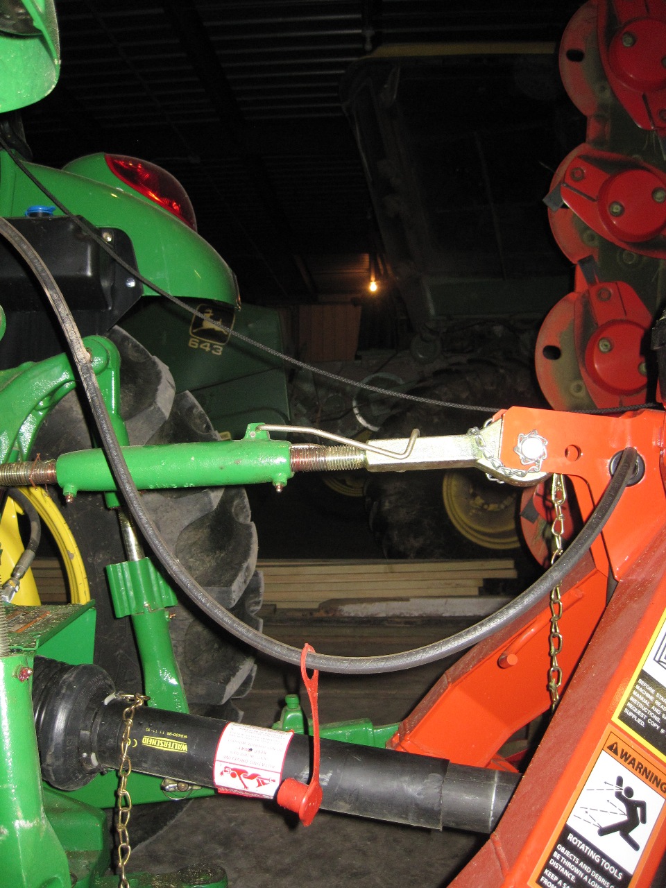

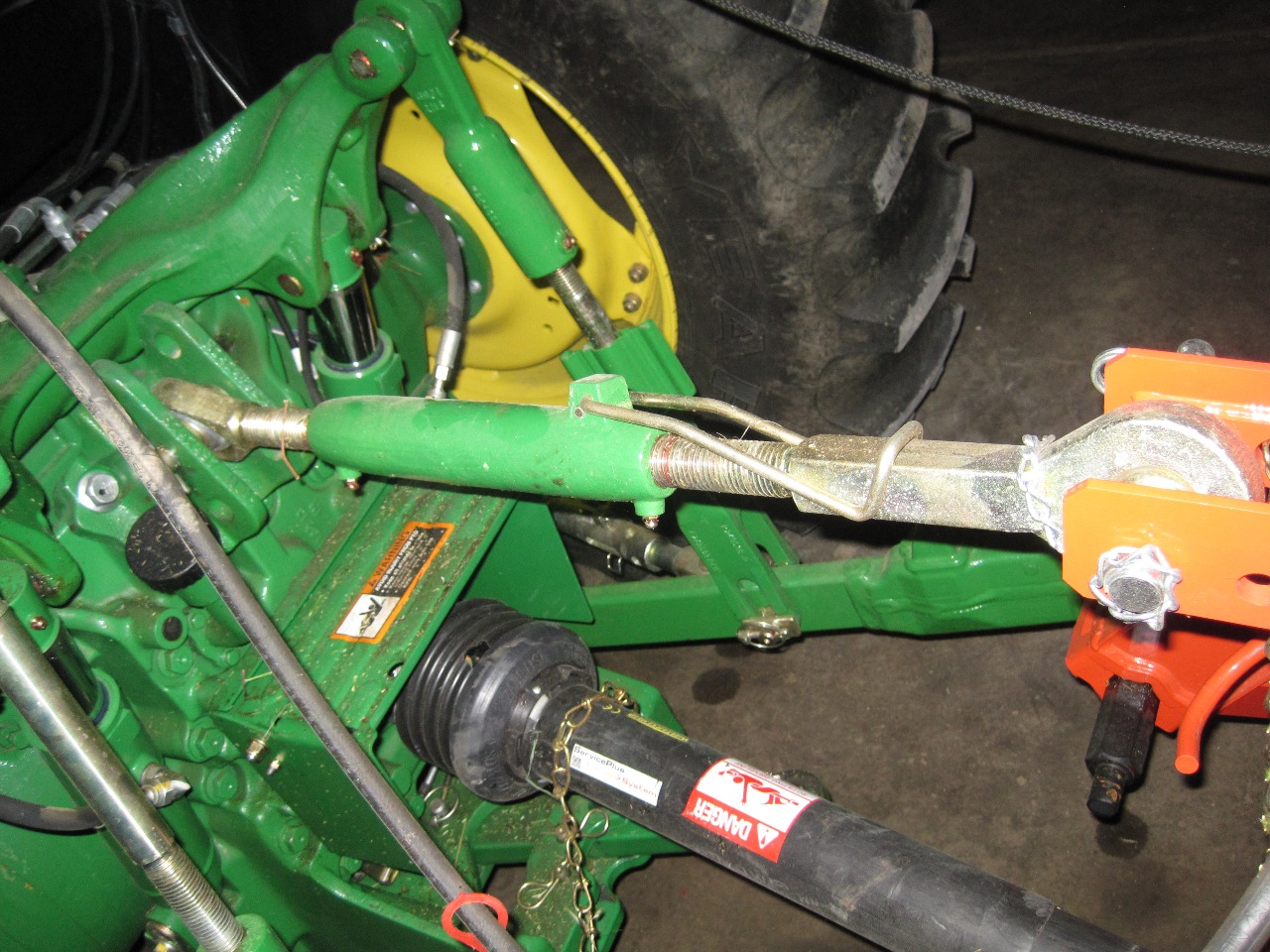

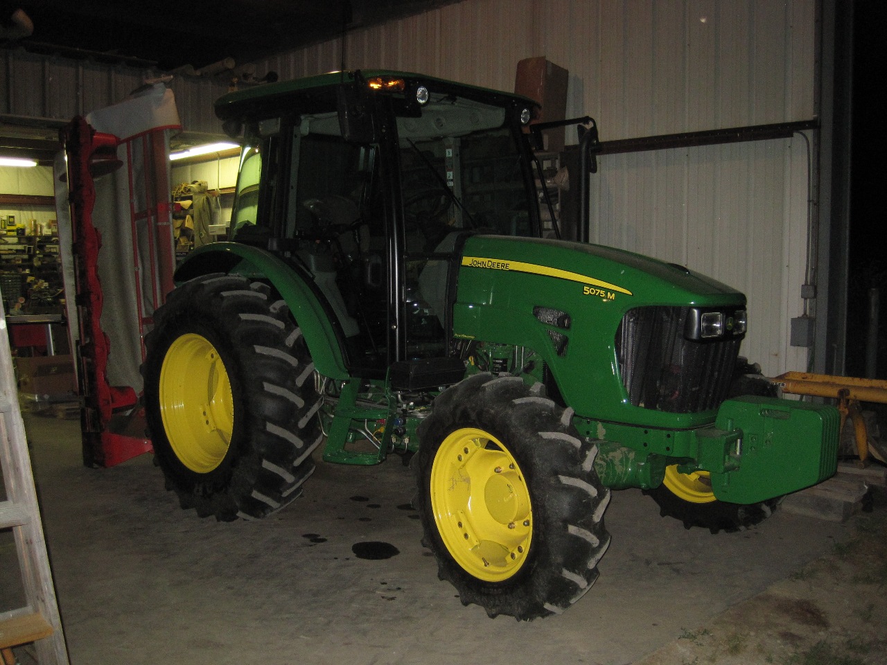

Well guys, I had some time after I parked the machines to snap some pics. Please forgive me for the quality, it was already after 9 and dark. I tried to park the 5075m near the shop so I could illuminate the rear end for a better shot. I also snapped some shots of 2 of our 6420`s to show the comparison of their standard hitch. Also, I made sure to take a few shots of the broken standard hitch arm and pieces. As of this moment, we have paid our dealer the $1100 (his cost), and will be sending Deere & Co. a registered letter to voice our dissatisfaction about the hitch failure. Hopefully they will refund us a portion of the cost. I agree Charleyfarmall, the HD hitch should have been standard. And YES, the manufacturing cost would hardly be more than the SD. I put 8 hours on the tractor today mowing pastures in all sorts of slopes and terrain....absolutely perfect function from the hitch and the mower. Its nice knowing its back there, would liked to have had it from new but...such is the way of things I guess.

Ive had a chance to operate the mower / tractor combination for several days now. I`ve been over just about every acre of ground on the farm. No problems with the hitch. The HD kit is really worth it. I would highly recommend the upgrade to anyone operating a 5M series tractor.
One thing I really like, when you use the telescopic ends during hook-up, you know they are locked in place when they "snap" back in. Way better than the Standard Duty hitch.
It would benefit Deere and their future customers if they would simply make the HD hitch the standard hitch, in its current form, no mods or alterations necessary. This is definitely the system that should have been on the tractor from first.
