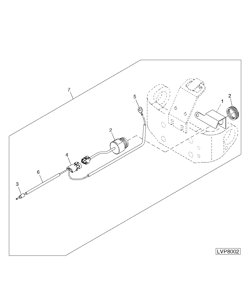

Ok, I thought the questions where over but unfortunately they're not. I looked up the back up alarm kit and there is not a switch available to purchase in the kit, so I am assuming it is already on the tractor. I found the actual instructions for my tractor and all it has is wires attaching to each other, so I guess I'm going to have to get the wire that plugs in to it. There is a ground wire coming out so I assume the other is a 12V. Here is the diagram for the kit.
1 R230565 Bracket 1
2 LVA11758 Audible Warning Alarm 1
3 ...... Elec. Connector Housing 1 REVERSE SIGNAL
4 ...... Electrical Connector Assy 1
5 ...... Elec. Connector Accessory 1 GROUND
6 RE227384 Wiring Harness 1
7 LVB25728 Field Installation Kit 1 COMPLETE GOODS
I just need help figuring out which parts would help me out. I'm thinking all I'll need is 3-6, is that what you all think. Thanks for helping me with this guys, I don't know very much about electrics in tractors and stuff.
   / John Deere 5083e Power Reverser #22
I earlier posted you need to get a copy of the install instructions for the backup alarm kit. They will tell where the connector that #3 plugs into is on your tractor. Once you find this connector hook, the power lead from your camera to it (you will need part #3 to do this) No need to buy any other JD parts, just ground the negative lead from the camera and connect video to your monitor. When you put your tractor in reverse the camera will power up.
