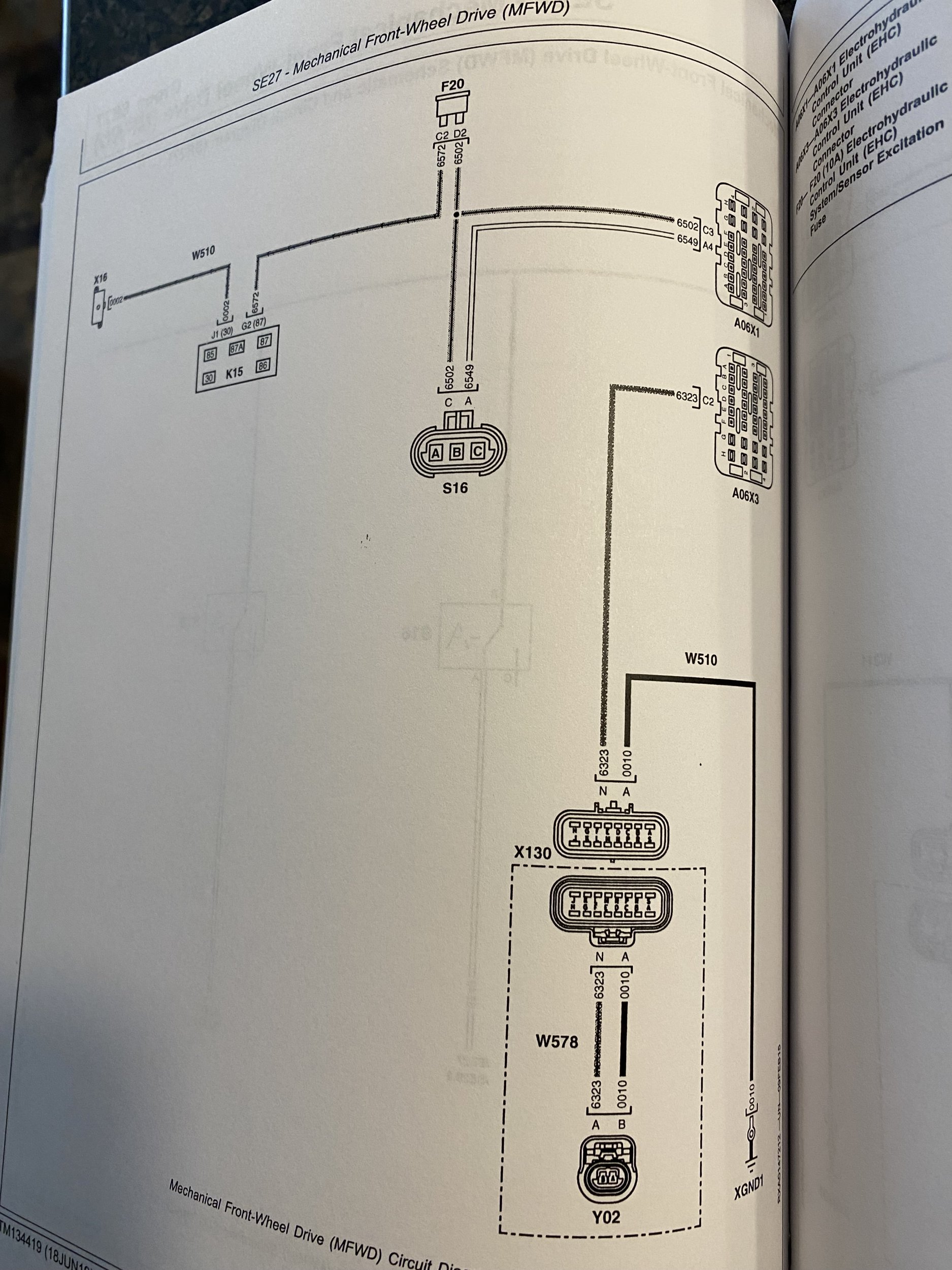

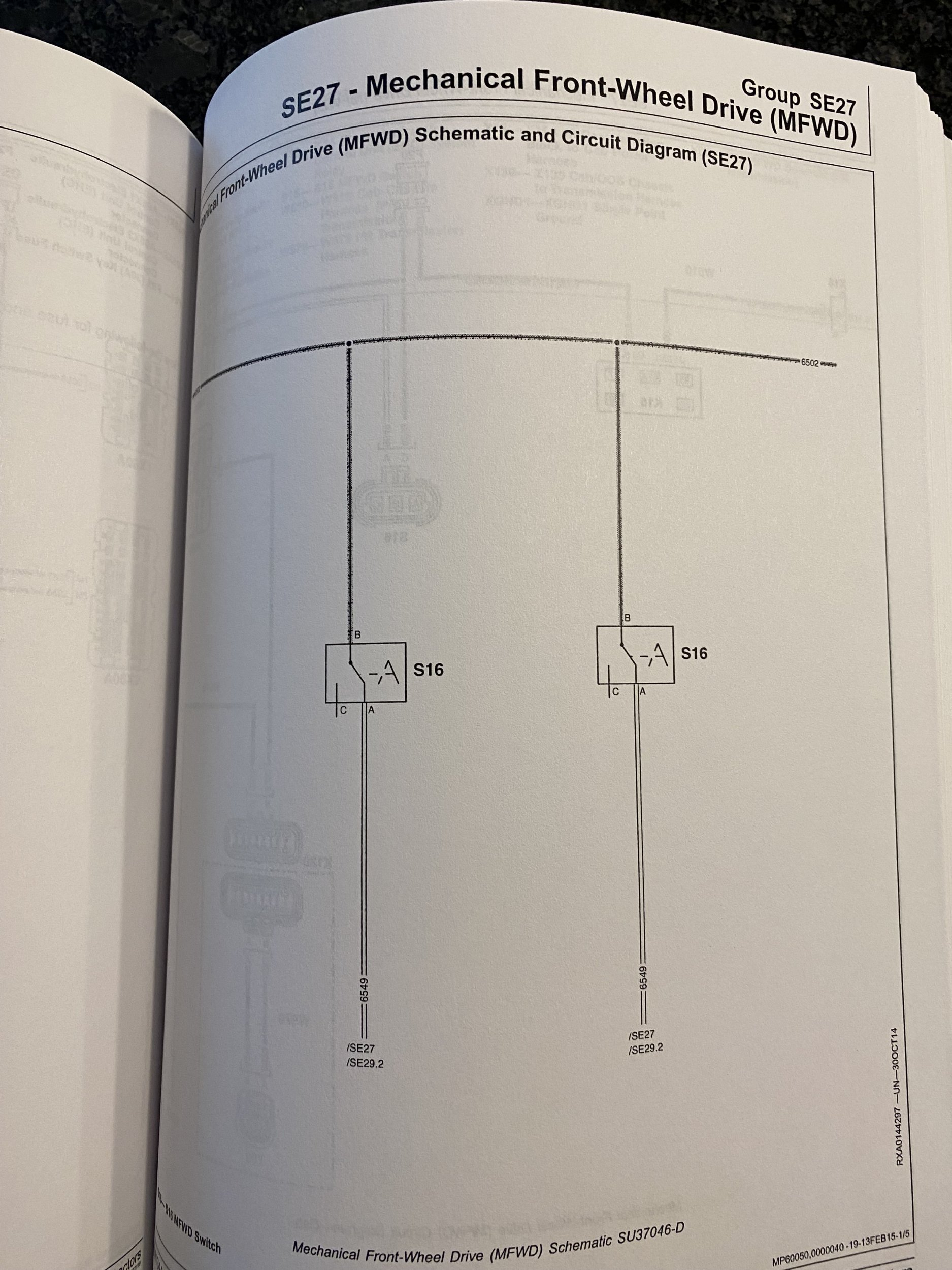

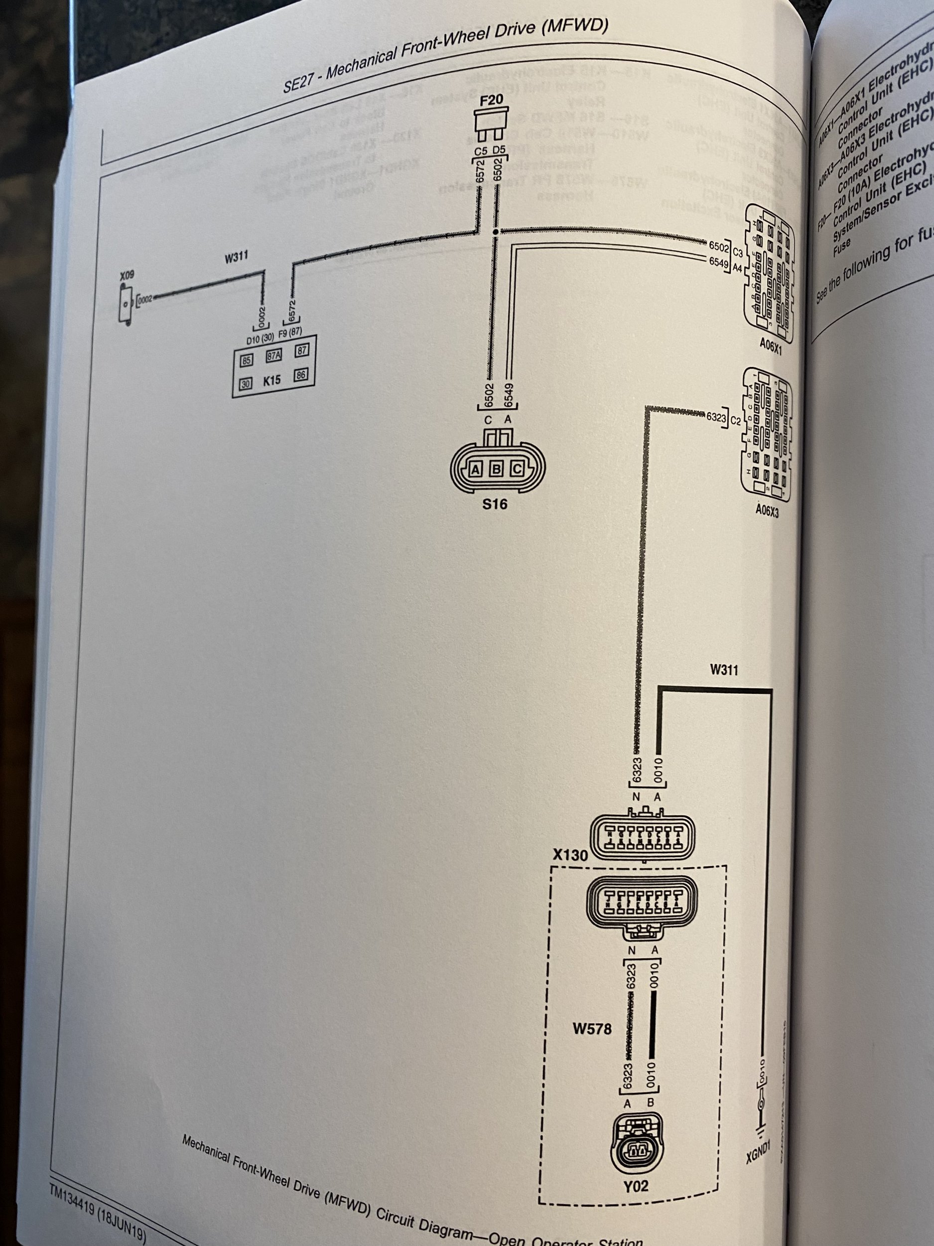

View attachment 783148View attachment 783149View attachment 783150View attachment 783151View attachment 783152
This is from a newer model 5090 or 5100. It looks like the signals are inputs into and out of the EHC unit. K15 is the relay for the EHC so that could be an issue but probably something is going on with the EHC.
Just an update. I've traced all the circuits. Switch circuit has 12v, and all wires going to the EHC were tested for continuity and then load tested. Same with the wire coming out of the EHC to the solenoid. The EHC is just not producing voltage to the solenoid. So, new EHC it is.
Thanks workinonit! Couldnt have done this without the schematic.
