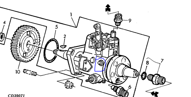

I looked up "bleeding fuel system" in the manual, and all it has is this:
1. Fuel tank must be full of fuel.
2. Loosen fuel return line (A). Loosen filter base bleed screw (B). Push priming pump (C) until fuel runs out smoothly without spitting, then tighten bleed screw (B).
3. Loosen injection pump bleed screw (D). Push priming pump (C) until fuel runs out smoothly without spitting, then tighten fuel return line (A) and bleed screw (D).
How do I bleed at other locations, and what are they? I found this discussion, but I'm not sure if it completely covers what you suggest.
Thanks!
/ John Deere 5105 engine problem #4
It's much easier to bleed air out of fuel system the fuller the tank is. Loosen bleed screw on inj. pump outlined in blue circle.then pump hand pump(parts key 3) on top of filter housing until you see air free fuel coming out of bleeder. Now attempt to crank engine. If engine won't start then one needs to bleed inj lines at injectors. CAUTION: Be careful not to get fingers close to spraying fuel as that can inject diesel under ones skin which is very bad requiring a trip to ER.

#9
Well, it didn't work. I did all the steps below and pumped hundreds and hundreds of times, but fuel never ran out of either the filter base bleed or the injection pump bleed. It would sputter occasionally, but no flow. When I tried to crank it, I got the same behavior as yesterday: eventually crank and run for 15 seconds before slowly dying.
I removed the fuel/water filter and it was about full of fuel.
I noticed a few weeks ago when going through the previous owner's receipts that he had replaced the primer pump. It sure seems like the primer pump isn't working, but could it be something else causing this?

Is fuel tank venting?? Sounds as if fuel tank outlet is plugged. I suggest to blow compressed air into fuel outlet on fuel tank. On difficult to bleed tractors I blow short bursts of compressed air into fuel tank filler neck using a shop rag the block open area of neck. This compressed air will force fuel through filter to inj pump.

It's running again! Whew.
I blew compressed air at the fuel tank opening. That got fuel flowing from the filter valve when I pushed the pump. The line was clear over to the fuel pump.
Then I blew air through the fuel pump a couple of times, and it finally fixed it. I hope whatever junk was in there somehow just disappears. :)
