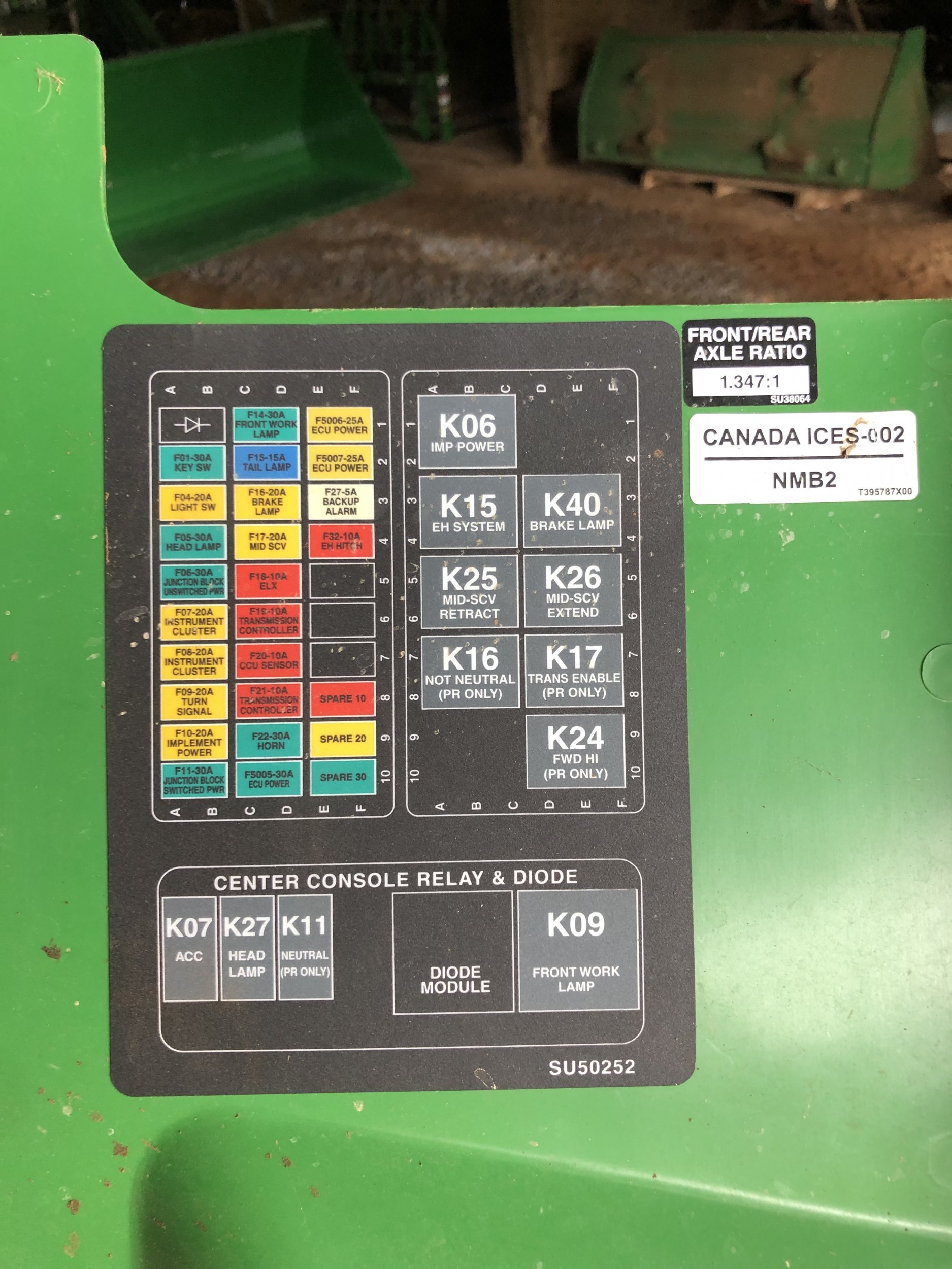

My 2020 5115M open station has a factory horn.
My 2018 has the switch & wiring harness under the hood but no horn.
I installed a factory horn & plugged it up but it doesn’t work.
I haven’t checked wiring for power yet.
My owners manual on both tractors doesn’t list a horn fuse.
   / John Deere 5115M horn fuse location # in fuse box ? #2
My 5090 has the switch as well. I'll check it and see if there is a fuse for it.
Well I was wrong : I was looking at the wrong diagram in book for my open station.
F22 is the horn fuse & it isn’t blown.
I have no power to horn with turn signal switch pushed in to blow the horn.
This is the fuse box label for an open station.
I’m not tearing into steering column to access switch : so I guess I wasted $$ on the new horn :rolleyes:
