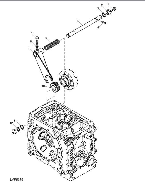

my lock on my differential will not engage or disengage when I drive the tractor and let off the gas the brakes seem to drag any ideas please any help would be great!
   / John Deere 5425 4x4 Differential problems #2
check fuse 17
   / John Deere 5425 4x4 Differential problems #3
Sorry, wrong tractor. The type of diff lock you have depends on serial #. This is a common configuration inside the diff. There are a number of different pedal configurations. Check the pedal for obstructions.
