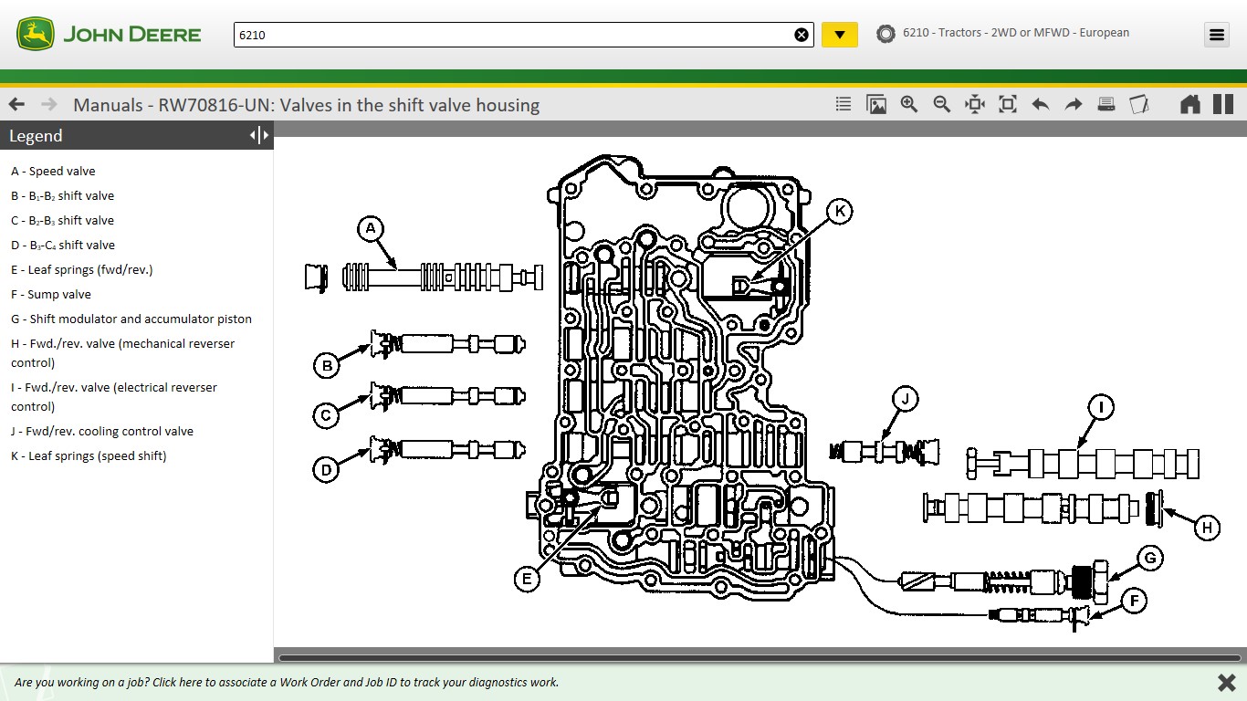

Just to close this thread if any one is reading it the problem turned out to be a spring loaded hydraulic valve which runs from front wheels to back wheels in the aluminium casting on the bottom of the gearbox this operates on a spring when tractor is not running and is forced across closing the neutral start switch(creating a circuit to enable it to start ) as soon as tractor starts and oil pressure is fed into the valve it moves across and directs oil etc to enable forwards and backwards motion it took some finding but got there in the end thanks to all replys .
   / John Deere 6210 wont crank on starter #18
Thanks for the post with the "answer".
What part did you replace (or repair) in the end to fix the problem? Do you have the part # ?
A pic of this valve in a schematic would be of interest too. Glad you found the solution.

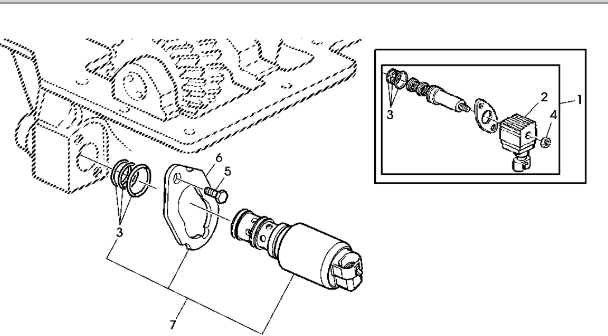

   / John Deere 6210 wont crank on starter #19
I'll guess it's one of these solenoids in the photo.

   / John Deere 6210 wont crank on starter #20
The valve in question is the one labeled "I" in the diagram. It is in the valve on bottom of transmission. It is the valve that contacts the neutral start switch when in neutral.
