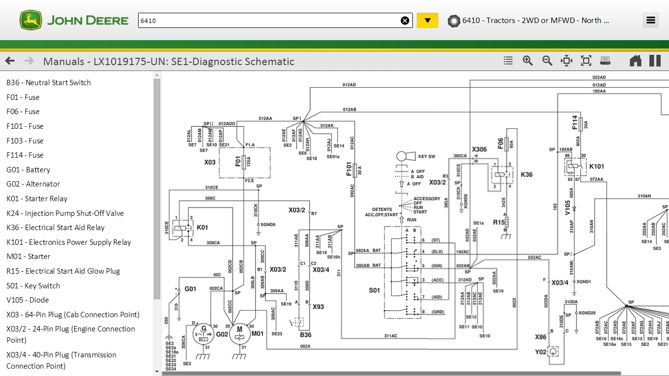

does anyone know how to access a wiring schematic for this tractor. I'm only getting 8.4 volts to the harness going to the neutral start switch.
   / John Deere 6410 tractor won't start #14
Do the lights work, normally and brightly. On our OS 6200, they work regardless of the keyswitch. That might give some indication of connection integrity at the battery. Does the fuel pump work when the key switch is turned on? Usually when you hear the fuel pump, if you press the starter seitch for the preheat, the tone of the pump changes. Just little tests I would do before going farther.
   / John Deere 6410 tractor won't start #15
Here is the starting circuit wiring. Hope you can read it. The quality is not great. What is the voltage to key switch when trying to crank?

weezy22
Have you cleaned & tightened all 4 battery cable connections??
   / John Deere 6410 tractor won't start #17
weezy22
I am with Tx Jim, sounds like a bad ground connection. Look for other grounds that the just the battery, but start there first.
