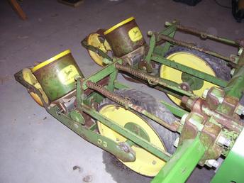

Here's a pic of the JD vegetable planter units.
The best setup would be a properly set up 71 for corn and beans and the Jd vegetable planter units for vegetables.

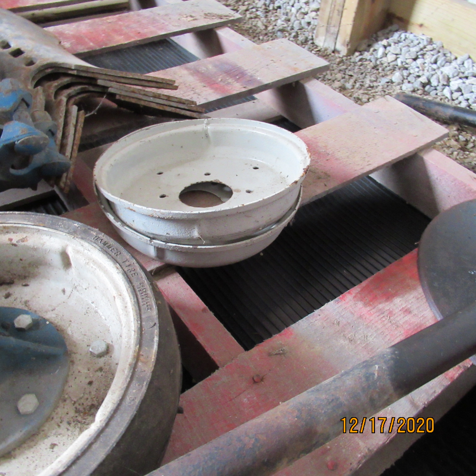

Here's the pic I said I would post of a wheel that could be used for a front packer or press wheel. I've done it before but not on a 71 planter. All are similar.
It's just an old cultivator gauge wheel. This is off a Ford but anything would work and there are lots around. Just make some brackets, make them "float" with a spring if you want and this runs in front of your gauge wheels to smooth the seedbed.
Also attached is a pic of some other gauge wheels I have that would work. Most any type of gauge wheels works. Use a bolt for your axle.
