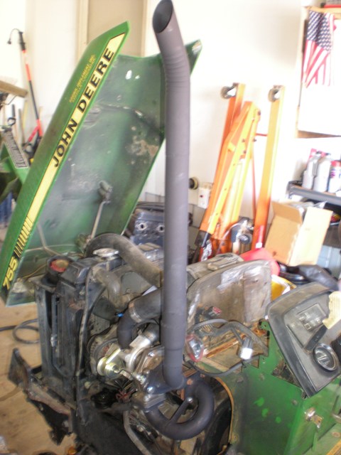

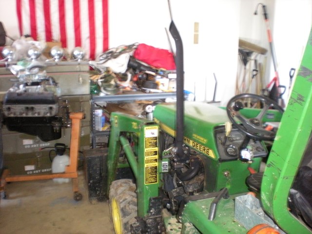

So far I put over five hours on the tractor since installing the turbo. It runs a lot better than before. When I plowed the garden, it would hold four psi in low range. It sounds like a larger piece of machinary than it is.
Did you play with the smoke screw?
   / John Deere 755 Turbo
#36
I put about one turn on the smoke screw. I don't want to go more until I put my pyro on it and a temp guage.
I will see how it does mowing in a few weeks.
