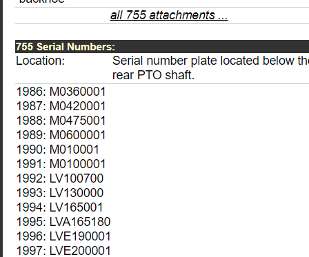

Next Question..
Where do you find VIN numbers on these tractors.
I tried google and only come up with the serial numbers.
I have a vin number on the top of the engine and the last few numbers have been ground off.

Tractors don't have a VIN, the serial number is unique enough.
The engine will have a number too, which will be different... usually due to a different manufacturer. My 4105 has a YANMAR donk, my D110 has a B&S, etc...

IMHO VIN & serial number are one in the same but I guess terminology is different down under in Australia. VIN is located below the rear pto shaft. I agree that you should acquire a JD tech manual & repair wiring

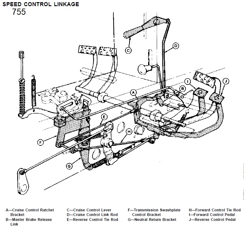

Let me catch you all up.
I ended up having the engine completely overhauled. The engine runs like a purring cat. BUT...
I'm still having issues with it when I push the peddles down it JUMPS forward or JUMPS back.. depending on which way I am going.
I was moving dirt today and i had it under a load and it would not JUMP.... it just crawls.
I know that the safety rod under the seat will cause it to do that.. but, I took a copper wire and it stays down now... the safety switch under the seat has been replaced with a new one.
Could it be the Hydraulic Pump?

Not understanding what the "safety rod" under the seat is that you refer to, but see in the service tech manual that there is forward reverse speed control linkage that may need some fine tuning. But do not really know that, as hard to decipher just what the JUMPS are.. sudden jerking is what it sounds like to me.
Did this happen before the engine overhaul? What is the history of the transmission oil, filter, and screen changes?
Here is a 3d of the speed control linkage that is under the center between the foot rests. Hope this helps some.

Jumping / Jerking.. either way it JERKS / JUMPS forward or JERKS / JUMPS back.. depending on which pedal I push. The linkage is what I am thinking.
It was happening before the overhaul and it continued after the overhaul.
