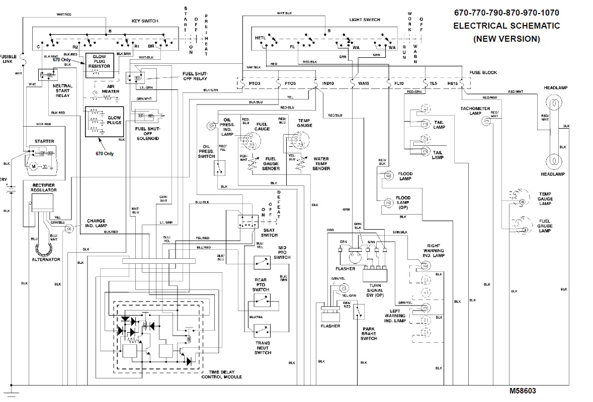

My 790 (1998?) was acting like the battery was going bad, as in slowly cranking. Still ran fine. Yesterday turned over once, sounded as if battery died. Replaced the battery, Cleaned the terminals. The brake, oil and water lights came on. Turned key to start, engine did not crank. Checked all interlocks, all seemed to be closed. Sat overnight, I went out this morning, brake water and oil lights, came on. no crank, lights out again. These indicator lights are not on with key switch on. Using multi meter, checked the back of the key switch. Supply wire, white and red reads 12V. turned key on, nothing indicated on the other poles, and supply voltage went to zero. Disconnected the 4 wire out plug. All voltages checked out, including starter.(when key turned). I thing my question is would the Time Delay Control Module be the culprit? Is there a capacitor in there? The oil, water, and parking brake lights not coming on disturbs me. I hope the schematic I am working from is correct, any assist would be appreciated.

Your JD790 is really a Yanmar F or FX series machine in JD green paint. ;)
Maybe a TDCM issue, maybe a VR (voltage regulator) issue. My bet is on the VR. The VR issue is typical with the Yanmars. Today, there are newer solid state VRs available that are very reliable over the 30+ year OE ones back in that day.
It's on the far left middle area of the schematic. That's where the key input, alternator and battery all come together too. You did say the starting was getting slower and the battery had to be replaced.

Would the voltage regulator allow a small enough charge to build, say, in a hour? This is what throws me as, if I let it sit an hour or so, turn the key, the Oil,Water, parking brake lights and fuel gauge work. (Dimly) Almost as if a capacitor is trying to charge. Then when I turn it to start, it kills it all. Thank you for your reply.

As it's solidstate, I would say yes, there are caps and diodes in the VR.
Also I take it you had ruled out the Neutral foot pedal safety switch? Just run a jumper wire to by-pass and test or take both connections off the switch and stick together. Then try starting.

Your symptoms sound like a poor connection at one of the battery cable ends,,
There are four connections, two at the battery, two at the tractor.
Sometimes there is another cable between the frame and the engine,, so there could be two more.
A little corrosion, or a loose bolt, you get exactly the symptoms you mention.
The best approach is to get a GREAT set of jumper cables, and bypass each tractor cable.
When the tractor starts correctly, you will know where to look.
There is no "capacitor" charging and discharging that is giving you voltage.
