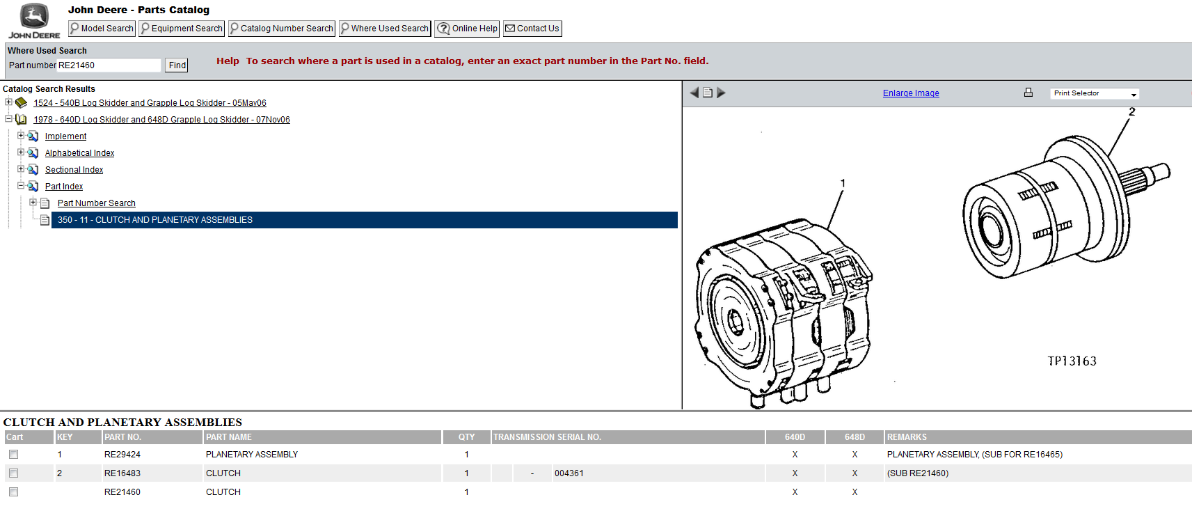

Thanks Tx Jim! I wonder if complete clutch packs would cross? C1-C2?
/ John Deere 8 speed powershift #11
The part numbers for the 2 assemblies do not appear in any agricultural tractor parts catalog. The parts appear only in the 2 models listed in photo below.
HTH's,Jim
