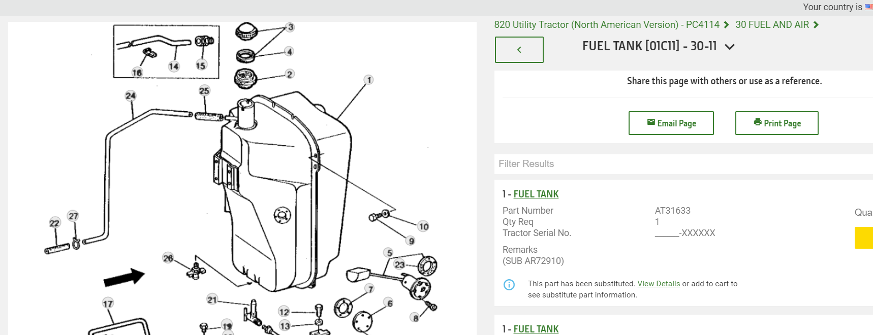

I sold & performed PDI on New JD 820 utility tractors & was employed at JD dealer from '66-'87. I'm 99% positive 820 came from Germany with a metal tank. I don't remember any JD tractors built before '87 with anything but metal fuel tank. IMHO the fuel tank schematic photo resembles metal but I realize there are some dependencies in parts catalogs. I attempted to check fuel tank spec's but failed to locate any on JD's site.
In reference to difference in HP according to Tractordata utility 820 was rated at 2100 rpm's while 1020 was rated at 2500 rpm's which is reason for difference in advertised HP.

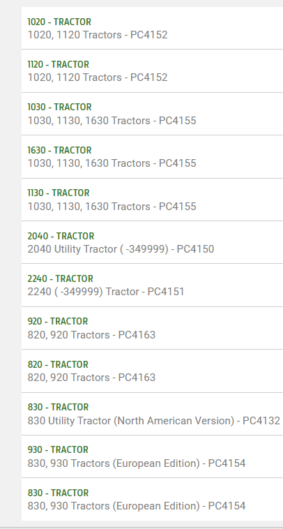

Part# search on JD parts shows 12 models that the same fuel tank fits. Earliest serial # break had a different part#(AT31633) that subs to AR72910
