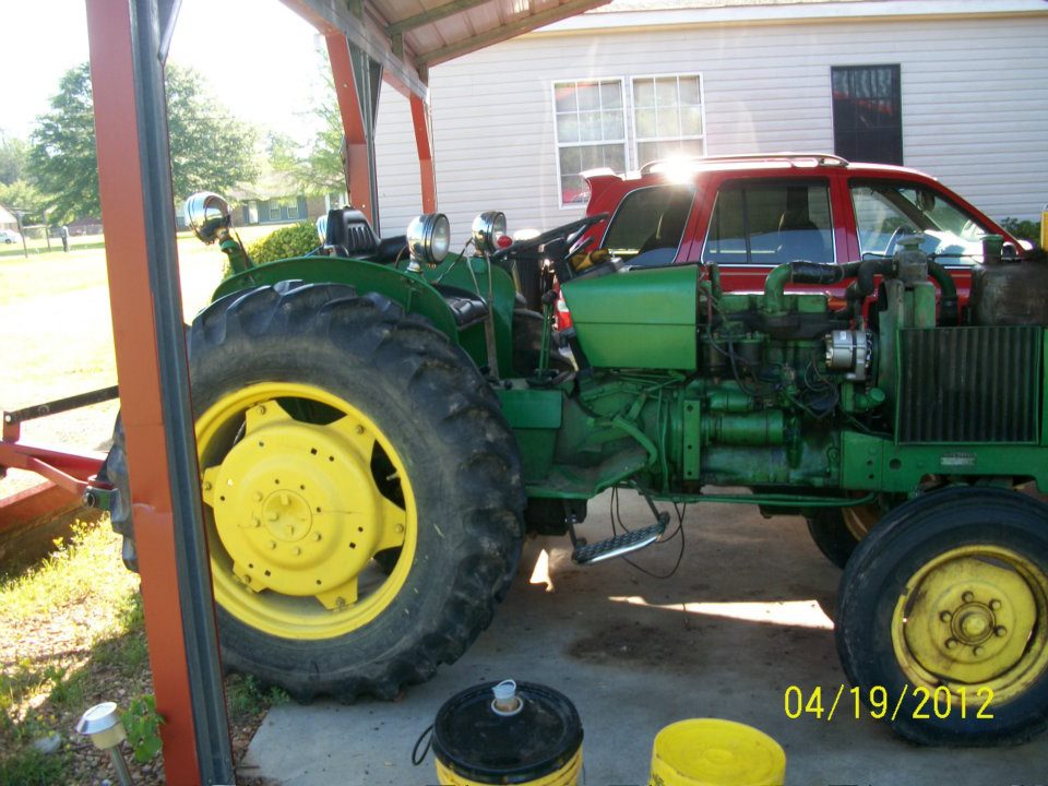

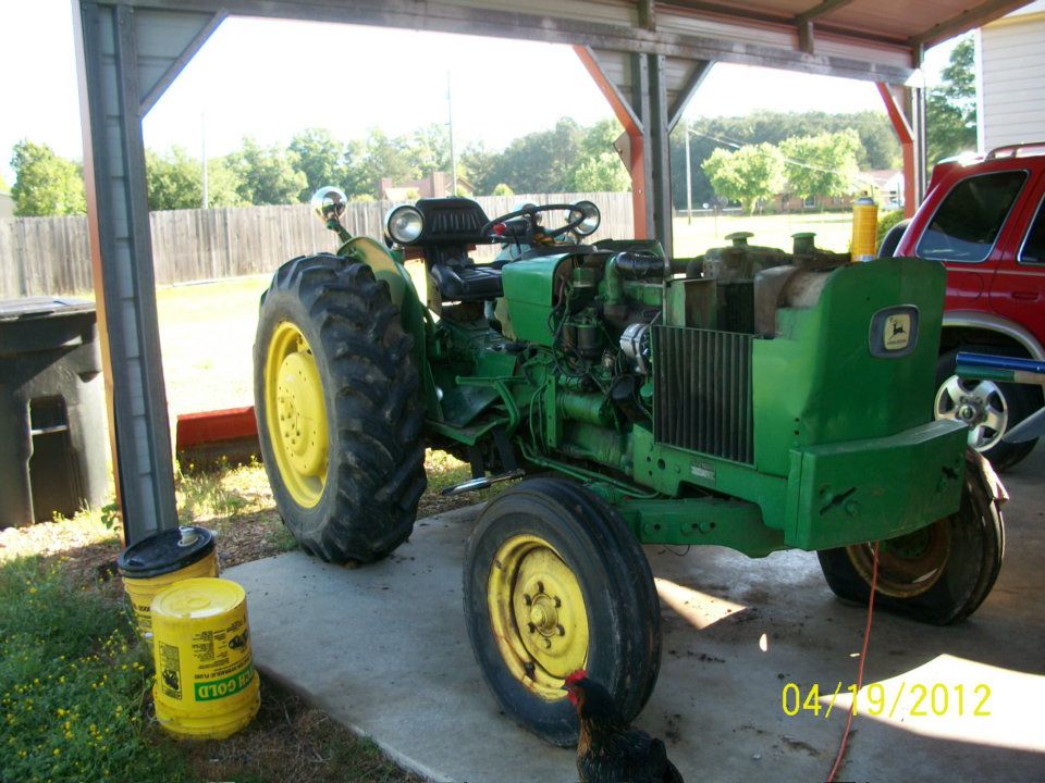

here's some pics of my 820 trying to get going. 562428_136322643164847_100003613374313_146350_390968270_n.jpg

Make sure the post you put the hot wire on is not shorted to ground. On mine the inside terminal is the post that takes the hot wire and the outside terminal is connected to ground with the short lead wire. Do you have this short lead wire too? Use an ohm meter to measure the resistance between the inside terminal and ground. I would also recommend you add a cheap inline fuse with a 1 or 2 amp fast blow fuse to the hot lead as a precaution before attempting to switch the leads.
I would bleed all the air and any residual dirty fuel between the filters and pump first using the manual pump on the engine. If it doesn't start after this I would then bleed the top lines to the injectors.
Your not far from the injector shop I use and have used years ago. This shop is located in Olive Branch Ms just below the state line. This would be my go to shop to rework pumps and test injectors.
Ag Fuel Injection Pumps : American Diesel Service, Power Stroke Duramax Cummins Diesel Parts, Pumps, Injectors, & Gaskets
Let me know how this works out for you, close up pics of the injector pump would help alot too.

ty for the come back.ok to wire goes back to the neg side of fuse box .when i turn the key on its hot,this way if something is wrong it would blow the fuse at the box.I just checked I know fuel is coming out of pump cause fuel is leaking at the bolts to the lines to the injectors i took off all line and cleaned them out.will bleed today at the injectors and cross my fingers.thanks againto both of you.Duke and jenkins

Thanks, that was my concern and point too. The standard fuse block in an 820 doesn't have negative terminals. Interestingly my boat though has positive and negative fuse blocks with buss and fuses for both positive and negative leads. When dealing with a tractor this old it may have been rewired so I was wondering about the possibilities and seeking clarification.
I also noticed that the picture was added of veto56's injector pump and there wasn't a jumper wire on the ground terminal of the solenoid. I assume the insulating washer has been removed to provide continuity between this post and the injector case.
