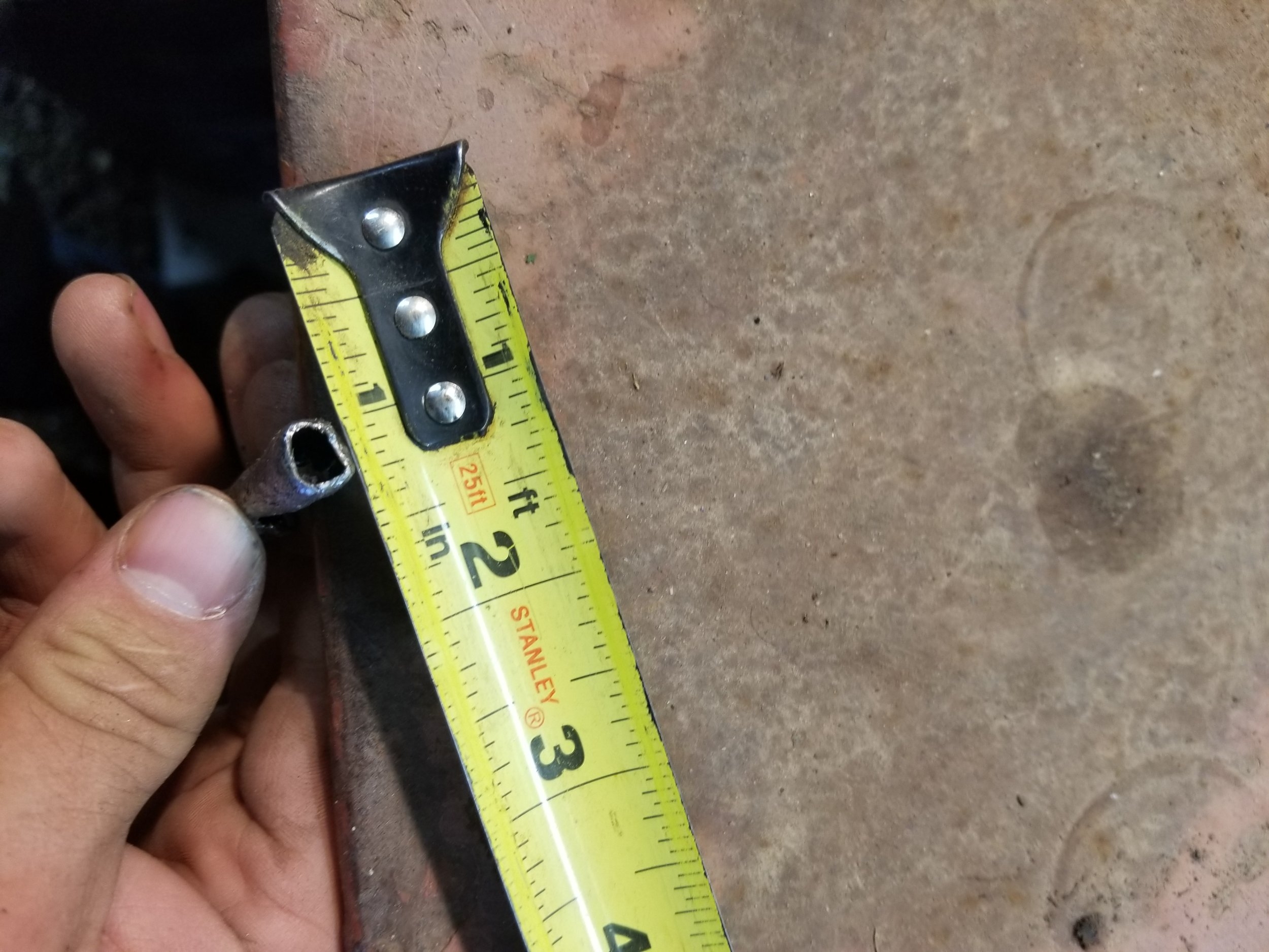

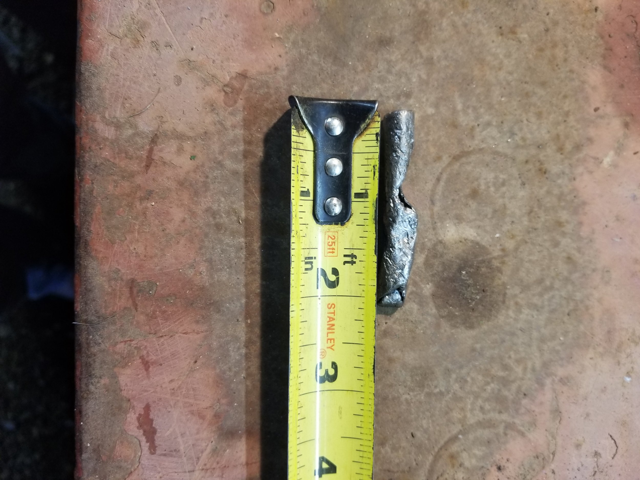

the other day raking with a john deere 820 the right shifter wouldnt shift into park or II so i pulled the top of the trans off and found a 2 inch long by maybe 1/4 inch diameter tube laying in the shift fork which was keeping the shift lever from being able to shift. Does any body have any idea what that could be?? The trans shifts fine now but that piece of tube came from somewhere.

820 with 2 cyl only park function was locking both turning brakes. It would be interesting to see photo of tube Banditman removed from shifter rail tab.

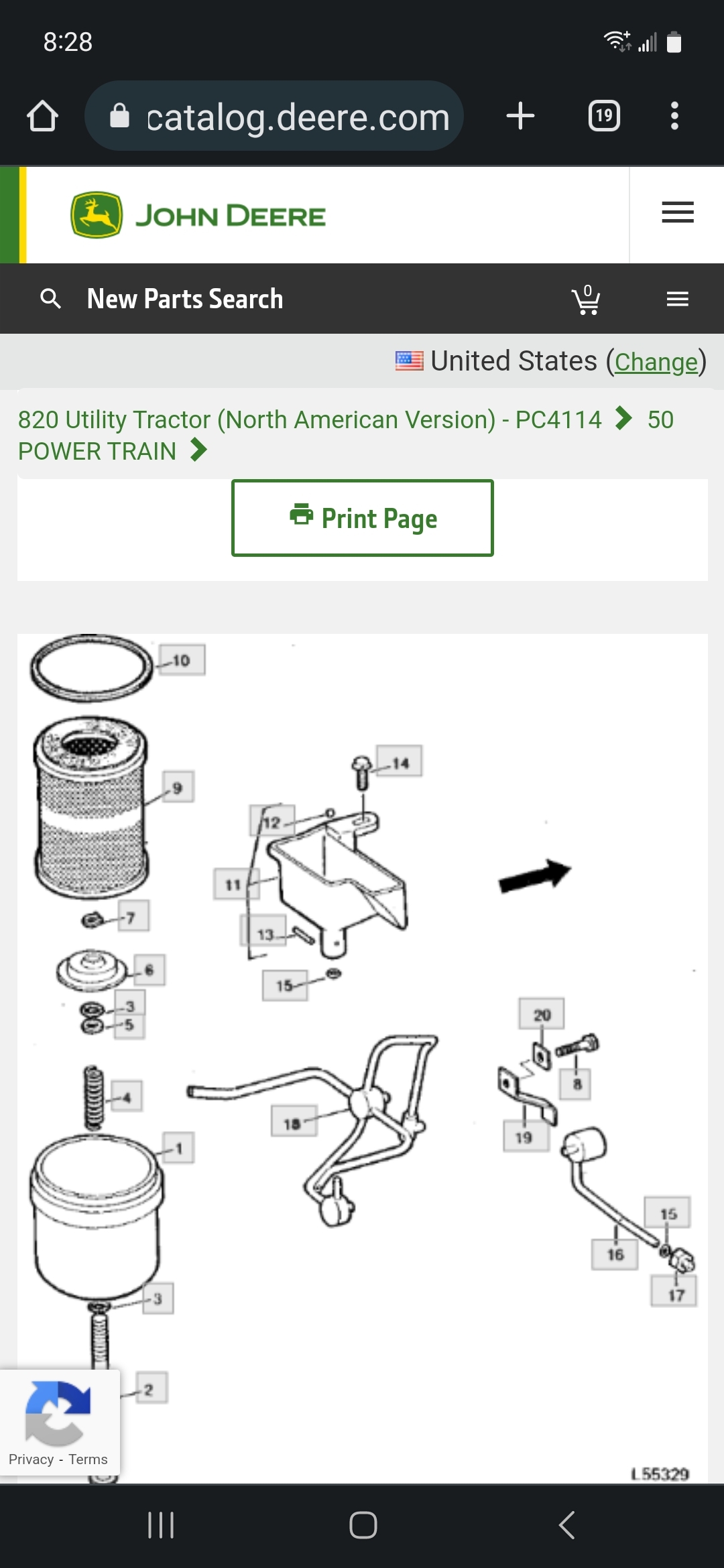

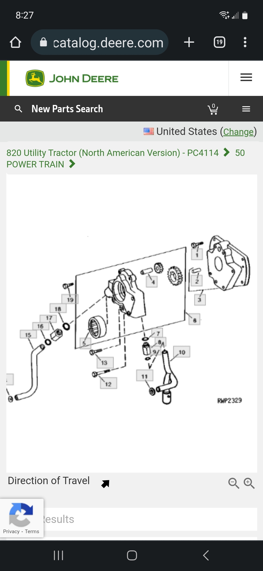

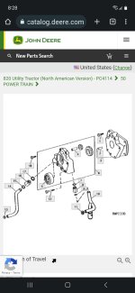

The 3 cylinder 820, 1968-73 model we can presume?
Most likely part of a transmission lube line.

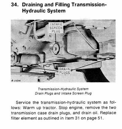

Poor trans shifting & hyd's on a '73 JD 820 have no affect on each other. How many hrs of use since hyd filter was changed & hyd oil suction screen che3cked/cleaned?
The screenshot doesn't mention cleaning the suction screen. That's normally done every other oil change.
i did it before i started haying probably 20 hrs on the filter and cleaned screen

I tend to disagree on that. I think it's more often done when hydraulic problems occur and nothing else seems to help.
And I disagree. If we wait for symptoms before cleaning screens, the cavitation damage to the hydraulic pump rotor has already started. It's called micro-pitting and will wear the rotor out prematurely.
The jerking and jumping of the 3pt hitch are classic signs of suction oil starvation. First thing to do is check the oil, change the spin on filter, and clean the screen. 3pts operation is normally very smooth.

I was wondering if original poster could get a picture of the pipe found in shifter. Might help to identify it. If there is internal leakage due to misplaced or broken pipe, it would help explain the jerky hitch.
