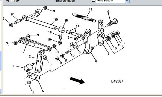

Well I didn't do something right. When I put rockshaft cover back on and started the tractor the PTO works great but the lift won't work. It comes up but won't go down. I took the cover back off but I can't see what I did wrong.
   / John Deere 820 #53
There is a bolt with a small tab in the center of the rock shaft cover that you can access beneath the seat, This is the rate of drop control and it works independently of the rockshaft control lever. If you screwed this in tight it will still allow the arms to go up but will not let them go down. You use this adjustment to control how fast the implement is allowed to drop. Adjust it so that it akes about 2 seconds to fall from fully up to the ground. You adjust this for various implement weights, keeps from damaging the implements. Turn this counter clockwise to open the valve.
This would be pictured as #9,

I tried moving that but it did not change anything. What does number 7 do and does it attach to anything?
   / John Deere 820 #55
#7 controls the pressure and return valve in RS piston housing.

I figured out my problem. I did not have any weight on the arms to pull the lift down. Everything is working now. Thanks to everyone who helped.
