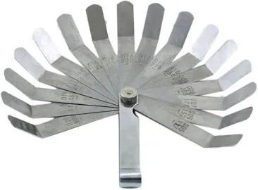

Got it, I will give both of those things a try. One more question: If the valves are out of adjustment, is the thinking that it would be creating too much compression, which is therefore slowing down the starting speed?
Adjusting valves tightens up slop in your valvetrain (a small amount is needed for normal functioning/thermal cycling -adjust to spec). That normal wear and tear slop accumulation effectively decreases the duration of your camshaft which means that your valves open later and close earlier which restricts the ability of your engine to breathe. Adjusting the valves brings it back up to near factory spec.
I don't think it has any measurable effect on compression unless maybe if it's grossly off spec, but it does have the effect of easier starting, theoretically improved efficiency, and less slop means less clatter

Get a professional to adjust the valves. Easy job to do….if you’re experienced. Probably less than an hour if you do some prep work for him like removing the valve cover…
If you understand how to find TDC for each piston maybe you could attempt it yourself.
ps. 900 some hours on a 35 year old tractor could also mean lotsa stale fuel and varnish residue. Work the dang thing with a bush hog or tiller for a few hours and clean the carbon out of it. Oh, and probably has summer diesel in it? 🥴
   / John Deere 855/856 hard starting #23
You don't have to find tdc. For each cylinder, rotate the engine by hand until one valve is fully open, then adjust the other (fully closed) valve on the same cylinder. Repeat until you get all your valves adjusted.
Once you have the valve cover off, going through the 6 valves is a 30minute max process even for someone who has never done it before, half that if experienced
Lots of YouTube videos on the process. Pretty much the same process for all pushrod solid lifter engines diesel or gas

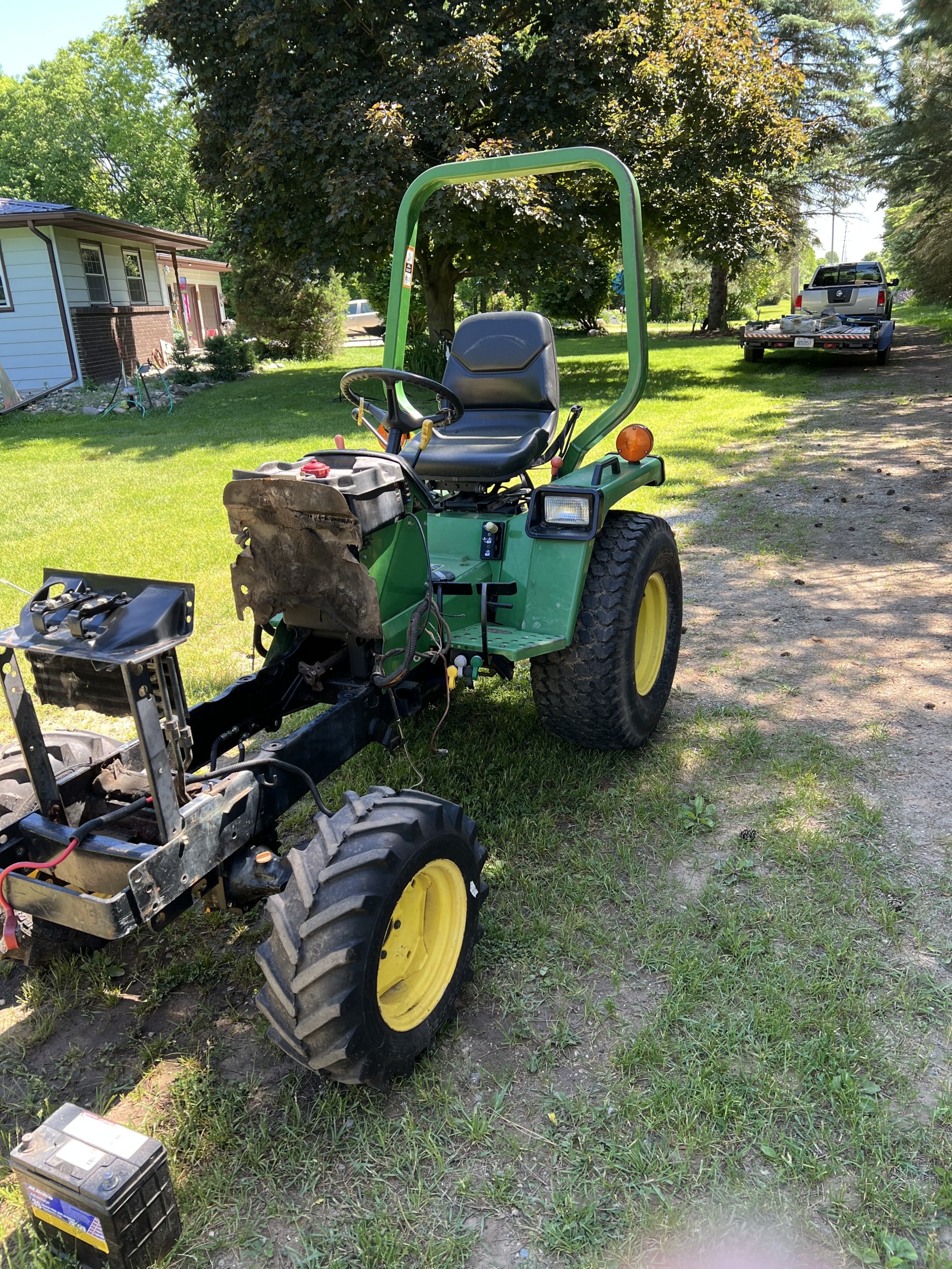

You’ll have a hard time finding parts for that particular Yanmar believe me I know John Deere dealer is no help at all that model engine is obsolete according to them.Mine blew up a year ago and I was about ready to part it out when I finally found a replacement engine that costed me plenty

Careful with those valves!
IF....you.get it wrong, it could cause damage.
Contrary to what I have read here, valves typically don't always get "loose" but, instead, get "tight" when they wear. Meaning that the clearance between rocker arm and valve stem end is less...not more.
This is because the valve "head" tends to work it's way down into the valve "seat" in the head.
While I certainly agree with having them adjusted, just make DANG sure they're done correctly. Sometimes that actually means that you do it yourself since there are so many HACKS out there calling themselves mechanics.
I also agree with the one guy talking about doing a compression test. But that's usually not in the realm of most DIYER's.
At any rate, you would do a compression test AFTER adjusting the valves.
