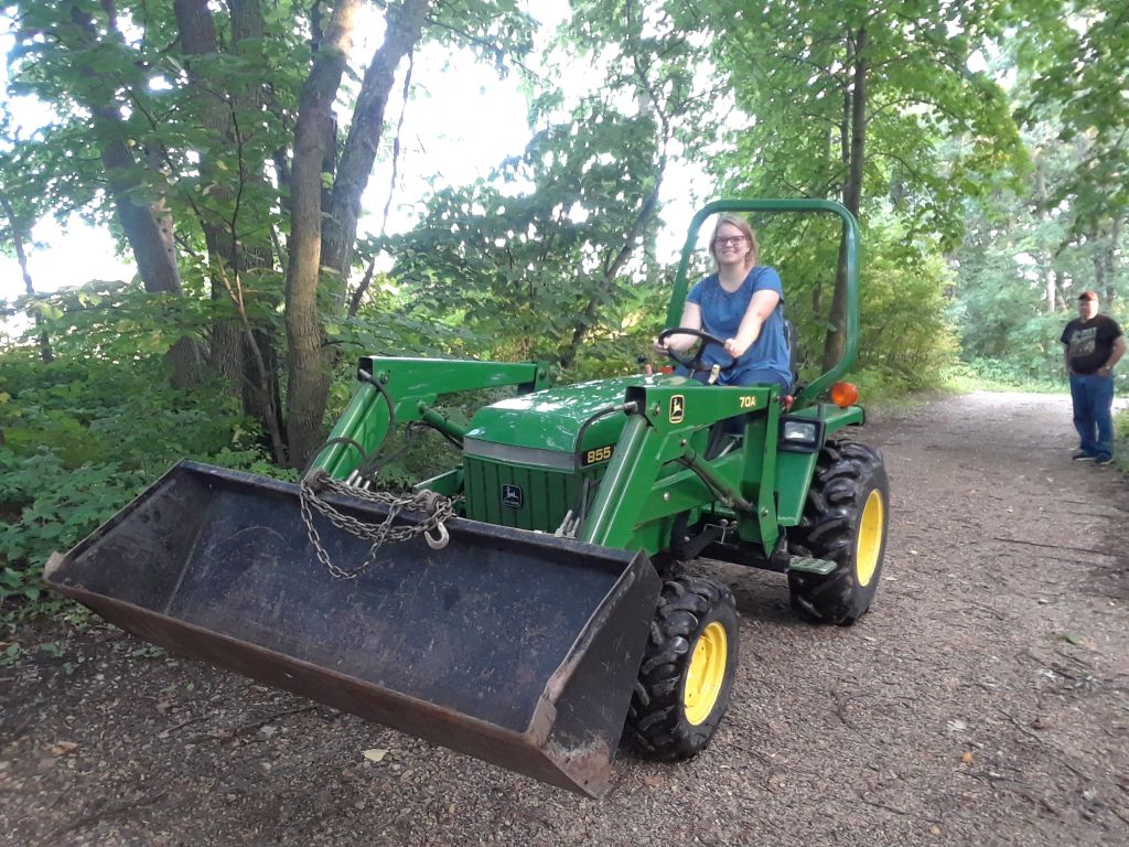

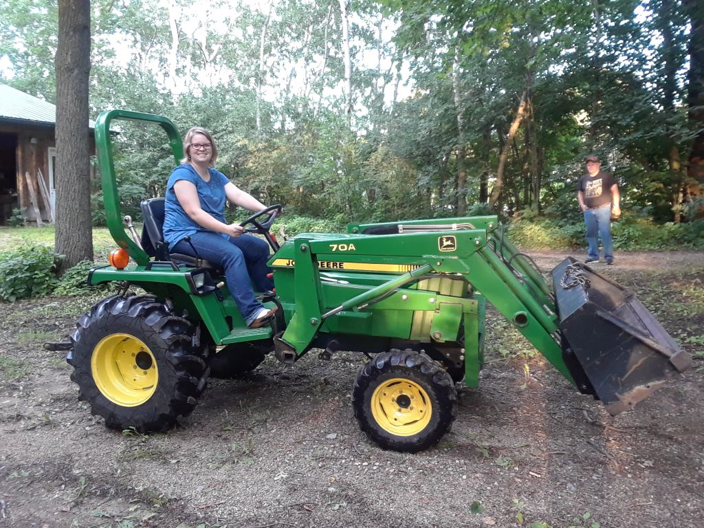

I suppose I should add a couple photos to prove this transaction actually occurred. I've added one hour to clock moving some rocks and dirt as well as giving my little daughter a ride. This thing is the ideal size for my small property!
My wife seems to be pleased with it, too. Though I'm sure she's happy that I am happy.
P.S. That's my father-in-law in the background, and even he approves!
