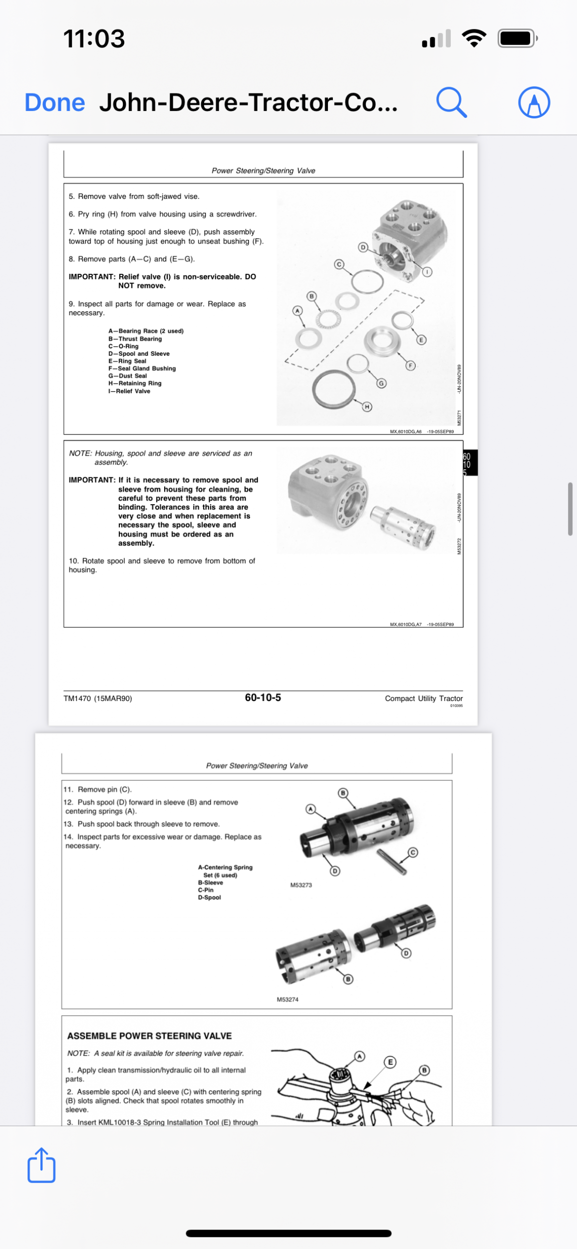

Ok I have confirmed there is power steering and the sound is coming from the housing where power steering hydraulic lines originate. I ran the tractor yesterday for about 3 hours and never made a peep. But this morning started it up and it hummed a little bit but stopped.

I believe the source of sound is in this valve somewhere should I pro actively disassemble and inspect if so what should I look for. Or where it is intermittent do I wait for the problem to get worse so I can more easily diagnose.

It will get worse, to the point you have no steering. A parts manual would be ideal to reference for the diagrams where it's on the machine. Typical Yanmar arrangement is near the bottom of the steering column.
